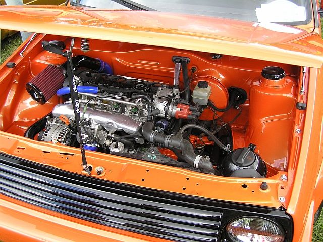

RS VR6 0 Posted January 28, 2007 The FSI in the orange car just ran the motor. Its still on the Digi 1 engine management. In the pic you can still see the dizzy on the motor. The whole point of the "FSI" is the engine management and fuel delivery system. Quote Share this post Link to post Share on other sites
Rob_B 0 Posted January 28, 2007 i love the orange mk2 with the TFSI engine in from foreign shores Quote Share this post Link to post Share on other sites
saysomestuff 0 Posted January 28, 2007 sorry, I'm going a bit off topic but - Wow - I've not seen it with the engine cover off, I'm amazed that PVW felt the need to omit that it wasn't running FSI at all :roll:, the way they totally ignore the technical aspect of features really winds me up Quote Share this post Link to post Share on other sites
