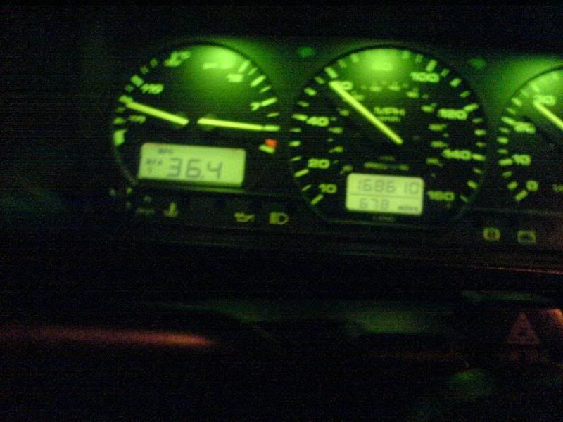

Bally 0 Posted February 5, 2007 My 1.8 valver with spaceship mileage not to bad on fuel... pic from last year.. Quote Share this post Link to post Share on other sites
