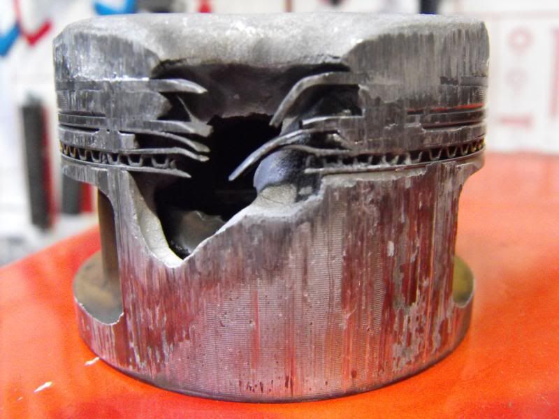

dirtytorque 0 Posted June 15, 2008 CorradoVR6-n.o.s said: dont know mate,the ammount of oil its spat into the inlet manifold and exhaust is quite allot,i suspect i ran lean and there will be signs of it when i pull the engine appart,then if thats the case then i will uprate my pump. but will post up pics at each stage bud :tongue: I can always feel it when I run lean.. Car drags,i.e it feels like someone has attached a caravan to the car.I can see it on my afr guage too though. Its happening to me intermittently when i snap the throttle shut under heavy load. I have to fix that area of my map. What management is it running? Sorry too lazy to read through your thread to find out. :roll: :wink: Share this post Link to post Share on other sites

CrazyDave 0 Posted June 16, 2008 CorradoVR6-n.o.s said: my AR gauge was normal at the time,but i did have a full throttle issue that i was still sorting out :roll: and im still using stock managment and a little crazydave filter,but this is my weak point,think its about time to get standalone.. :grin: It was just a quick fix for 8psi to 'get you going' but the proper filter still ain't done. Mmm, did wonder how the standard MAF and mapping would cope with 12psi. But I guess 12psi on a 140k engine isn't a very nice thing to do....poor VR :) Think you just wanted a new engine anyway eh James? My main reason for sticking at 8psi is the knock on effect of everything else above that level. Guess you'll be heading for more than 12psi when you get it all back together with a standalone? Share this post Link to post Share on other sites

dirtytorque 0 Posted June 16, 2008 :D cool pics. Destruction. :twisted: I wonder how much timing was dialed in at the time. Have you ever used det cans on this car ? Share this post Link to post Share on other sites
nemesis360 0 Posted June 16, 2008 :eek: Ouch I think an uprated fuel pump will be on the shopping list Share this post Link to post Share on other sites
StormchargedVR6 0 Posted June 16, 2008 James you don't hang around. Luv reading your engine builds :grin: Though you said standard fuel pump man enough for the job :nuts: Im not taking any chances, got a sytec in tank and bosch inline with SX reg :grin: Share this post Link to post Share on other sites
CrazyDave 0 Posted June 17, 2008 M m m m meltdown! :shock: :shock: I never managed to get 440cc injectors to work properly,the ecu kept throwing a fault code and would then run on TPS / engine speed and really really rich at idle (or limp mode). I reckon 9-10 psi would be OK with the 360's but any more and you'll need standalone or maybe a C2 map? The standard mapping has way to much timing for anything above that level and you hit the knock sensor max retard limit, then exhibit A (see above). Don't know anybody who runs C2 code yet though. Great pics though James, if a little costly to produce.... Share this post Link to post Share on other sites
Kevin Bacon 5 Posted June 17, 2008 CrazyDave said: The standard mapping has way to much timing for anything above that level and you hit the knock sensor max retard limit, Yep, as we saw at the rolling road day with Rob's 8 psi Rotrex. Considering his low boost and 9:1 compression, Motronic was still taking 17 degrees timing off! At full whack and wide open throttle, Motronic runs 36 deg timing. Turbos usually hit peak torque with around 20 deg timing. CrazyDave said: then exhibit A (see above). Quite. Entirely predictable and entirely avoidable. CrazyDave said: Don't know anybody who runs C2 code yet though. I am :) Share this post Link to post Share on other sites

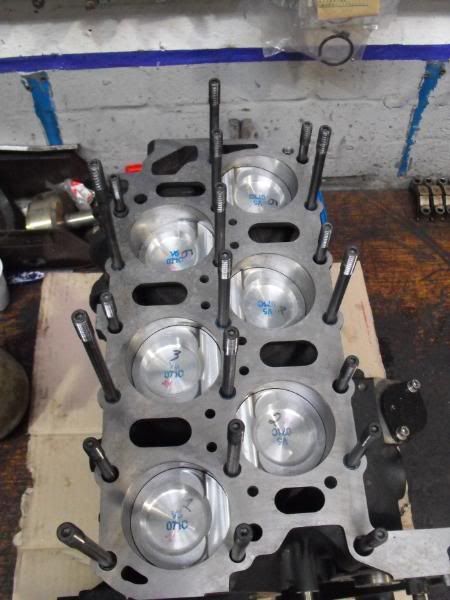

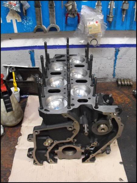

CorradoVR6-Turbo 0 Posted June 17, 2008 Hmm, if only i had loads of cash to splash out all at once then this might not ever have happend? :? but as mentioned before,the engine had 160k on the clock and it held up well for the old girl and i was rebuilding a new engine to put in so i was pushing it and was not concerned about the outcome.Once the new engine was in and ran in then i would have sorted a megasquirt out or something,still no budget for dta,but i want to learn about mapping ect so this will be a good starting point so anyway to entertain you lot with more pics of the rebuild,a brand new in the crate block and pistons,its 2.8 but that 1mm oversize wont make a dent. Share this post Link to post Share on other sites
