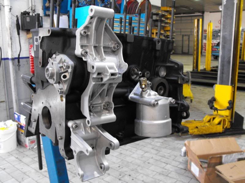

MK1Campaign 0 Posted June 26, 2008 What did you clean the box with? Looks really good. Share this post Link to post Share on other sites
CorradoVR6-Turbo 0 Posted June 26, 2008 Cheers mate i shot blast the box,im still suffering the result with the grit still in my eyes!!!!!! :cuckoo: looks good though...not that i can see it :lol: Share this post Link to post Share on other sites

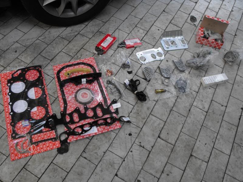

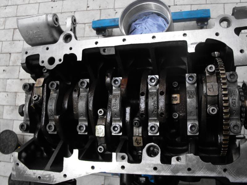

CorradoVR6-Turbo 0 Posted June 30, 2008 Cheers Grif cant wait,but wait no more,parts arrived but mising thrust washers :bad-words: but never mind,will get them from VW,checked the tolerances on my 160k crank and they are like new well chuffed ! :D Got loads of bits sandblasted,so im going to paint the steal bits and leave the alloy as is,also got some stainless bolts so it all looks nice and clean. Some randoms Later... :wave: Share this post Link to post Share on other sites

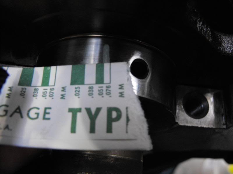

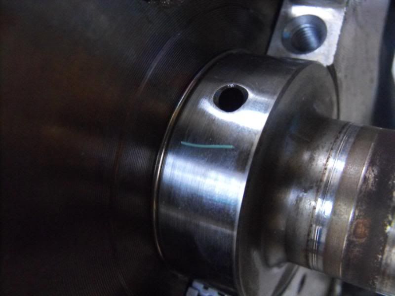

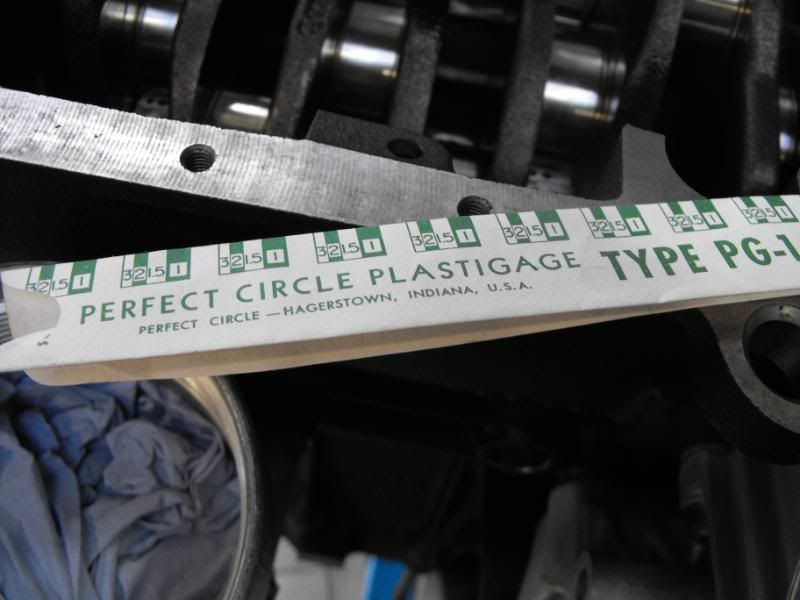

boost monkey 0 Posted June 30, 2008 James, looks amazing buddy! Can you explain what you are doing with the plastigage? Are you putting some goop on the crank which then spreads itself out and you measure how far it spreads? :scratch: Ta, Jon. Share this post Link to post Share on other sites

CorradoVR6-Turbo 0 Posted June 30, 2008 boost monkey said: James, looks amazing buddy! Can you explain what you are doing with the plastigage? Are you putting some goop on the crank which then spreads itself out and you measure how far it spreads? :scratch: Ta, Jon. You hit the nail on the head bud,it measures the gap between the shell and crank that inturn gives you the shell size you need. Share this post Link to post Share on other sites

CorradoVR6-Turbo 0 Posted June 30, 2008 its not just VR6 mate its any motor :D Share this post Link to post Share on other sites
boost monkey 0 Posted June 30, 2008 Yeah true, I should prob get some plastigages for when I do my KR, but I meant the thread is a fascinating read! Love project threads :clap: Share this post Link to post Share on other sites
boost monkey 0 Posted June 30, 2008 So wait, you put the old shells back on the crank, and the annular distance makes the "goop" spread and you measure that on the gage to find the size of the closest-fitting new bearings? Share this post Link to post Share on other sites

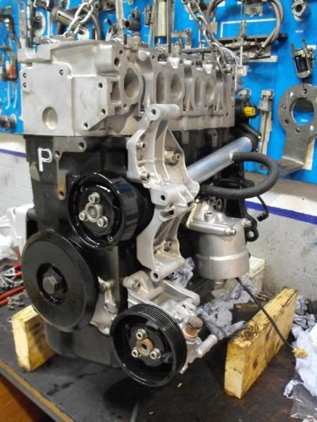

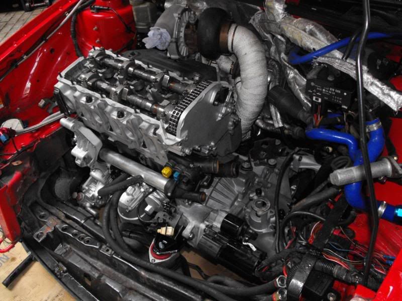

CorradoVR6-Turbo 0 Posted July 5, 2008 Cheers Griff,looks better and better now that it is coming together :tongue: got more done today and engine back in,just waiting on my inlet manifold to come back from powder coating then its time to start up! :grin: More randoms... Back at home! :luvlove: Share this post Link to post Share on other sites
