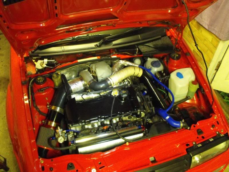

CorradoVR6-Turbo 0 Posted July 9, 2008 some randoms,loving how tidy and clean the bay is now,just need to get the rest of the outside of the car looking the same! :tongue: Share this post Link to post Share on other sites
Toad 0 Posted July 9, 2008 CorradoVR6-n.o.s said: Love how big the turbot looks in that picture. :) Share this post Link to post Share on other sites
nemesis360 0 Posted July 9, 2008 Looks top notch James, are you planning on going to any shows this year? Id like to have a good look round your setup. Share this post Link to post Share on other sites
CorradoVR6-Turbo 0 Posted July 9, 2008 Cheers Toad,it looks bigger off the car :lol: nemesis360 said: Looks top notch James, are you planning on going to any shows this year? Id like to have a good look round your setup. Cheers Mate,the only show i go to is Harewood house in leads its the closest up Norf :tongue: Share this post Link to post Share on other sites
herisites 0 Posted July 9, 2008 :notworthy: :notworthy: :notworthy: I want MY engine bay to look like that!! Its going to be ages though as need a job, then need to save! :( Share this post Link to post Share on other sites

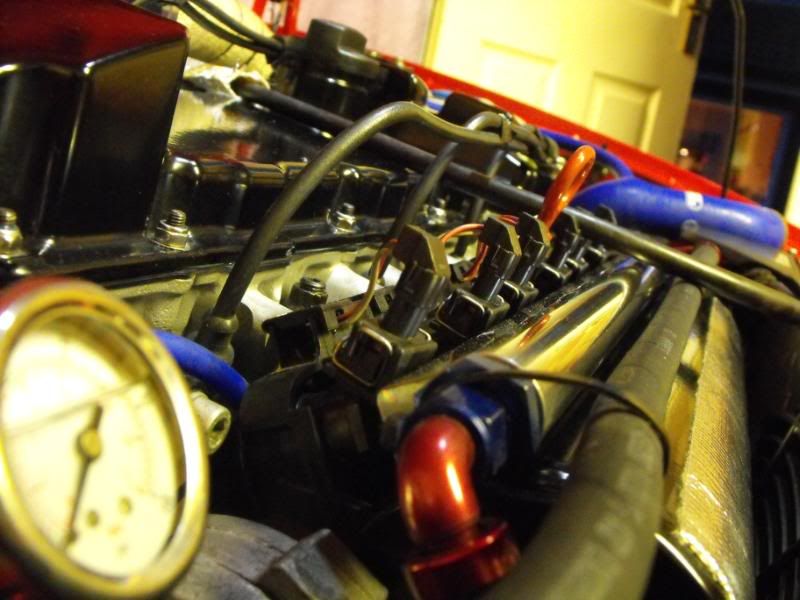

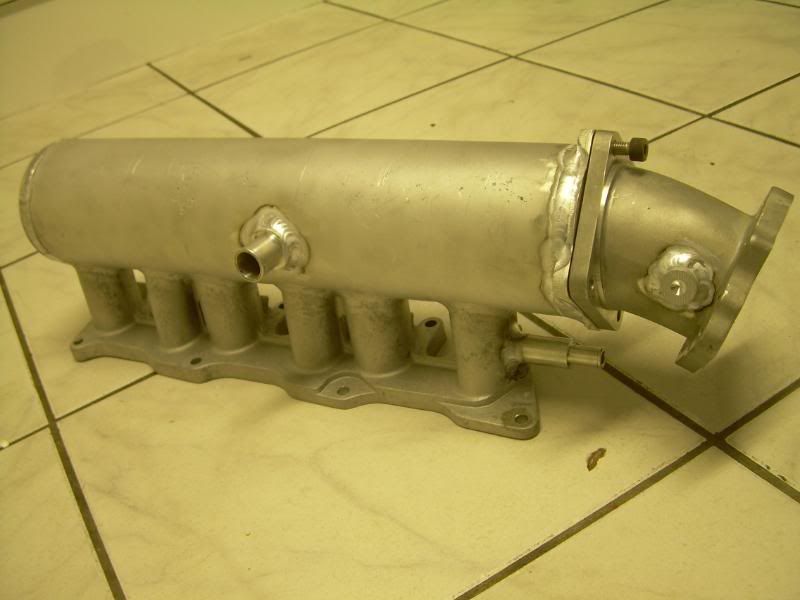

pyro3911 0 Posted July 10, 2008 Hi, Great conversion looks great hope it lasts this time. Been reading this thread with interest as I am starting a homemade turbo conversion soon. I am starting on the inlet manifold first and I am just getting the parts together. Just wondering what the pipe was at the bottom of the new inlet manifold. Ian Share this post Link to post Share on other sites
boost monkey 0 Posted July 10, 2008 pyro3911 said: Hi, Great conversion looks great hope it lasts this time. Been reading this thread with interest as I am starting a homemade turbo conversion soon. I am starting on the inlet manifold first and I am just getting the parts together. Just wondering what the pipe was at the bottom of the new inlet manifold. Ian The silver pipe with the blue ends is the fuel rail, and the braided hose going into it is a fuel line :salute: Share this post Link to post Share on other sites
pete_griff 0 Posted July 10, 2008 pyro3911 said: Hi, Great conversion looks great hope it lasts this time. Been reading this thread with interest as I am starting a homemade turbo conversion soon. I am starting on the inlet manifold first and I am just getting the parts together. Just wondering what the pipe was at the bottom of the new inlet manifold. Ian the pipe coming off the bottom of the inlet manifold is a vacuum pipe going to the brake servo if remember correctly (without looking back through all the posts to find out) - i remember because i asked about it, being curious as to it being a vacuum pipe, yet being connected to something that would be receiving forced induction (if that's what you're asking as well.....) in a nutshell james explained that being as most of the time it would still be under negative pressure then it would still work fine :) Share this post Link to post Share on other sites
CorradoVR6-Turbo 0 Posted July 11, 2008 fla said: Stunning, James, but then again nothig less was expected. Would love to see this some time, although you are a fair few miles up north from London. Mabey we will meet at a show or something at some point,but would like to put names to faces so might do some south shows this year :tongue: pyro3911 said: Hi, Great conversion looks great hope it lasts this time. Been reading this thread with interest as I am starting a homemade turbo conversion soon. I am starting on the inlet manifold first and I am just getting the parts together. Just wondering what the pipe was at the bottom of the new inlet manifold. Ian If you are refering to the pipe in the centre at the base of the manifold,its for the idle valve mate,the one on the right side is for the servo. Good luck with the conversion mate,it will be worth it in the end... :wink: Share this post Link to post Share on other sites
pyro3911 0 Posted July 11, 2008 Thats the one, thanks for that. I am hoping it will be worth it, was looking at supercharged 24v but decided against it. cheers Ian Share this post Link to post Share on other sites
pete_griff 0 Posted July 11, 2008 CorradoVR6-n.o.s said: fla said: Stunning, James, but then again nothig less was expected. Would love to see this some time, although you are a fair few miles up north from London. Mabey we will meet at a show or something at some point,but would like to put names to faces so might do some south shows this year :tongue: pyro3911 said: Hi, Great conversion looks great hope it lasts this time. Been reading this thread with interest as I am starting a homemade turbo conversion soon. I am starting on the inlet manifold first and I am just getting the parts together. Just wondering what the pipe was at the bottom of the new inlet manifold. Ian If you are refering to the pipe in the centre at the base of the manifold,its for the idle valve mate,the one on the right side is for the servo. Good luck with the conversion mate,it will be worth it in the end... :wink: oh yeah - cheers for pointing that out - looks like i was being a muppet :? Share this post Link to post Share on other sites
CorradoVR6-Turbo 0 Posted July 11, 2008 dont worry mate,at least you remembered about the vacum thing i was on about :lol: :tongue: Share this post Link to post Share on other sites
PiercedWinky 0 Posted July 11, 2008 Looks really good, but I would ditch the idle valve personally. Share this post Link to post Share on other sites
CorradoVR6-Turbo 0 Posted July 11, 2008 umm...ok,why? Share this post Link to post Share on other sites
PiercedWinky 0 Posted July 11, 2008 I see it as a cause of a boost leak. In the couple of VRT cars I have tuned the ISV was always causing issues. Pulled it and it ran great. The car will idle just fine and you can use the idle set screw on the TB to adjust the idle. I know a few other people that have come across the same thing I have also. Share this post Link to post Share on other sites
