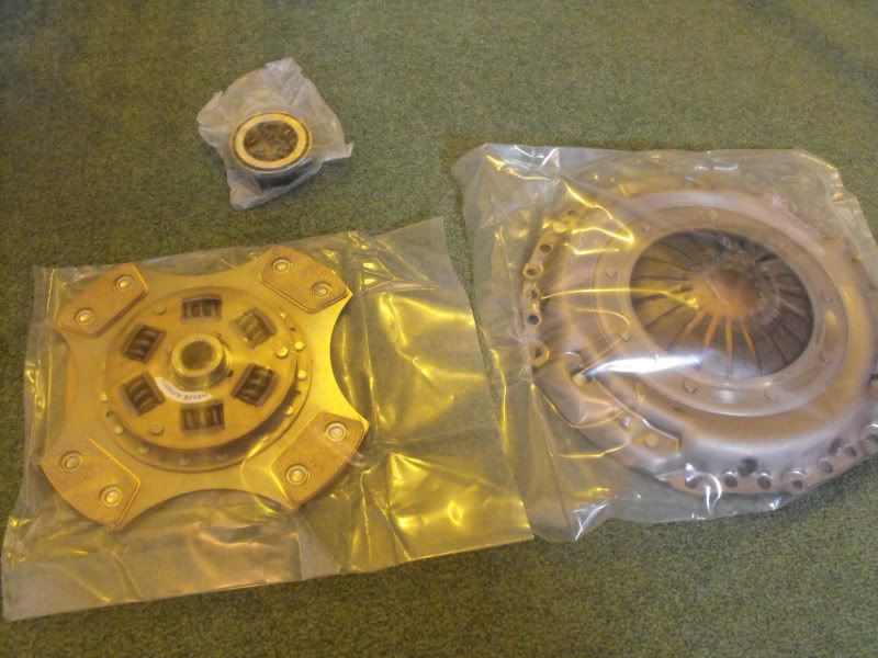

CorradoVR6-Turbo 0 Posted July 24, 2009 more goodies :D Share this post Link to post Share on other sites
shaunVR6 0 Posted July 24, 2009 real nice bit of kit matey :) Share this post Link to post Share on other sites
black dub 0 Posted July 25, 2009 that clutch looks like a good piece of kit iv been looking into one of these myself, can i ask where your brought it from and how much you paid as iv had a couple of quotes and want to compare. cheers Share this post Link to post Share on other sites

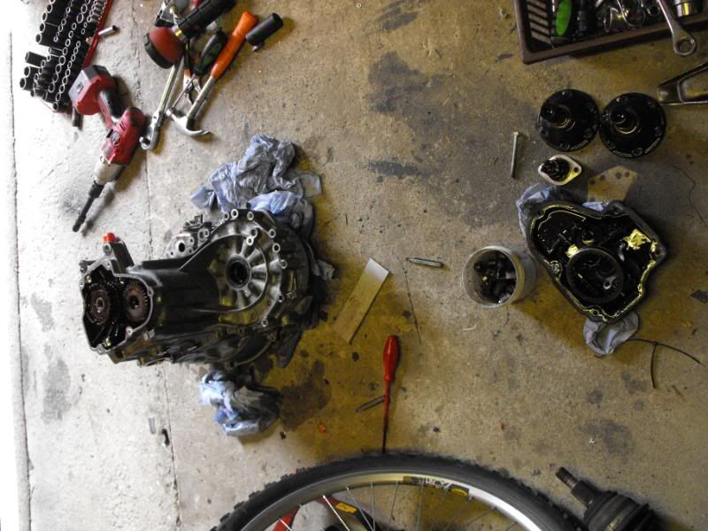

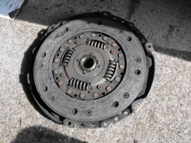

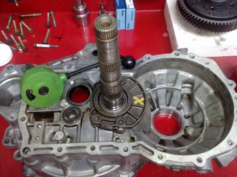

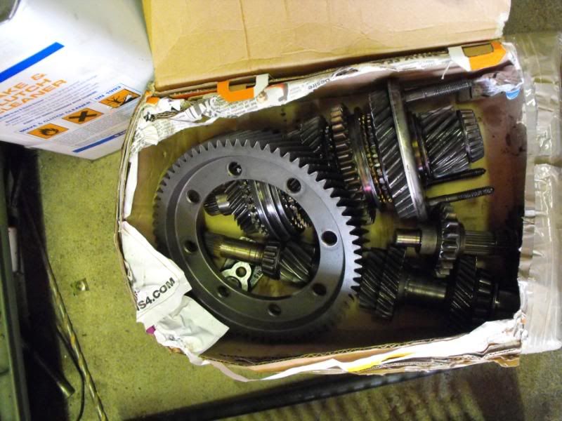

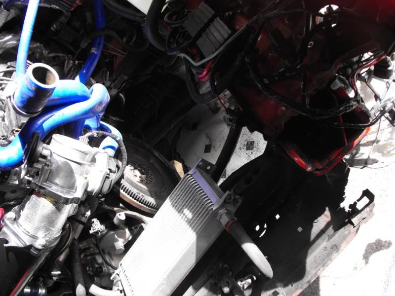

CorradoVR6-Turbo 0 Posted July 25, 2009 Thanks folks....well i was going to wait after leeds festival but the clutch is dying fast :( So out the box...hour and a half it was out and semi stripped down...but ive had enoght of working on the floor at home so its all off to work with the proper tools...benches etc 8) In bits again.... :scratch: Should there be something here? :scratch: Old and very tierd clutch ABF CDA Gearset,all the same ratios as the VR besides the final drive of 3.68,think im going to drop the hole lot in... O2M vs O2A Helix four and six puc sets.. Share this post Link to post Share on other sites

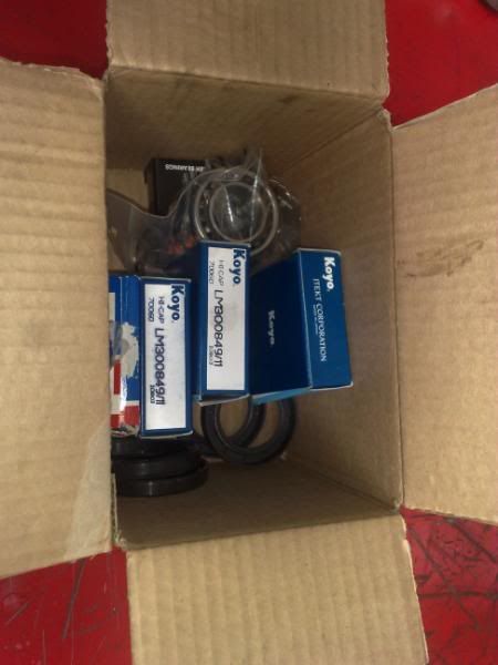

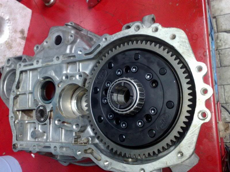

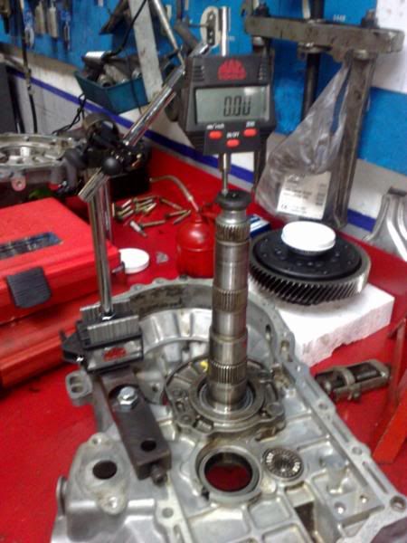

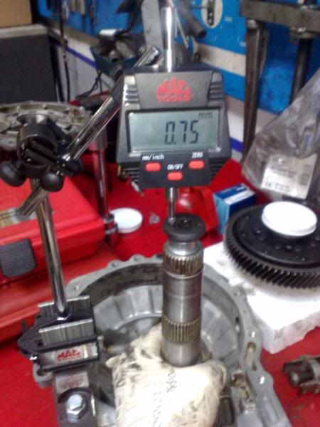

CorradoVR6-Turbo 0 Posted July 29, 2009 you have to many cars Karl.. :lol: Well ive been building the box on and off after work,took some time to clean and inspect everything and glad to say only one selector ring needs replacing...but ive got spare wehay! but for 160k very,very good 8) Lots of bits.....lots of cleaning :gag: and a box of bearings and seals First main shaft,remove shims,check lift then add constant preload to give you total shim size,then check rolling torque as per manual and your done! 8) then repeat with input and diff :sleeping: Green gauge is to measure rolling resistance.... :camp: Later Peloquin diff with non push ARP bolts torqued to 115 lb/ft just waiting on some shims from VW then final rebuld. :salute: Share this post Link to post Share on other sites

CorradoVR6-Turbo 0 Posted July 30, 2009 Thanks for the replys folks,its my first vw o2a box ive done and i suspect i will be doing more in the futue... :norty: Box is now back together,diff,input and mainshaft all dialed in and preloaded to VW spec so it will be a nice tight box. Input,main,diff and reverse gear back in. Selector forks back on. Case back on with Fith gear and selector fork. All done :clap: Share this post Link to post Share on other sites

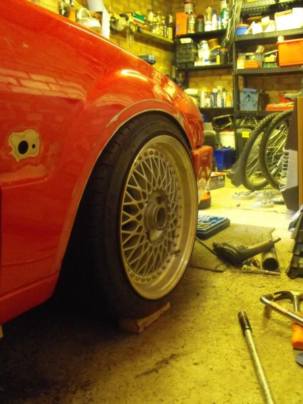

CorradoVR6-Turbo 0 Posted September 6, 2009 Thanks Ben and Kip :) special tools are dial gauge and stand but you can get them anywhere but the expensive one measures rolling resistance but a old style bar and rod style torque wrench will do the same job and are penny's on ebay and such. Ive said when i have some time i will do a write up but to be honest that will be some rime as ive started on bodywork...... :pale: So it has begun..... Share this post Link to post Share on other sites
CorradoVR6-Turbo 0 Posted September 6, 2009 yip....need stance! and they go over the 6 pots..just! Share this post Link to post Share on other sites
lilfuzzer 1 Posted September 6, 2009 CorradoVR6-Turbo said: yip....need stance! and they go over the 6 pots..just! Nice love the way they look! :luvlove: :notworthy: you pick them up from seaham? If so I was tempted with them as looked awesome on Ashleys' car Share this post Link to post Share on other sites
CorradoVR6-Turbo 0 Posted September 6, 2009 I did mate,went today,fitted one side at his house to get the feel for them and to check brake clearance etc...loved them done the deal and when the arches are beaten out to suit it will work well. Also the rims are going black centres with polished outers,should work well with the red. 8) Share this post Link to post Share on other sites
