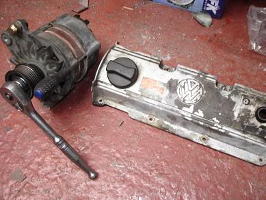

Riley 0 Posted August 28, 2007 A good thick screwdriver just sat in the fan,it will bend as you crack the nut loose...But the fin can be bent back easy peasy :) Neil. Quote Share this post Link to post Share on other sites
Riley 0 Posted August 28, 2007 Voila...knew i had a pic somewhere! Quote Share this post Link to post Share on other sites
