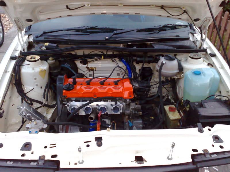

Paulr1980 0 Posted October 3, 2007 New piccys!! Nearly there. They're not rigged up yet, this was just a test fit but you get the idea. Quote Share this post Link to post Share on other sites

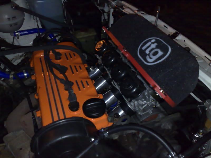

Paulr1980 0 Posted October 17, 2007 I'm almost at the point where I can start (or attempt to) the car. It's all plumbed in. The carbs now fit although parts of it were a complete ballache. Lots more fiddling around getting new coolant piping and many other little bits. I've still got concerns. A dodgy HT lead, the fact the there are quite a few joins in the fuel pipe and not knowing how to set up my filter king all are a bit of a worry. I've decided to have someone on hand with a fire extinguisher when I kick it over. On the plus side, I don't have to chop a bigass hole in my bonnet for the filter to fit and I also can relax about the carbs fouling everything under the sun. The final things to do now are to fit the throttle cable and adjust its length to make sure I'll get full throttle and to fill with coolant. That's it... It'll just be a case of priming the pump and cranking it over. Here's how it looks at the moment, similar to the above but it's what I took tonight. Quote Share this post Link to post Share on other sites
mrbeige 0 Posted October 17, 2007 Looks pretty good dude! What are you using for the ignition advance? Quote Share this post Link to post Share on other sites
Mave 0 Posted October 17, 2007 I'd love to hear the sound of this! 8) Quote Share this post Link to post Share on other sites
Paulr1980 0 Posted October 17, 2007 At the moment for the first couple of month I'll be using the standard dizzy. Not ideal I know but I've spent enough for the moment. As soon as I'm back on track with my bank account (couple of weeks) I'll pop to Omex (who are 5 minutes from where I work) and get them to sort me out with mapable ignition. It'll be dyno'd at Mech Motorsport in Cheltenham and if I can afford it I'll combine Omex with the dyno'ing of the car. Whatever it makes, it should sound pretty sweet and it's different and that's good enough for me. I'm not interested in chasing huge power. It's unlikely that I'd ever have the sklils to use it on the track. Quote Share this post Link to post Share on other sites
