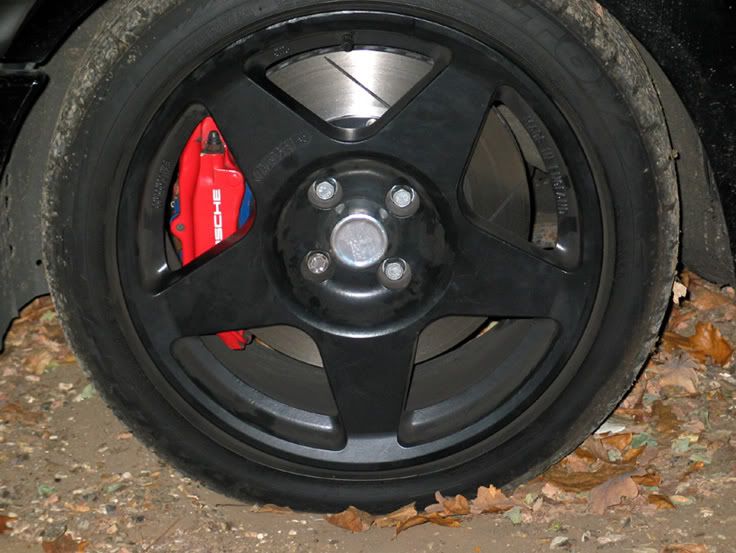

JMC 0 Posted October 29, 2007 Thought I was getting lucky earlier when 2 pizza box sized packages arrived this morning. Even better than lunch though - my front discs have arrived with all the bits :D :D . Going from the 305mm discs I have at the moment to 315mm, so should be fun once they are bedded in properly, and am going from Brembo pads to Pagid Fast Road's as well. All I need to do now is get them fitted.... Quote Share this post Link to post Share on other sites

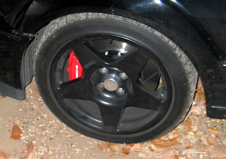

JMC 0 Posted November 6, 2007 Yay, they're on.... Well impressed with them - they're huge, and I thought the 305's were big :D :D Quote Share this post Link to post Share on other sites

vwdeviant 0 Posted November 7, 2007 Yay, they're on.... Damn there's my new favorite Wheel/break set up! Nice one John I really need to have a look round your car at some point! Quote Share this post Link to post Share on other sites
