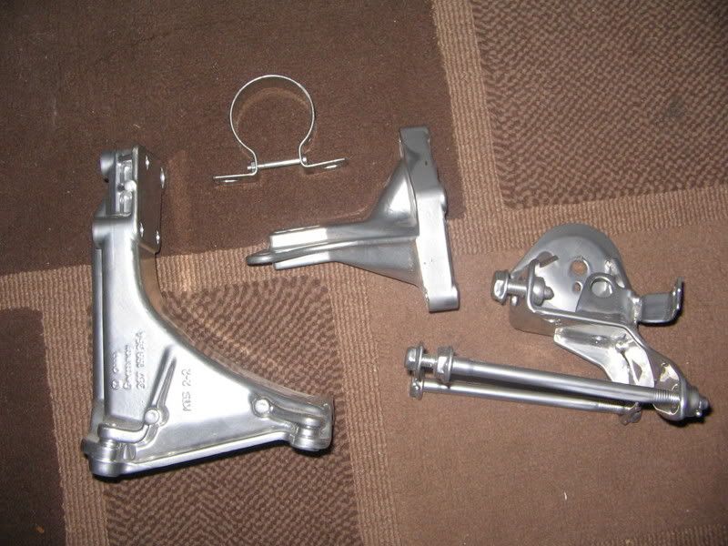

Goldie 2 Posted November 5, 2007 Ive got this lot up for grabs.. Quote Share this post Link to post Share on other sites
CrazyDave 0 Posted November 6, 2007 Ive got this lot up for grabs.. Michael, go easy I'm a 16v virgin. What am I looking at? Quote Share this post Link to post Share on other sites
Goldie 2 Posted November 6, 2007 If im perfectly honest im not too sure myself, i believe some of these bits are solid mounts, i think we need an expert to clarify though.. Quote Share this post Link to post Share on other sites
davidwort 0 Posted November 6, 2007 front (right one in pic) and rear (left one in pic) engine mounting brackets and the gearbox mounting bracket is the one in the centre, the actual rubber/hydraulic mountings for each need adding to these! Quote Share this post Link to post Share on other sites
Goldie 2 Posted November 6, 2007 Thanks for that mate, glad someone knew.. Quote Share this post Link to post Share on other sites
