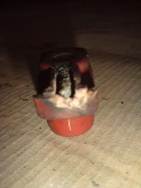

vwdeviant 0 Posted December 5, 2007 Well running issues are fixed for the princly sum of £14! :shock: It was a destroyed Rotor arm so changed that and the Dizzy cap! Will post a photo of the arm when I get my d/load cable sorted. Looking at it I can understand why it was Cr@p under 3000rpm.. there was only 1/2 the metal left on the whole arm! So All I need is an un-cracked 9a manifold now. Quote Share this post Link to post Share on other sites
vwdeviant 0 Posted December 6, 2007 The cause of my running problems.. and I'd just done about 700+ Miles last week too! :shock: TBH I'm surprised it even started, let alone pretty much on the 3/4 crank! The metal contact was 1/4 way back down the arm! Quote Share this post Link to post Share on other sites
