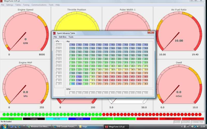

CrazyDave 0 Posted February 9, 2008 Wayne, I've sent you a new file and changed a few settings. Not sure why but I couldn't see any numbers in the cranking pulse width table, so I put default MS numbers in here. I've also changes the cranking speed to 500rpm, so that the crank pw stays active until the engine catches. Give this a go and see how you get on. Fingers crossed. Do you have your ignition table set to all 0. It may be that I don't have an ECU connected to thats why I can't see anything? Dave Quote Share this post Link to post Share on other sites

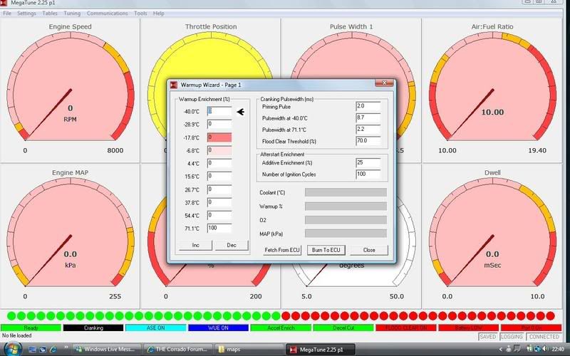

waynos 0 Posted February 9, 2008 thanks very much for that dave will give that a go tommorow. if you give me 5 - 10 mins ill put up some screen shots of the ignition table and the crank pulse width table Quote Share this post Link to post Share on other sites

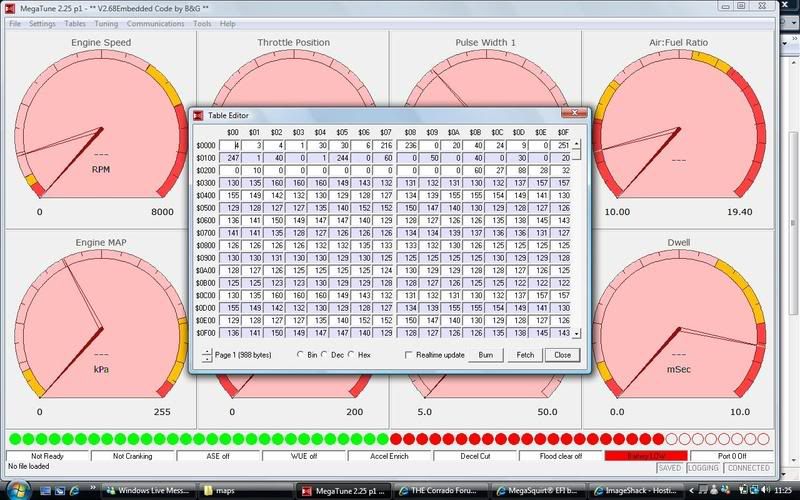

waynos 0 Posted February 9, 2008 here are the print screens just had a look at the map you sent me. the min i opened it it said i had two warnigs written to the audit log. ive had this when ive accidentally opened the file uder the wrong code/project. mine is ms2 2.687 . In the cranking pulswidths all the values are 0 and the cranking rpm is at 300 Quote Share this post Link to post Share on other sites
CrazyDave 0 Posted February 9, 2008 Ahh, ok. I'll try and find that version, should make more sense. Looking at your screens, you need some warmup numbers set -40 to 180% and use the fill tool to create a linear line for all the other points. Increase the crank -40 PW to 12.5% and raise the cranking RPM limit to 500rpm. Ignition table looks fine. Give that a try..... Quote Share this post Link to post Share on other sites

CrazyDave 0 Posted February 10, 2008 In the table editor, under tools, select curve generate. Use a linear and enter the lowest and highest table numbers, click us existing x and then generate. MS will work out all the ones in between. Quote Share this post Link to post Share on other sites

waynos 0 Posted February 10, 2008 right i tried it again with your settings dave and it ran on for a bit longer before cutting out.tried it again with some throttle and it ran for about 3 seconds befor cutting out. do you think i need to have a look at my afterstart enrichments? i also brought the injector pwm period from 90 down to 66 which helped also i didnt get very far with the table editing, heres the screen print Quote Share this post Link to post Share on other sites
waynos 0 Posted February 10, 2008 jeez its a big learning curve ! ive found out i may have the afterstart enrichments wrong. i currently have it set up to 60% additive enrichment and 75 ignition cycles - i thought this meant i get 60 % enrichment per 75 cycles... i was wrong. Did some more searching and found that the after the 75 cycles the enrichment degrades down to 0 so it looks like i need to increase this figure so the after start enrichment lasts longer Quote Share this post Link to post Share on other sites
waynos 0 Posted February 10, 2008 more progress - bumped the ignition cycles up to 250 from 75 in the afterstart enrichment - put some figures in the warmup enrichment section ranging from 180 at - 40c down to 100 at 71c - dropped the cranking pulswidth down to 8.7 has been the best start so far , it ran on for a bit longer - i thought it was going to run! but it packed out again heres the log Quote Share this post Link to post Share on other sites
CrazyDave 0 Posted February 10, 2008 Can you wind the idle up a bit mechanically? Just so you don't have to hold the throttle open. Give it a bit more fuel in the idle bins 100kPa down to 0 with 43-45% just so you can get it started. You can sort this out when it's warmed up. I'd adjust the warmup enrichment up a bit at a time until it starts properly you could also give it a bit more ignition timing but try one thing at a time so you see what the changes are. Good work Wayne, almost almost working :) Quote Share this post Link to post Share on other sites
