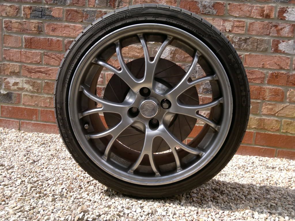

Borbets has made way for some new rims. Whilst i love the classic look of the A's they were just so heavy had no clearance for a decent sized brake.
Luckily i knew a man who had the perfect set and the result was this:
031120103291.jpg[/attachment:xnh2k6gb]
Compomotive CX-r's
I'm amazed at how a lighter wheel has transormed the handling.

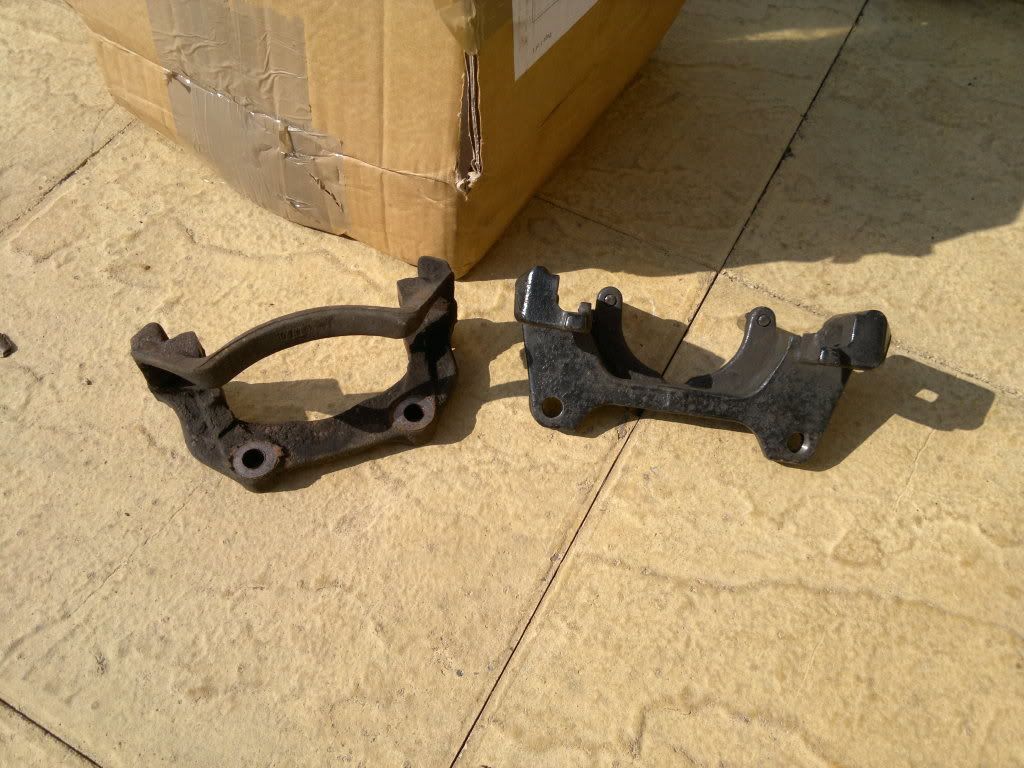

Everything seemed to be going quiet well, until I offered up the new carriers and the mounting holes were no where near right.
Turns out I've bought Mk5 golf brakes, and the mounting holes are 145mm apart, not the 95mm I require. :Grumble:
frantically searhing now for some mk4 ones, and just hope I can shift these ones to recoup some money.

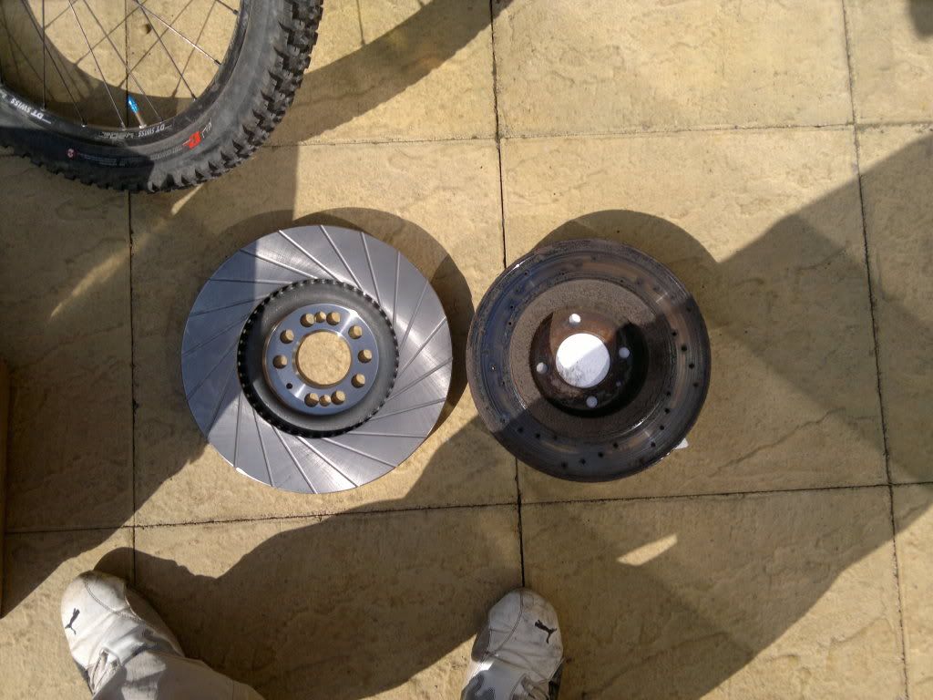

Before with my tiny 280mm brakes
comparison
difference in carrier mounts
Discs fill the wheels nicely

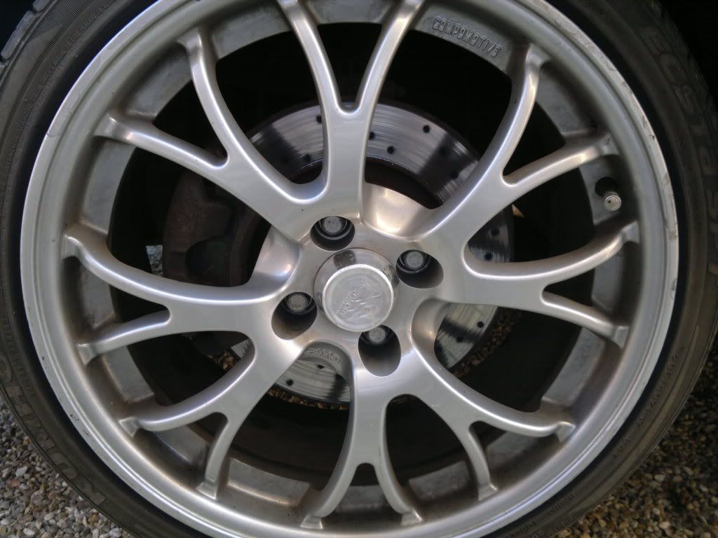

And finally have my 312mm Brakes fitted! :D Started bad as I found I had worn the inner edges of my front tires to the braiding.
It was going a little too well. Front hoses came off easily and no rounded bleed screws.
It went a little pearshaped when I put the ezibleed kit on and pressurised it. The hose to the clutch cylinder must have been a little past it's best and sprung a leek (all over the turbo manifold :( )
sorted that and bleed the brakes. Pedal went straight to the floor :( Then realised I had fitted the calipers the wrong was round to the bleed nipples pointed down. After a small amount of forehead slapping swapped them over, bled and sorted.
Look loads better but I need to bed the pads in to get the full effect.

looking minty fresh, brakes look quite big behind those rims! Did you go for vibra mounts all round? Is the engine vibration as bad as people make out? also what happened to your splitter? looks stained
Yeh really happy with how the brakes look behind the wheels, they fill them nicely.
