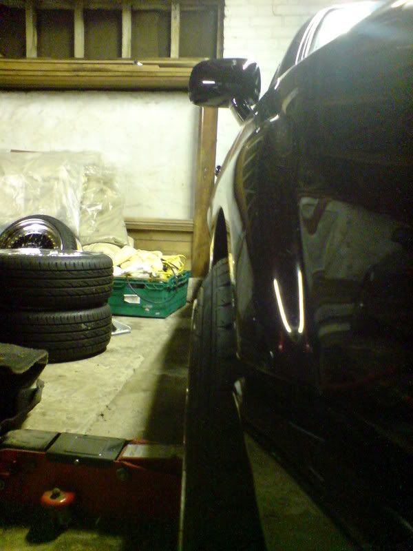

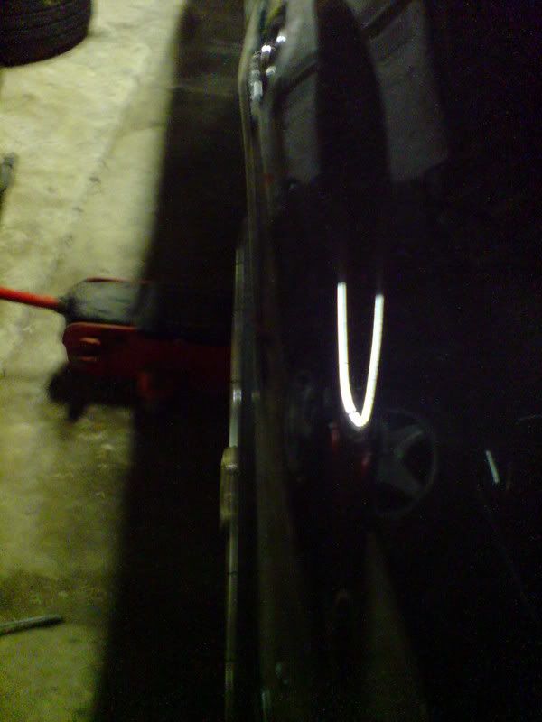

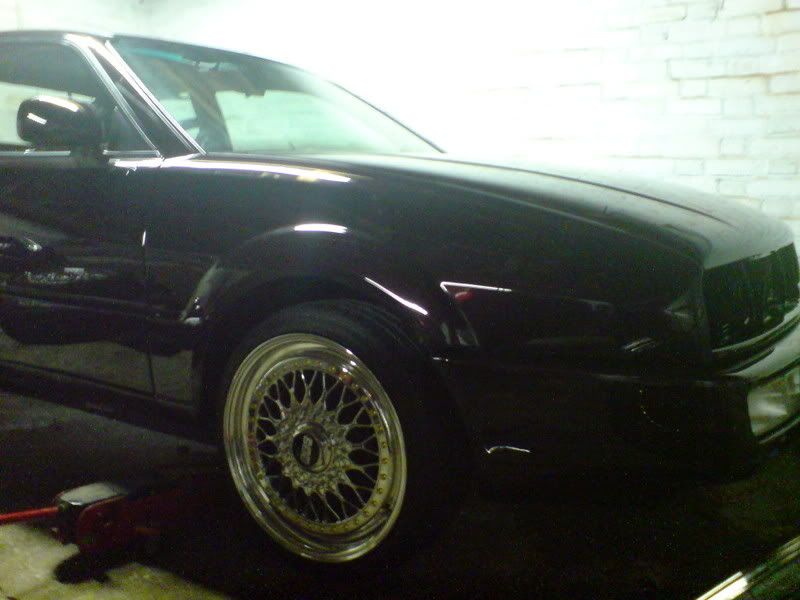

G60SC_Stoney 0 Posted January 26, 2008 right, as some of you may know, im building a 16vg60, the car is now in the garage waiting for the interior to go in etc. But ive got an issue with my wheel/brake combo. I was intending on fitting some Brembo 4 pots with 305mm disks (cupra setup) on the G60 hubs and then use some 20mm 4x100>5x100 adapters to fit my BBS RS301s on with. problem with this is one of my sets of 301s has slightly wider lips bringing them out to around 8 inches wide, and poke past the arches by about 20mm (exactly the width of the adapter) so my second option was... Convert to 5 stud with VR6 hubs etc, etc, thus saving me the 20mm needed to fit the BBS under the arches and fit perfectly. That would be fine except that ive been in contact with Bill Brockbank and also had a look for myself and found that the Seat disks are inset and make contact with a part of the hub (the caliper mounting area) pic below: so they wont fit (unless i cut that part off, is that an option? and then fit the caliper spacers and fabricate some kind of spacer, then this may still not be possible) which brings me onto my thrid option, which is the only viable one, sell the Brembo setup and fit a VAG 312mm setup onto the VR6 hubs, but the issue then is whether the 312mm setup is man enough to stop a nigh on 300BHP Corrado? Or buy some slimmer calipers and proper disks (AP racing for example) and fit them onto the VR6 hubs, but then we are talking big bucks Thoughts please, and here are some more pics of the issue, sorry about the quality camera phone is rubbish... BBS (wider lips) sticking out using 4stud hubs and 20mm adapters: BBS (standard lips) fit fine using 4 stud hubs and 20mm adapters: and one for all you BBS fans (i know she needs lowering, but she doesnt have an engine in at the moment!) Quote Share this post Link to post Share on other sites
