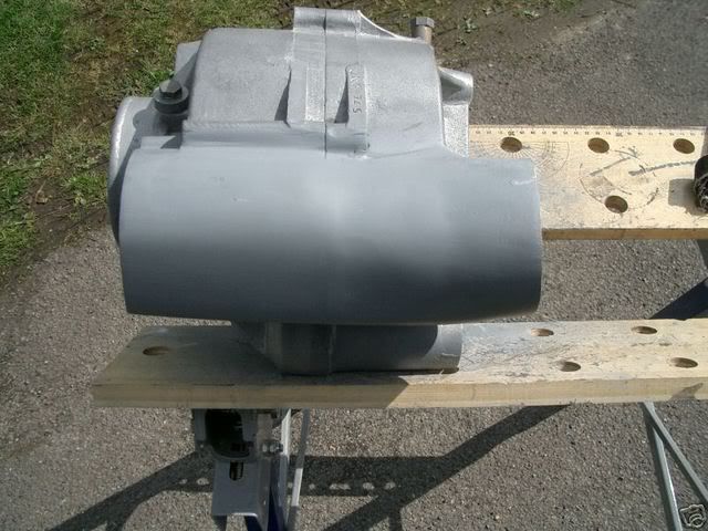

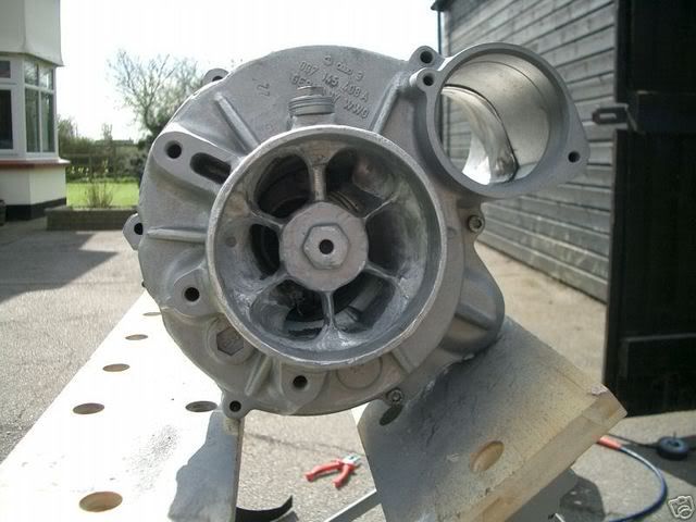

flusted 0 Posted April 9, 2008 What do you think to this? Its had a 3.5" inlet welded to the inlet casing and a 4" outlet welded on. Pics looks like the casing is welded together :shrug: what do you think? On ebay for £800 Quote Share this post Link to post Share on other sites

junkie 0 Posted April 10, 2008 No i wouldnt buy it, if they are known to be somewhat unreliable in the 1st place then why would you want 1 thats been chopped up and modifyed in a major way, and if the casing is welded together then surely its a 1 way road from then on. Quote Share this post Link to post Share on other sites

Riley 0 Posted April 10, 2008 I wouldn't touch it with a barge pole... :confused4: I don't see any gains from it what so ever with having larger inlets/outlets...its the metal just before and after these that causes the restriction in flow as suggested.If those parts matched the new parts welded on then you would see some sort of difference. It looks like the front has had a skim of filler then sanded to me ready for painting maybe? Neil. Quote Share this post Link to post Share on other sites
flusted 0 Posted April 10, 2008 it supposebly all ported inside to same standard Quote Share this post Link to post Share on other sites
coolrado 0 Posted April 10, 2008 Looks a bit dodgy to me, the porting looks quite rough, at least from those pictures. I have seen one of the g-werks race spec chargers and the porting looked very smooth and polished nothing like that one. and i dont think i would trust a charger after it had been welded to that extent. also the filler or whatever it is over the inlet just seems odd to me what is it hiding, or has this guy just got half way through a project and then given up? I would steer well clear. Quote Share this post Link to post Share on other sites
