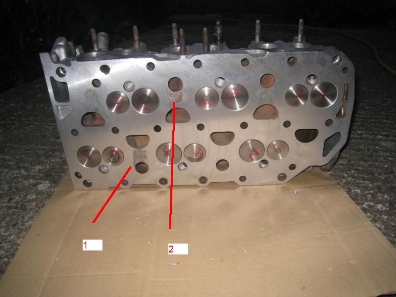

zak 0 Posted August 15, 2008 heres a pic of the of the skimmed head, the engineering firm skimmed it 7 thou, there are two bits of corrosion i was concerned about but they advised it shouldnt be an issue i dont have pics of the block but i did scrape all the old gasket material off and rub it down with emery paper slightly Quote Share this post Link to post Share on other sites
zak 0 Posted August 15, 2008 heres my compression test results Cyl 1 2 3 4 5 6 Dry. 151 160 152 161 154 154 Wet 158 166 165 180 170 170 Figures in psi. I warmed the engine up untill the fans kicked in, pulled the fuel pump relay and fuse and disconnected the lv wiring to the coilpack. After which i removed all the plugs and took readings for each cylinder one at a time while cranking the car over. Does this confirm the head gasket has sealed? i dont have the tool to analyse exhaust gasses from the coolant expansion tank, will i still need to do this? While i was out working on the car i pulled the wiring to the lamda and ran it for a few minutes and i have the same problem, When i get time i'll go through and check out the values in vag com see if i can spot anything there. I'm pretty stumped not sure what to do next, If i can i'll take it for a spin early tommorow morning or later this evening and see if it makes a difference. Quote Share this post Link to post Share on other sites
Kevin Bacon 5 Posted August 15, 2008 Those head pits ideally could have done with being ground out and JB welded before skimming, but they're very normal for a VR6 and why G11 was scrapped and replaced with G12 and G12+. Compressions are within tolerance. You never get 180 across all 6 on a VR6, except on factory fresh ones. Quote Share this post Link to post Share on other sites
