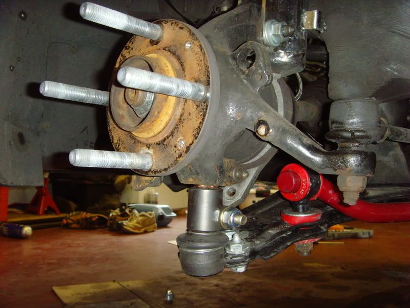

boost monkey 0 Posted October 23, 2008 just been browsing, CGTI had a GB on tyhem a while back. Cost around about £130 ($197 when the GB was on) and apparently not for road use? perhaps they're not made so well and might pop out on rougher surfaces :shock: Quote Share this post Link to post Share on other sites

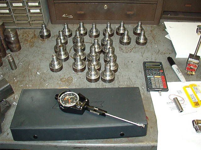

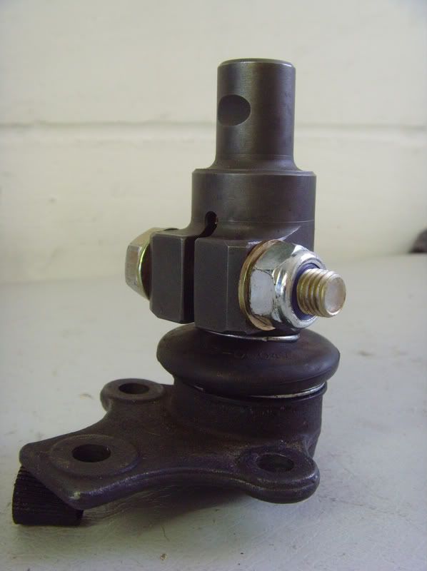

boost monkey 0 Posted October 23, 2008 pics for clicks: looks like carburised / carbon steel to my eyes. Quote Share this post Link to post Share on other sites
boost monkey 0 Posted October 23, 2008 sorry, they're normal steel with a black oxide finish. Edit: found the website now too Performance Machine Works Sorry for the off-topic as these LBJEs won't actually reduce bump steer as the TCE on the rack is left unchanged! :nuts: Quote Share this post Link to post Share on other sites
Kevin Bacon 5 Posted October 24, 2008 Awesome, think I'll have to get some of those! If you lower the wishbone and the TRE, it defo will reduce bump steer. It's the angle of the TRE relative to the wishbone that causes BS. Raising the rack will help too, but it's not necessary if you can lower the TREs instead. Besides which, if you raised the rack, say 10mm, you'd have to cut 10mm off the end of the UJ or somehow move the column 10mm further into the car, pushing the wheel closer to the driver.... Quote Share this post Link to post Share on other sites

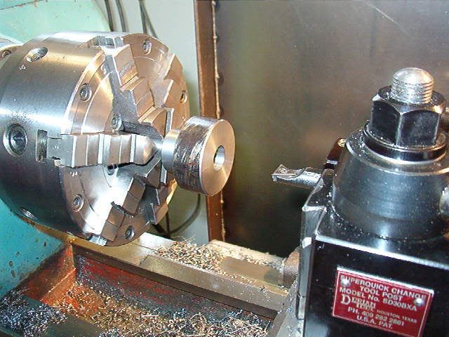

boost monkey 0 Posted October 24, 2008 £100 seems like robbery, they're only made on a lathe FFS! Quote Share this post Link to post Share on other sites
mrbeige 0 Posted October 24, 2008 £100 seems like robbery, they're only made on a lathe FFS! How the funk are they just made on a lathe? If they just had a round profile, then maybe, but they're not.. Quote Share this post Link to post Share on other sites

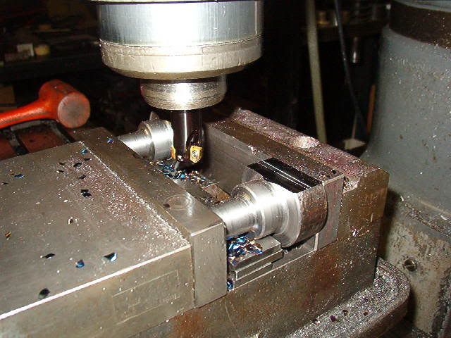

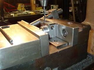

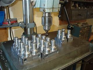

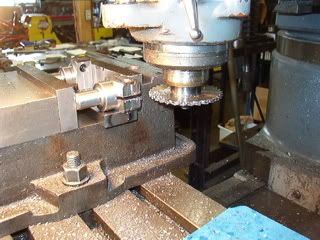

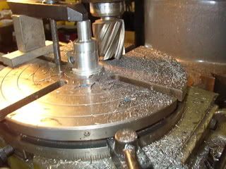

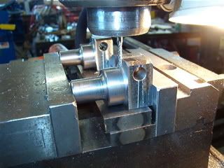

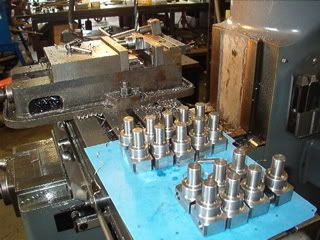

boost monkey 0 Posted October 24, 2008 I will post up the pics :salute: Ok, so they're not a hunnnnndred percent made on a lathe...bit of CNC machining too. sorry about wonky pics, i pinched them from cgti. Quote Share this post Link to post Share on other sites
mrbeige 0 Posted October 24, 2008 I will post up the pics :salute: It'd be interesting to see how you get a round and square profile at the same time from a lathe. :study: Quote Share this post Link to post Share on other sites

Kevin Bacon 5 Posted October 24, 2008 Those LBJ extenders look cast to me. The tooling and development costs required to do that costs a lot of money, so he's got to get his investment back. Quote Share this post Link to post Share on other sites
boost monkey 0 Posted October 24, 2008 yeah, fair point. I don't always remember labour / tool charges with these sorts of things. Quote Share this post Link to post Share on other sites
