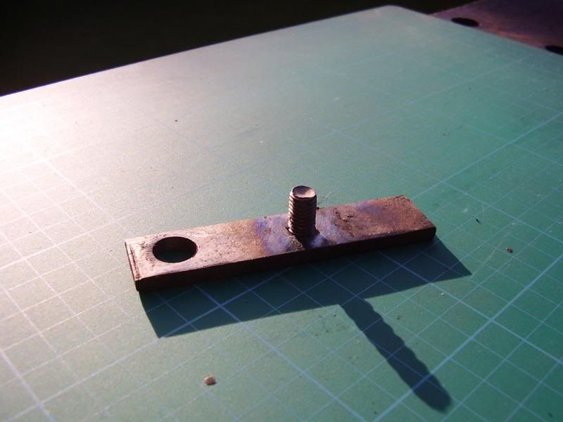

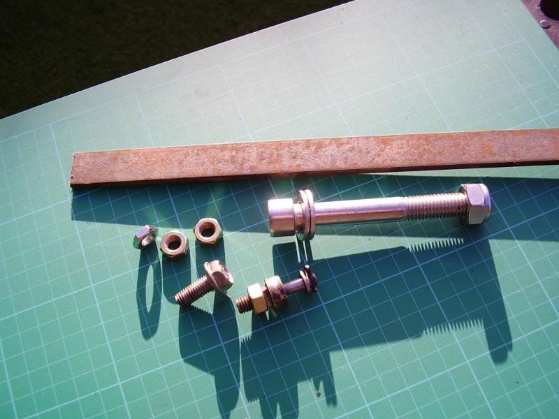

i decided to try and improve over the plastic linkage in the shift tower , at the same time moving the pivot to reduce the side to side play , much like the part gruven sells for $90
costs a couple of quid in nuts n bolts , plus the cable attacment from a earlier car i had laying around
heres a few pics incase anyone fancies making themselves one
materials req...thats 4mm x20mm bar but anything close will do, m12 bolt with a 50mm shank (slim head if possible) 1x m8 bolt , 2x m12 nuts , 4x m8 nuts

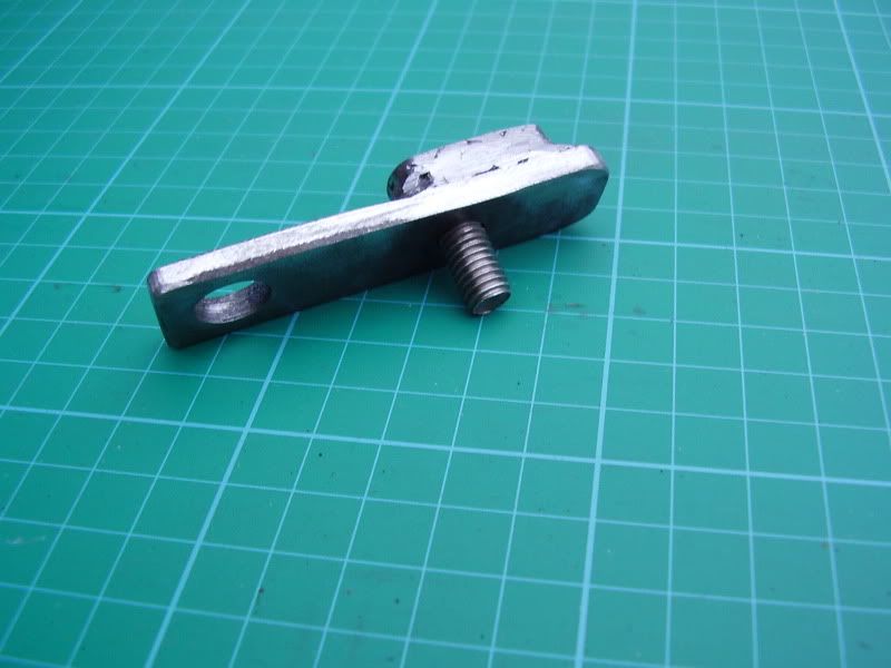

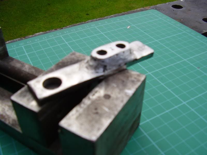

first job drill a 12mm and 8mm hole that match up with the plastic part , chop off some m8 bolt and weld it on one side and grind flat

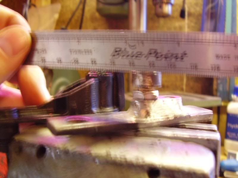

next weld on some m8 nuts , i chose to have a short shift position (-30%) and a standard one , weld on 2 nuts on top of each other , then grind back so theyre the right height , roughly 1.5 nuts high lol
offer up a straight edge to confirm theyre the right height compared to the vag plastic part

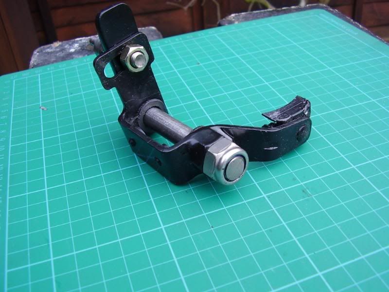

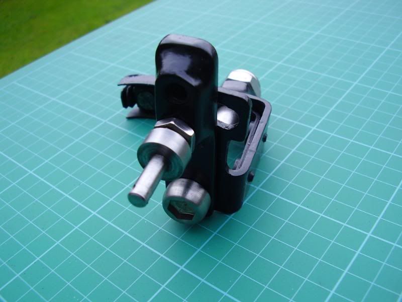

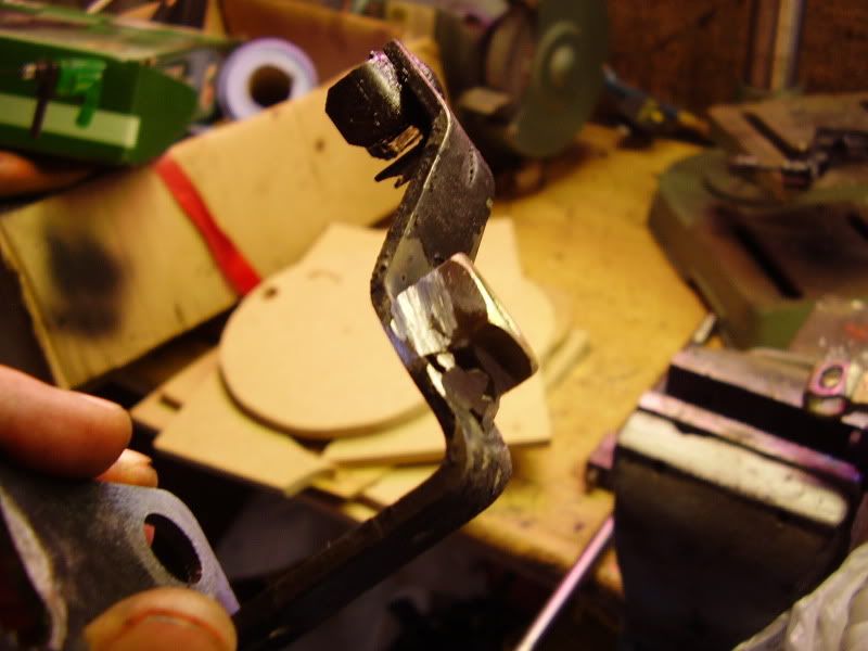

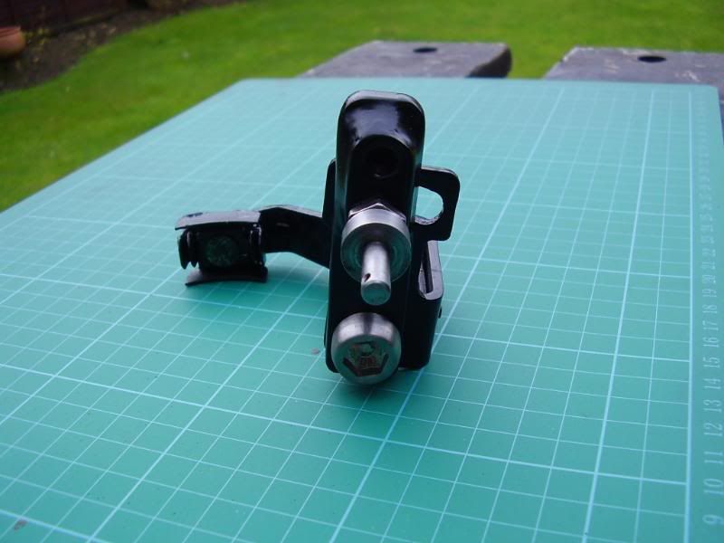

12mm drill the bracket and tack a m12 nut to the vw bracket
i found the bolt head was fairly close so ive grinded the top down a nadge , might try a regular hex head for better clearance..but here it is all done , much stronger and less play than the plastic part

Only thing I do wonder about is if the steel shaft poking through the gearbox might start to wear the gearbox a little and cause play eventually? I wonder if you machined a slot into each ond of the shaft and put an O-ring in the slots if this would prevent metal to metal contact and any chance of wear.
ah, so the OEM plastic connector serves two purposes, the actual clamp for the cable and a pivot piece for the top of the tower, come to think of it the pre 92 tower doesn't use that type of pivot, it has a solid metal pin IIRC like steves/gruvenparts mod.
i guess it will wear after a long time ...gruven obviously think its okay , and the earlier towers have metal to metal , i figure if its greased up well it should last a good long time
the o rings on the orig part ...dunno what thats about really , its a pretty sloppy fit so maybe the plastic is made undersize and the o rings are there to make it snug ? ...the hole in the tower is plain with no grooves for the rings to sit in
david..i cant really see how you make an ajustable slot , you could weld on another bit of plate instead of the nuts and have several holes really close to each other ? or just make up a rough one similar to mine and just grind off the nut and reweld another on until its to your liking
test drove it today , very much an improvement over the plastic item , 30% seems about bang on for the reduction , slightly noticable that its closer but nothing like a race car and no chance that you will chose the wrong gear
with the solid bushes and this , its close to how i want it shift quality wise

center of 12mm shaft to bolt 38mm
12mm shaft to nut center 38mm for approx 35% reduction....or 55mm to the non reduced position , or anywhere between to taste
nut height ...approx 1.5 nuts high
