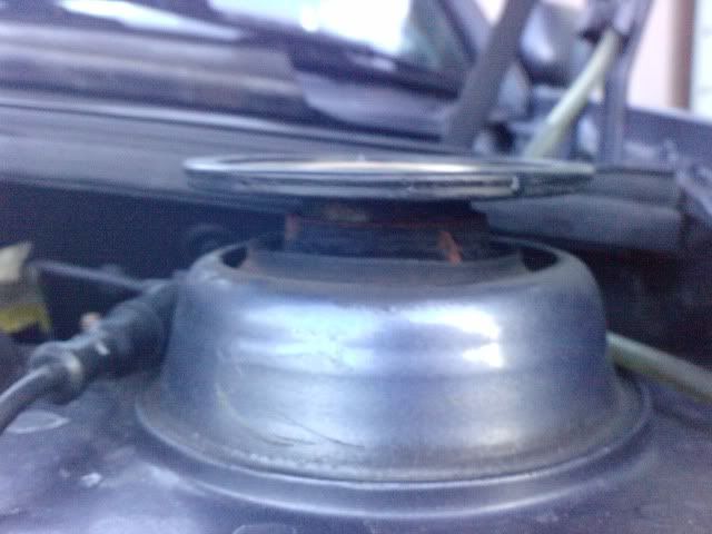

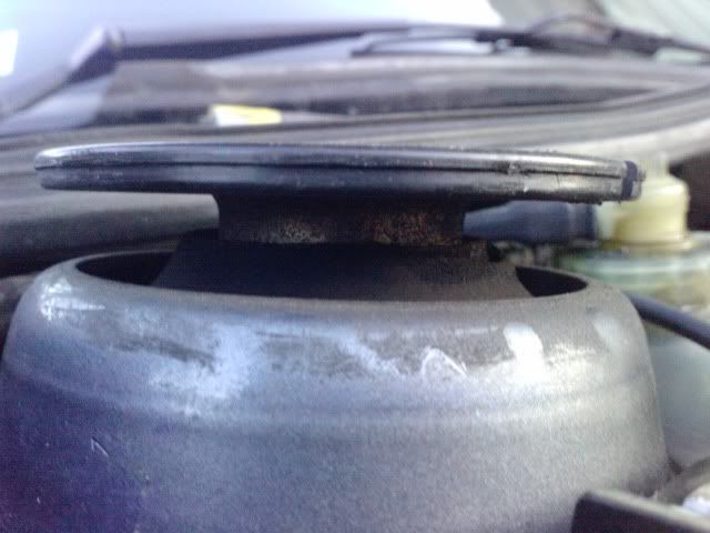

How easy is it to replace the top mounts and how do you do it?
This si the state of mine at the more
Drivers side
Passenger side
they arnt too bad to do, easier on a 2 post ramp, and a 4wheel alignment would be recommened, as thre strut would need to come out!
depends how mechanically minded you are? :D
Not really is the answer to that, so not really a DIY job then :(
