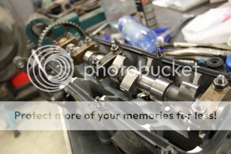

Corrado_Addict 0 Posted July 23, 2010 Before my g60 goes off to the scrapyard and I will be extremely happy to see the back of this complete nightmare of a machine, infact I'll celebrate by slamming a can of irn bru against the side of the car. I've been stripping parts off it and well I noticed this, I remember going on about a distinct rattle but no one else could pick up on what I was hearing, I was still sure there was something there after getting it checked and well after removing the rocker cover this was revealed..... Absolutely f**king appauled too see that! Quote Share this post Link to post Share on other sites

Album56 0 Posted July 23, 2010 Thats one of the 4 cam bearing heads ? ? ? :eek: Quote Share this post Link to post Share on other sites
Abdul 0 Posted July 23, 2010 Ok im not a mechanical dude, whats happened here? Quote Share this post Link to post Share on other sites
wormy 0 Posted July 23, 2010 I can't see anything wrong..? The 8v Mechanical lifter heads have 5 cam bearings, the Hydraulic heads have 4 bearings and one oil relief valve/squirter or whatever you call it just like on your picture. Quote Share this post Link to post Share on other sites
Corrado_Addict 0 Posted July 23, 2010 It should have a bearing there bud, its actually sharp and un-even, defo looks like its been broken :bad-words: Quote Share this post Link to post Share on other sites

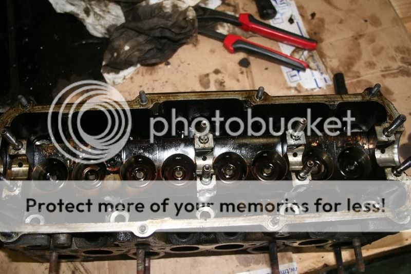

wormy 0 Posted July 23, 2010 It should have a bearing there bud, its actually sharp and un-even, defo looks like its been broken :bad-words: On hydraulic lifter heads there's no bearing between cyl 3 & 4. Think I read somewhere that the oil pressure used on the mechanical head was too much for the hydraulic lifters, so they fitted an oil relief valve / oil squirter instead.. It's more or less the same casting as the mechanical heads, so it looks a bit odd. Hope these pictures will convince you.. :) This is how my new SLS big valve head is looking f.ex. My old head.. My other spare head.. My FACTORY NEW EV-code head.. (8v gti) Quote Share this post Link to post Share on other sites

Corrado_Addict 0 Posted July 25, 2010 Hmmm when I 1st seen that I was like erm :censored: As every engine I've seen otherwise has had a full set of bearings, I never had the rocker cover off the old red one so I didn't know. Once again this forum has educated me 8) Quote Share this post Link to post Share on other sites
The_Dude 0 Posted July 25, 2010 I'll eat my humble pie too, but I must admit it does look like there is a lump missing at the top. Quote Share this post Link to post Share on other sites
