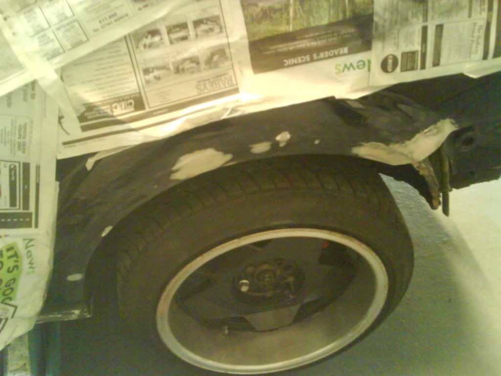

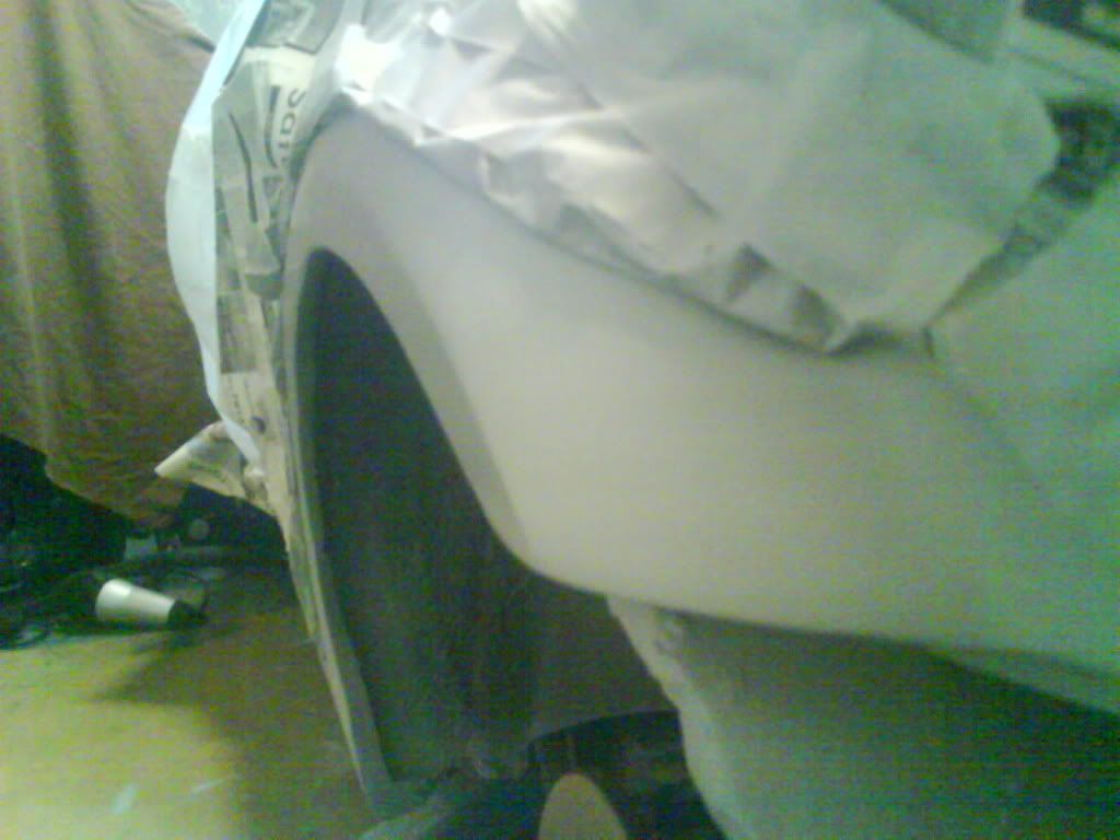

rust scabs/holes welded and smoothed on the arch, need to source a repair section from another corrado for the rear lower corner, i dont
need to as its fine as it is because its hidden by the bumper but would be nice to finish it off

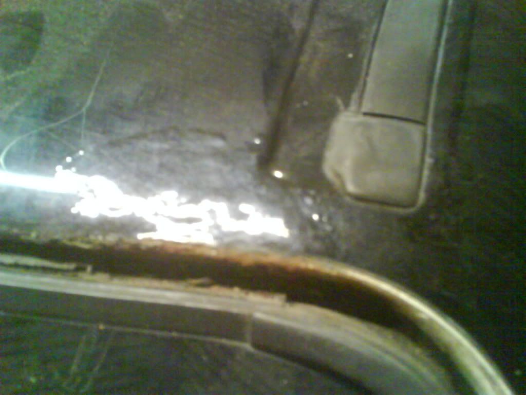

also found slight rust scabbing on the sill beneath the door, had to smooth out the rocker panel as a previous
owner has had metal welded in at some point, think they hit a kerb or something, well they just put filler over it
and sprayed it black! they didnt even bother smoothing it or trying to match the stone chip finish! so iv also
had to smooth that and also going to be sparying u-pol gravitex on the rocker which should match the

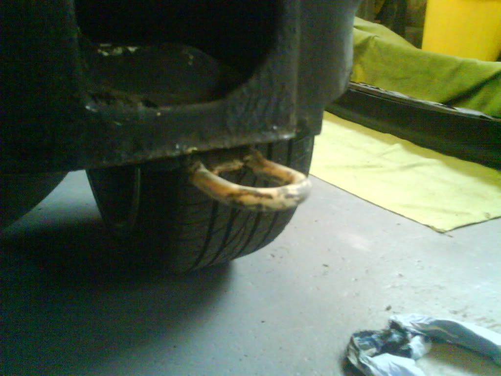

giveing the old toweing eye a clean up aswell! fed up of seeing that thing looking dull and miserable!

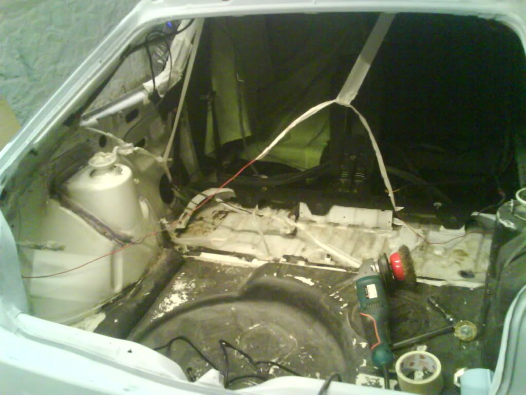

also noticed the underseal splitting on the lower edge and rust forming so i grabed the grinder and removed it!!
its been primed since just cant find the pic,
my plan is to get these area's smoothed of rust welded/filled and primed with 2k primer then go from there, i know what it takes to get a good finish in paint

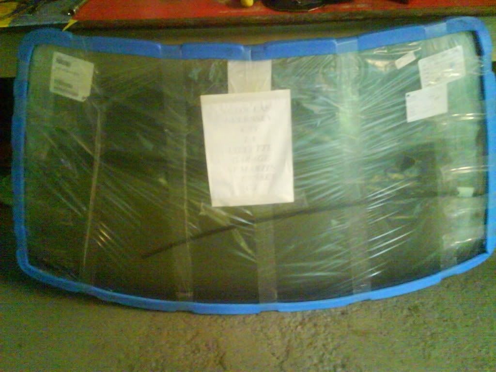

hello new windscreen :)

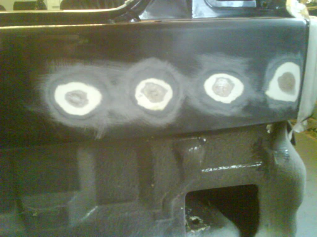

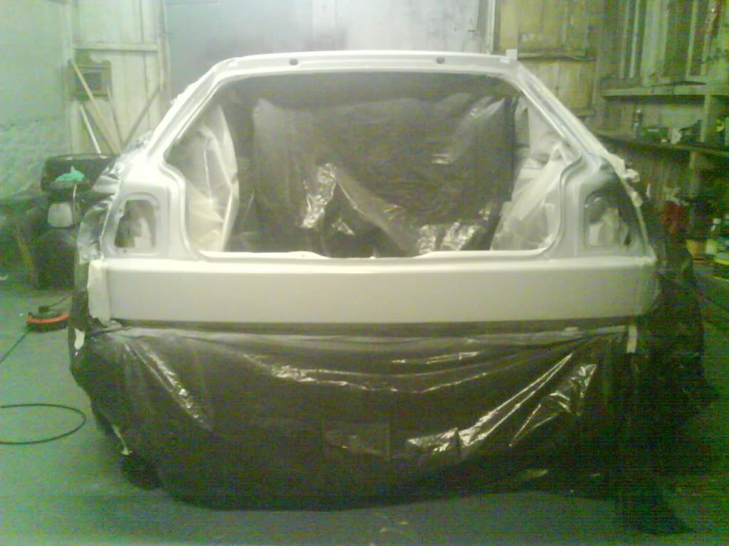

rear valance rust bubble cut out!

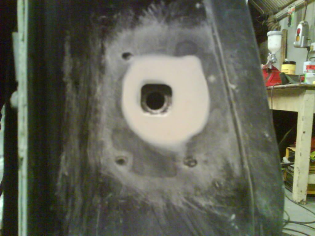

badge holes welded!
ready for a skim of filler!
also found a minor dent and slight surface rust comming through on the lower left corner which sanded out a treat! caught it just in time before any realy damage,
last few days iv made slow progress,
smoothing the rear end has taken me, no word of a lie around 10 hours to smooth out!!! prety much replaced my sanding block with a 30cm skool style

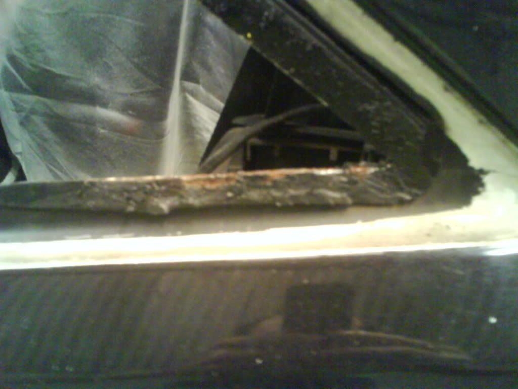

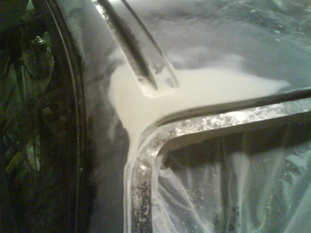

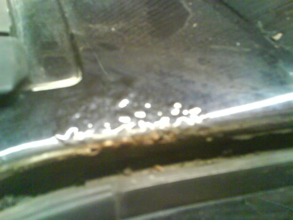

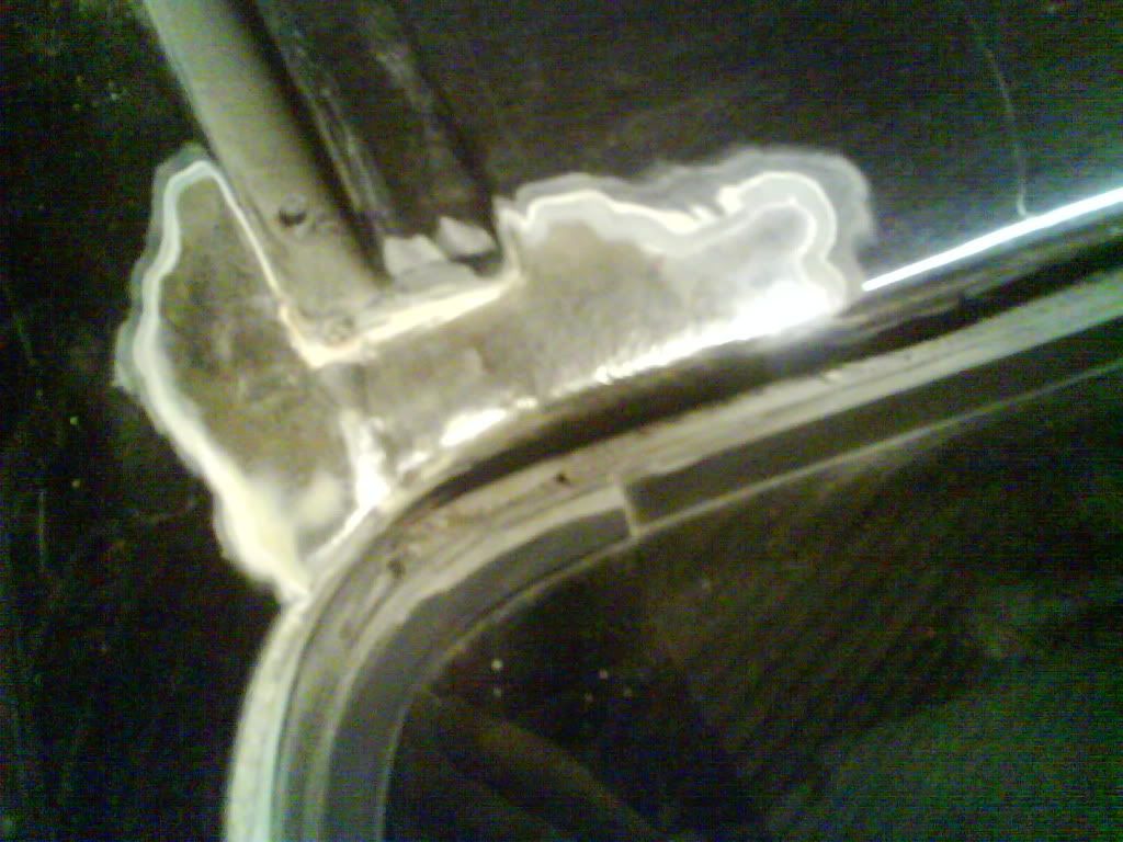

now just uncovered the nasty windscreen bubbles which for once has turned out better then expected!! i realy cant understand how theres no holes!!!! wtf!!
just pitted, not sure how thin the metal is but seems alrite!
just a tiny pin hole on the far right side on the curve
which is alot better then what i was expecting, {one big hole!!}
Happy days eh :)

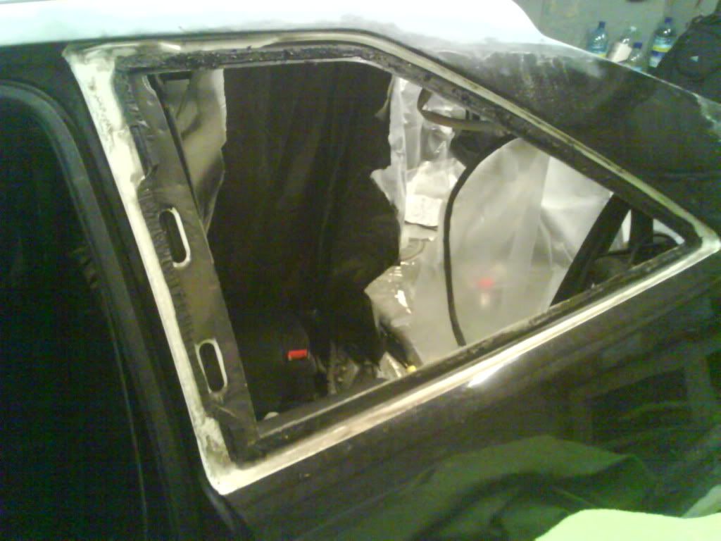

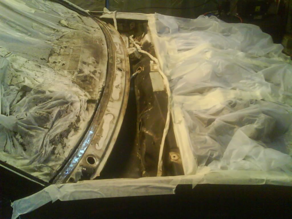

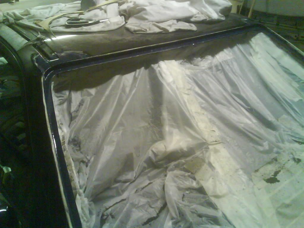

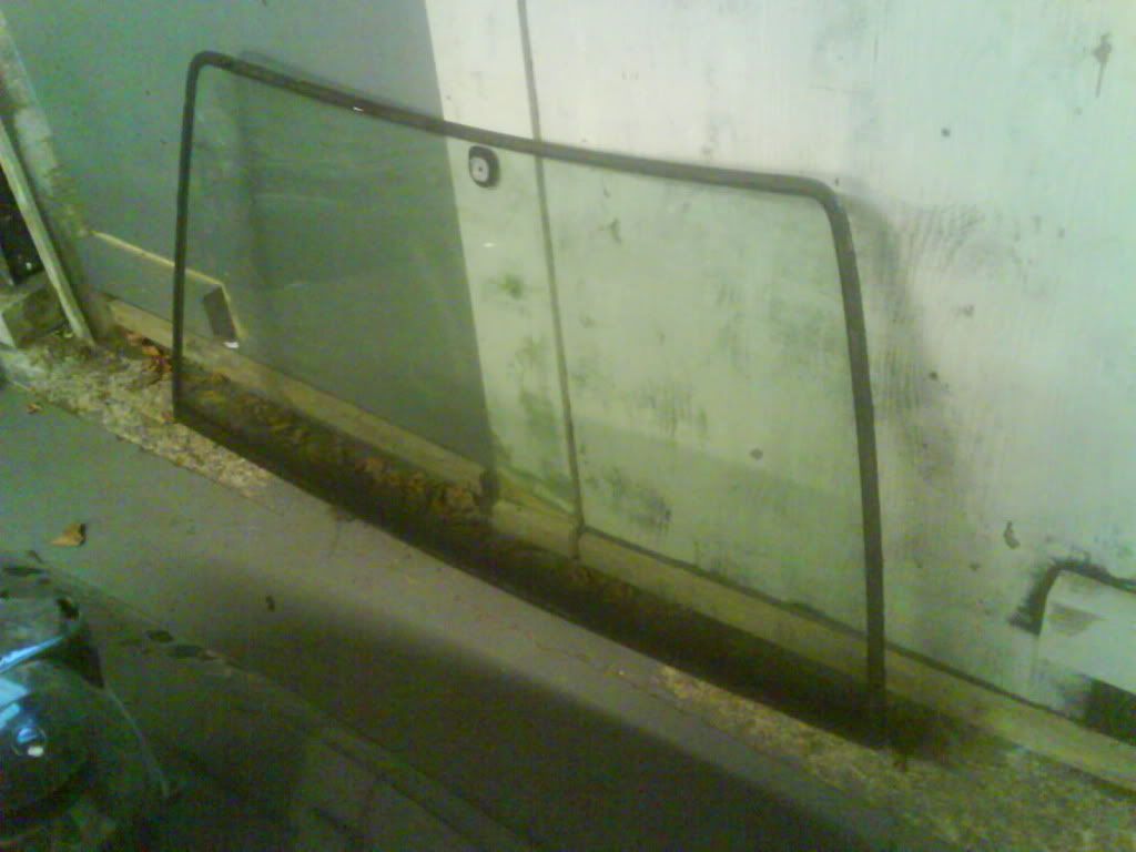

bit of progress today! got the screen out !, took me an a m8 around 3 hours useing a wire saw, its glued in with some prety thick black adhesive which is hard as fxxx!,
broke the wire several times but got there in the end :) , going to clean up the edges and see what i got!

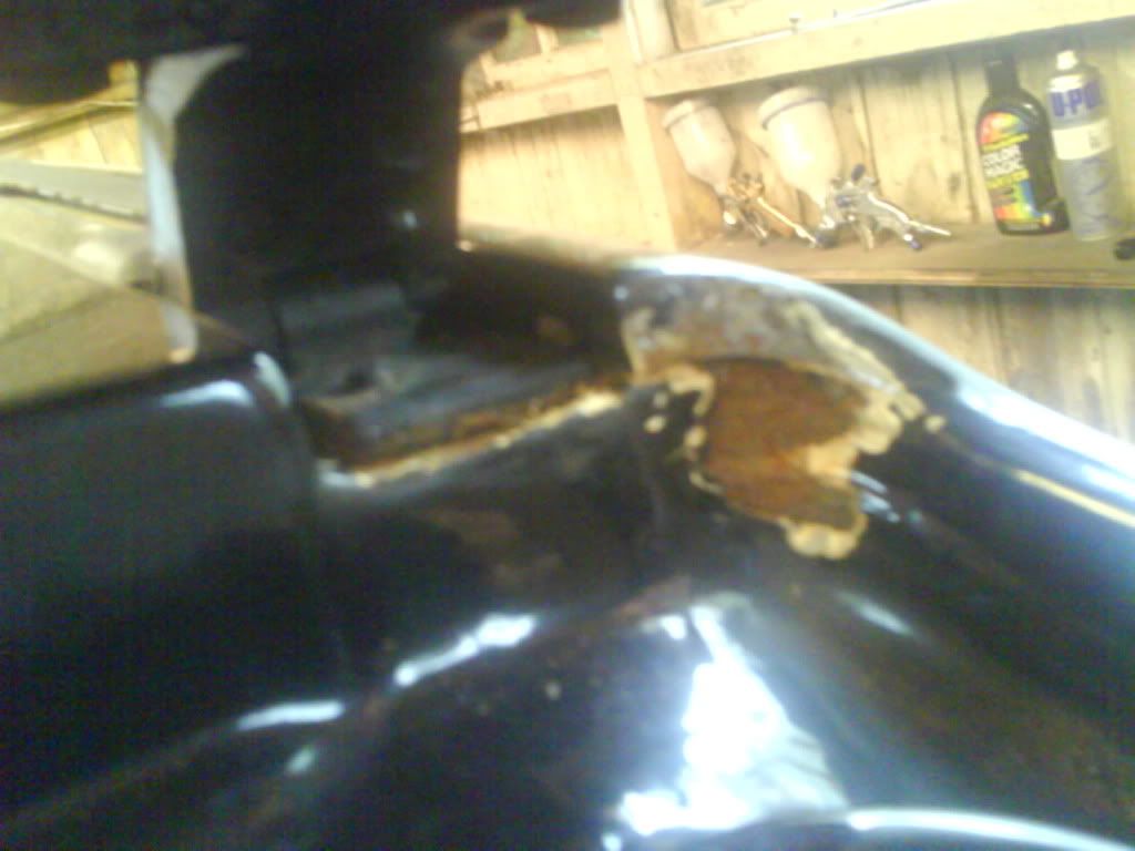

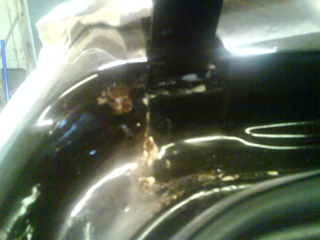

i know im going to have to get cutting and welding as a few holes are showing! not sure if i should spend some £££ on getting hold of some repair sections cut out of another corrado as its not looking to bad!
atlest iv saved myself some pennys by cutting it out ourselfs, cant imagine they would of done it for under £100, going to get the new screen proffeshionaly put in though as it has to be bang on!! otherwise the trim/seals wont fit and id rather not risk haven to cut it out again!! horrid job!

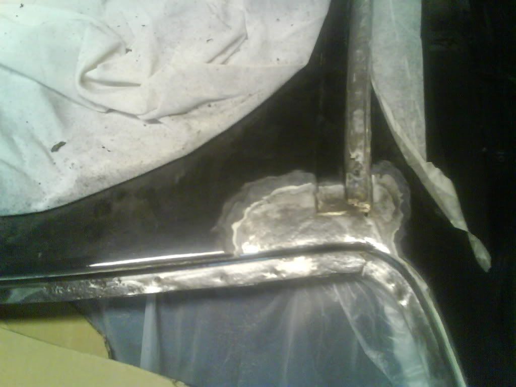

cleaned the edges up with a wire wheel and a dremel { luve that tool!!}

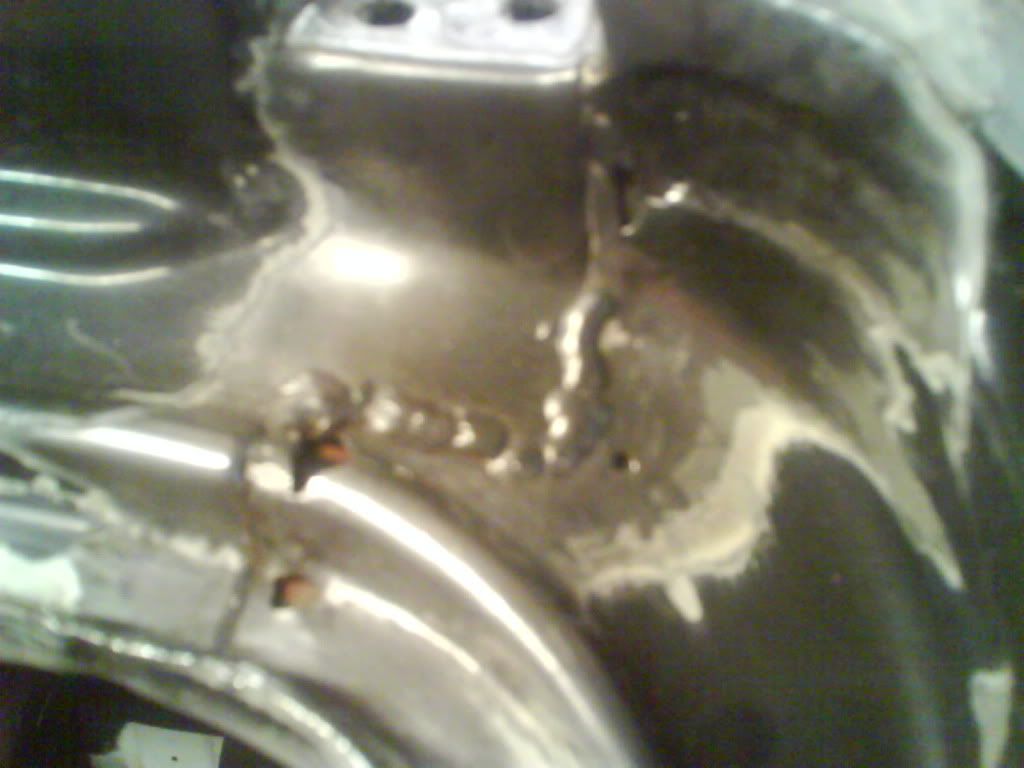

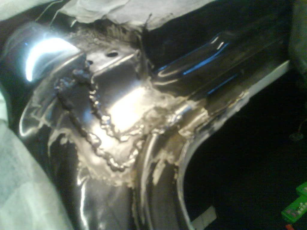

for the finer bits, had to weld up a couple of holes,oh had to change my gas in the welder, i was useing plain c02 then started useing argon co2 and theres a huge difference! not sure if its for the best but i'll let you guys know once iv had some more play time with it :)

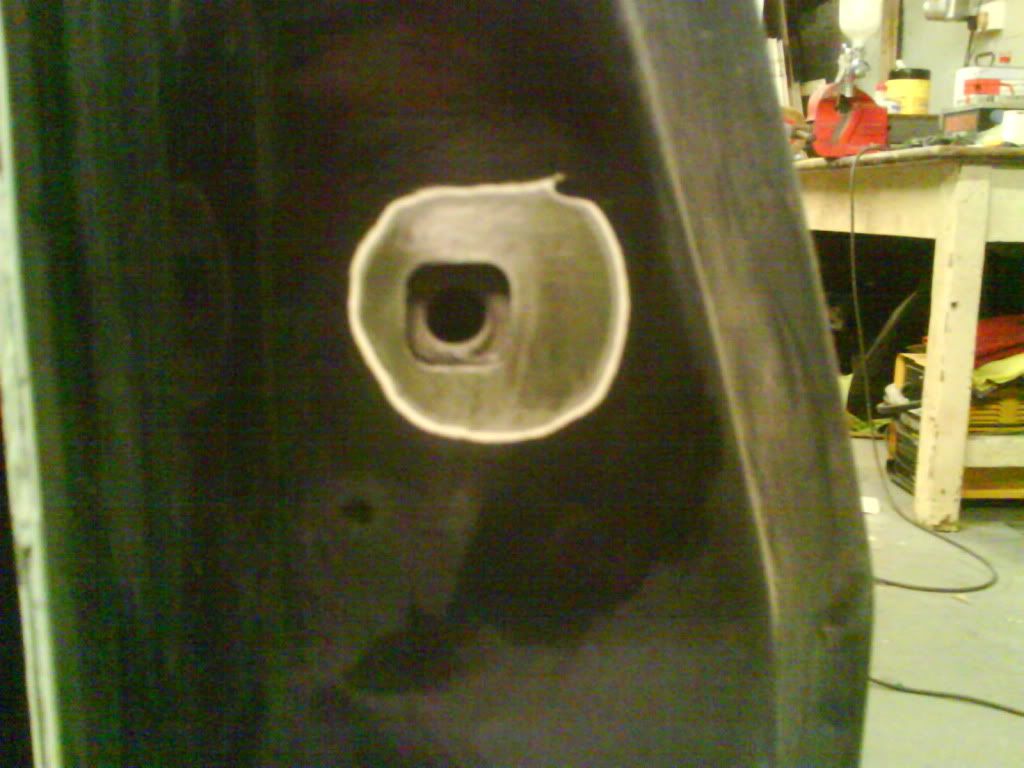

heres one hole,
forgot to take a pic of it welded up,
heres the otherside, has 2 holes, ones on the corner
had to make up a peice with a curve in it to match,
heres it done

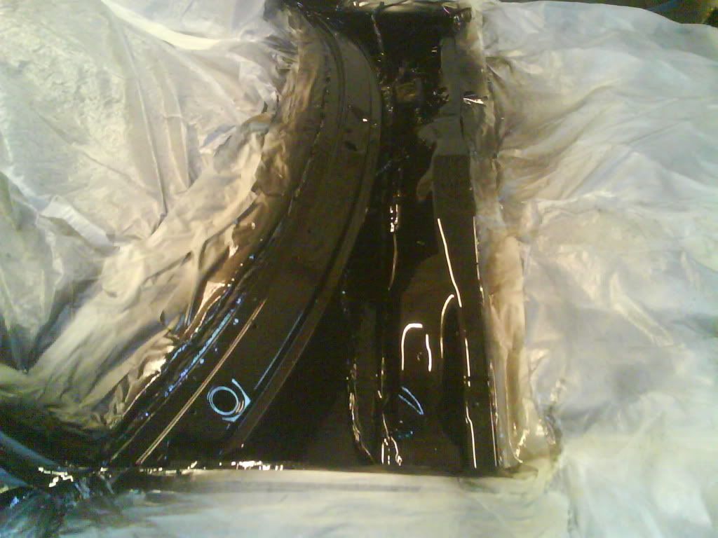

for the time being i had some kurust lying around so i thought ah!
might aswell use it! , atleast rust aint comming back whilst im doing other things, when im ready for filler {to level with the old paint,}and primer ill sand off the kurust back to bare metal to avoid the chance of it reacting with me primer and for the filler to stick to metal and not some water based paint!!!! aka kurust
next need to prep the roof,need to drop the sunroof, all the headliners been removed {had to for welding} so shouldnt be hard, might aswell service the linkages etc for it at the same time, then need to level off the paint where the scabs were, then primer!!!!
looking forward to it ! :)
went abit off course today, instead of doing the roof i started preping the scuttle tray for some fresh paint! it was looking dull and i wanted to do it at some point anyway, so nows the perfect time i recon, going to clean up the wiper motor and the vin plate, which ill re rivet back on,
left some wires in as it would be a pita to put them back, will be easy peasy to spray around,

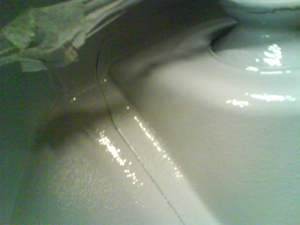

again all primer is 2k high build,
smoothed off the old scabed areas level with the old paint, PITA!!!
finnaly the first bit of Black Magic!!! realy happy to see it! its not the best but its a scuttle tray! and the rest of that is covered by trim peices, almost ready for paint on the rest of the car aswell!

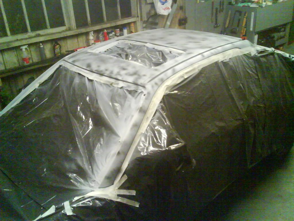

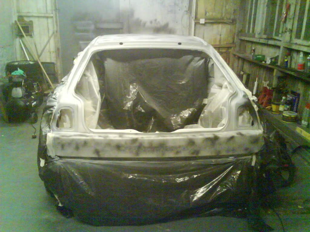

ah shes in primer! :)

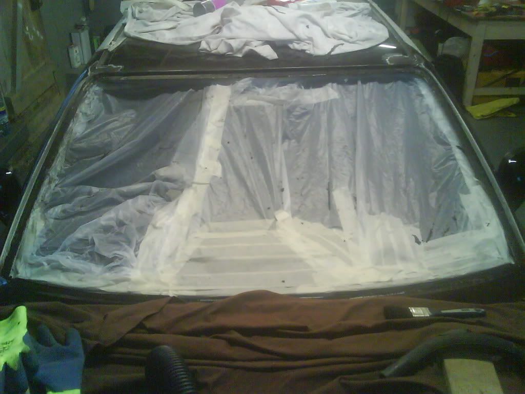

in the next day or 2 im going to have the realy fun job of sanding it all back smooth,
seriously i cannot stand sanding!! im sick to death of it! realy cant wait till
i dont have to do it anymore!!! almost there tho :)

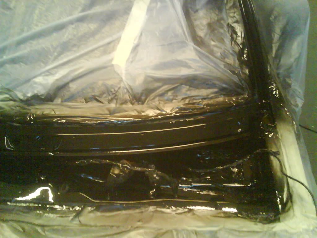

after the sanding it'll be time for a big clean up,
and make a diy spray booth out of clear polythene sheets
going to rigg up an extractor fan which will be an old rad fan from a golf rigged up
to a battery, :)

iv decided to skrew metalic black! im going for " more is more! " and with that, its going urban camoflauge!!!
still need to add some shade to it,
looks sick huh?!!!!

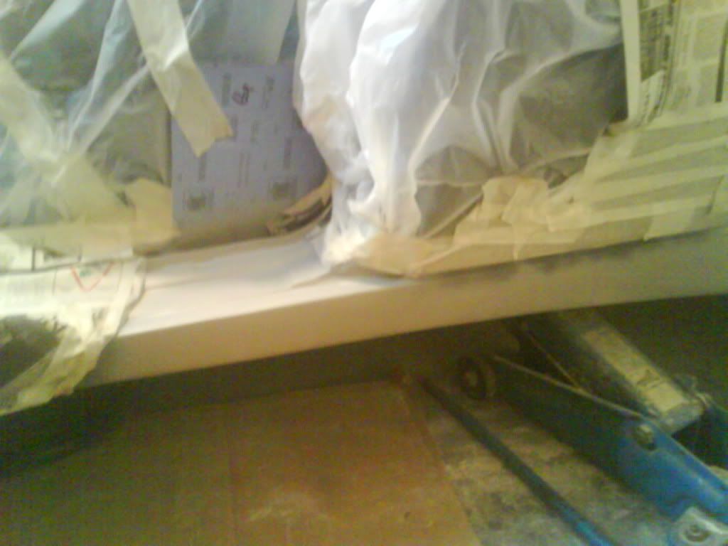

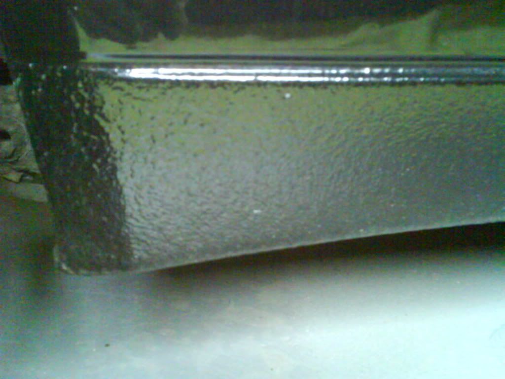

finished off the prep on the rocker/sill aswell,
i used u-pols gravitex to get the oem stonechip finish on the rocker, and im very pleased with how it
turned out, once it dried i coated over it with 2k primer ready for colour ;)
also decided that im not going to even try and blend the clearcoat in on this side, instead im gona do the whole
side in one!!! also from the previous paint job you could see a hard paint line from where they masked off the quarter glass seal,

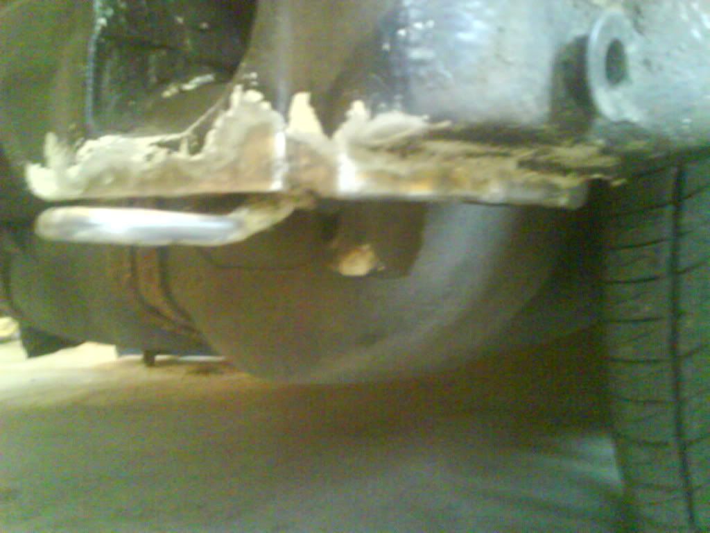

so i thought best remove it!
wasnt actualy hard to remove suprisingly and came out undamged , just took around 2 and a half hours with a stanley knife and crafts knife,
you cut from the inside and the vertical section by the door shut is cut from the outside by lifting up the seal and stabbing the glue
several hundred! times, just aswell as i came across some rust :)

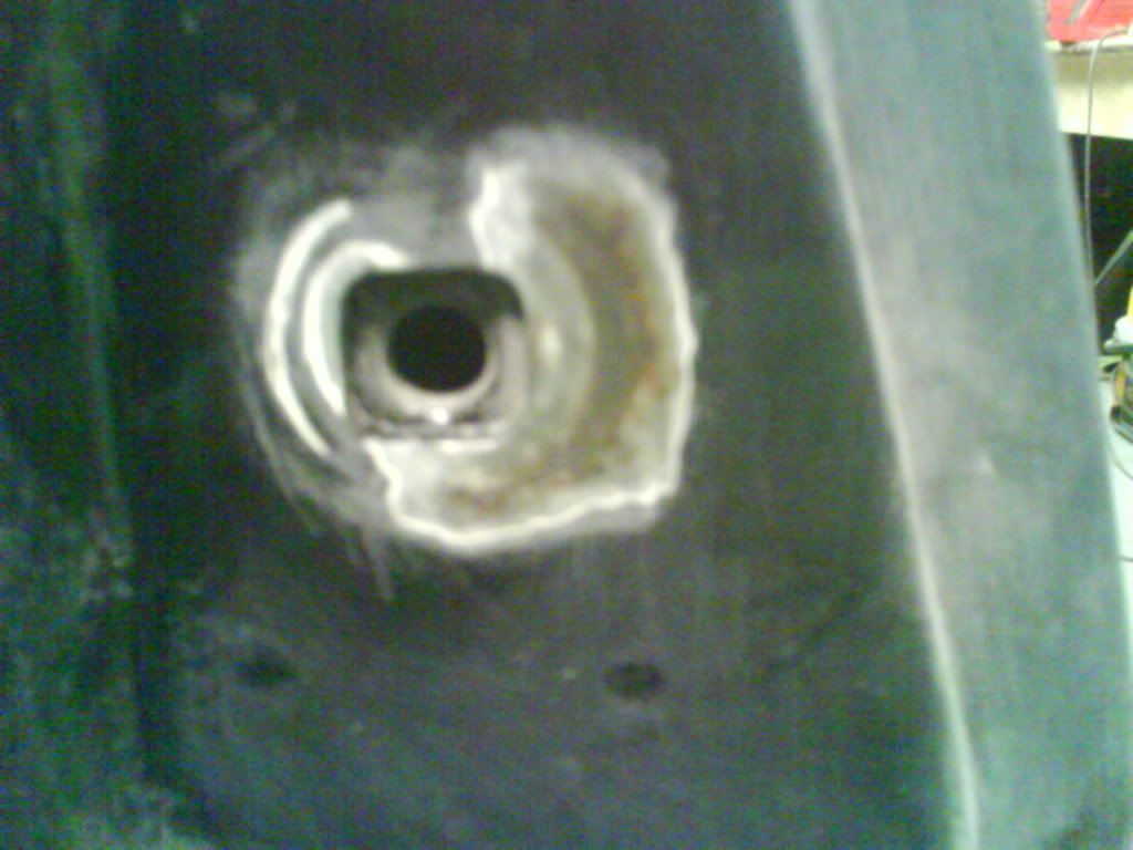

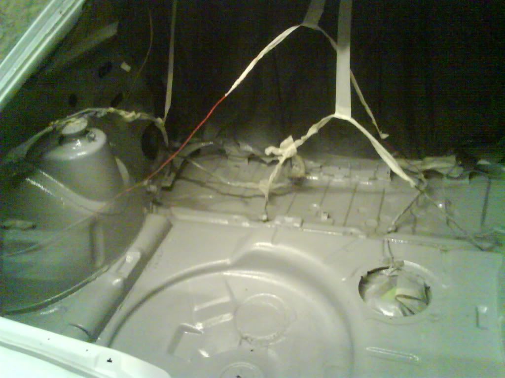

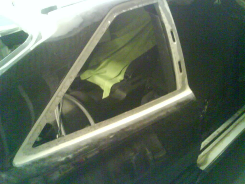

decided to tidey up the inside and use the left over gravitex, seeing as you cant see it, i didnt go mad with the prep,it didnt turn out amazing but its ok for what it is,one of the benefits of gravitex is sound deadening, so its perfect for here,
also removed the drivers rear quarter window as iv now decided to just spray the shell in one without blending the clear coat into the existing clear, i didnt want to find that i cant get the blend to look right and end up doing the lot anyway! so f-it do the lot to start with! supprisingly no rust!!
even small things takes time!, like this door latch! had a hard paint line and had rust comming through!

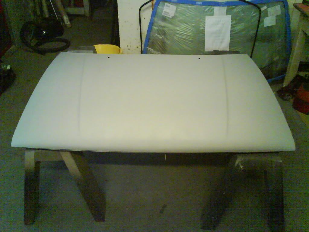

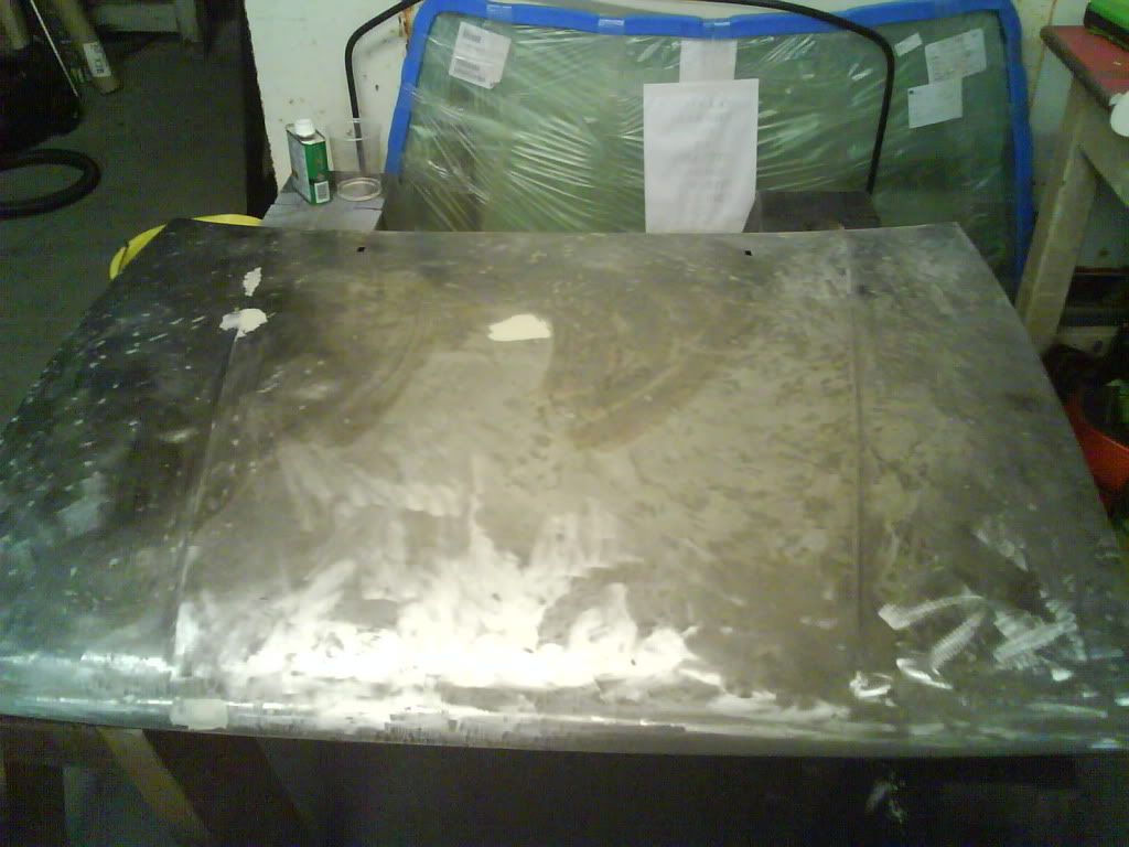

went abit loopy the other day and ripped the paint off me bonnet! it was my first real spray peice,
and at the time of fixing the ring repair i didnt know about the "guide coat " technique when sanding, so as a result at the right
angle you could see slight waves, it wasnt bad but i knew it was there! and i know i can do better .
ran out of of primer :( still needs another 3-4 coats then guidecoat and sanding! then colour and clear!
