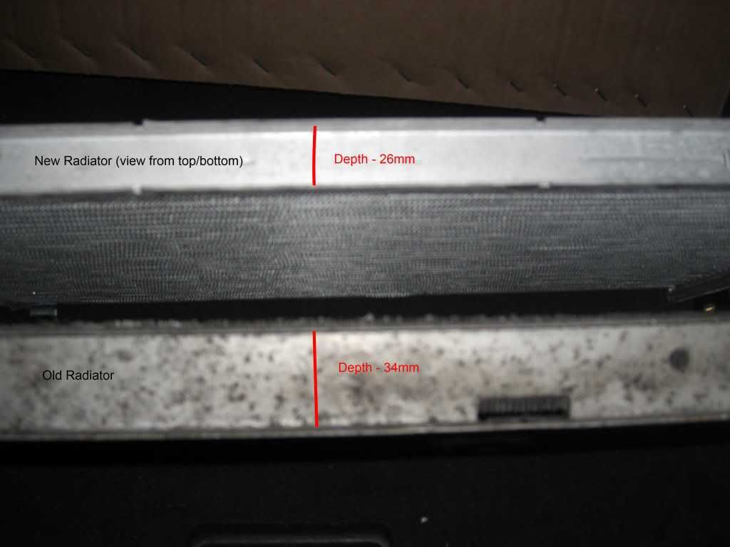

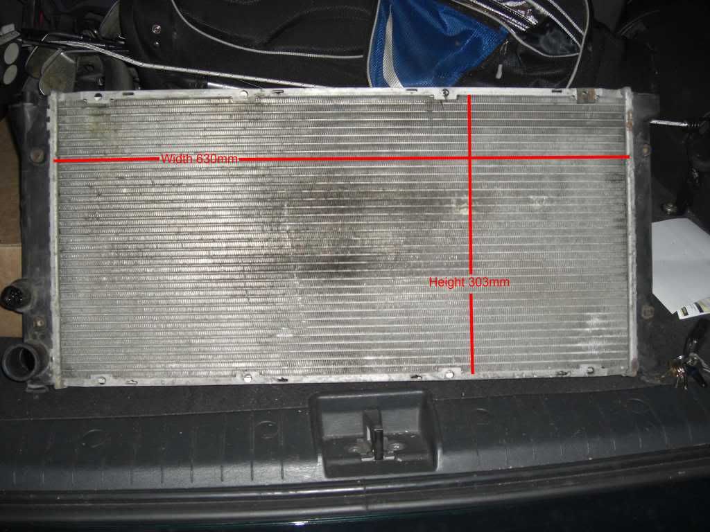

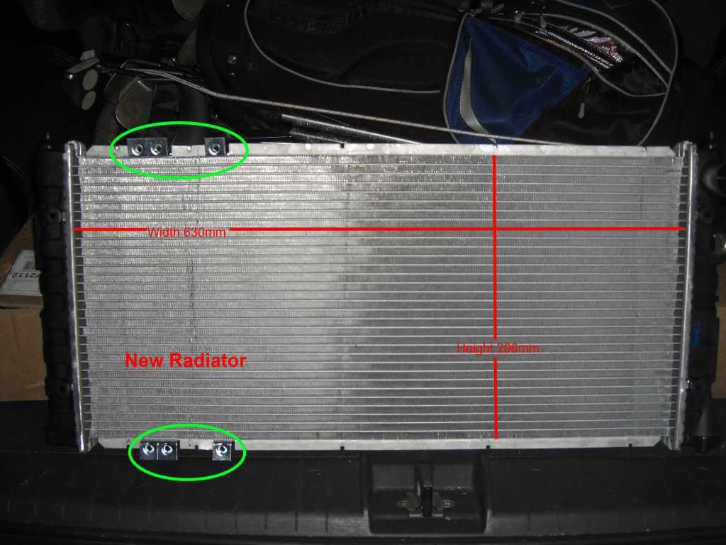

Furno 0 Posted July 25, 2011 Robbo - know how you feel re one job leading to another. Got round to fitting my new rad today, but not convinced it the right one - probably better to splash out on the VW one. I've attached 3 photo's showing old and new rad. Couple of questions: 1. There is a big difference (32mm v 26mm) in the depth of the 2 rads. Are new rads that much better than their 16 year old counterparts which makes this nothing to worry about, or is this just another economy measure to keep the cost down that will ultimately make it inferior to the real thing? 2. What are the brackets circled in green on the new rad for? They stop the fans fitting properly. Cheers. Cheers. Steve Quote Share this post Link to post Share on other sites
Robbo149 0 Posted July 26, 2011 TBH I didn't measure the new one I got, but it looks the same as yours. I did have to do a bit of tweaking of those brackets to get them to sit inside the fan shroud, but once that was done & the fans were on, it fitted perfectly. My old rad had the brackets on too. HTH, Robbo Quote Share this post Link to post Share on other sites
tony_ack 0 Posted July 26, 2011 I'm pretty sure the replacement VW rad I used was the same size as the original. Genuine rads come with the top elbow already attached, but I think they're now obsolete Quote Share this post Link to post Share on other sites
