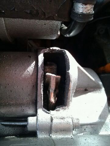

rubberdubber 0 Posted October 9, 2011 a mate of mine bought a g60 yesterday, unfortunately on his way home the supercharger went boom. hes not registered on here yet so has asked me to put a post up for some advise, basicly why has this happened? blocked oil feed or just worn out? obviously it looks like its going to need a new supercharger, any advise on the best ones to purchase for reliability and cost? cheers Quote Share this post Link to post Share on other sites
Sam.l 0 Posted October 9, 2011 Did he have any service history or any proof of the charger being rebuilt in the past? Even though the engine itself is pretty bulletproof, the charger needs to be looked after and rebuilt/serviced every 15 to 30ish thousand miles depending on it's state of tune and from what it looks like it hasn't been rebuilt recently, the bearings and seals inside the casings have died and coincidentally charger goes pop. Check the oil feed line coming from the right side of the head to the right hand side of the charger, if this has died then the charger would have been starved of oil. even with all this does not change the fact you're gonna need a new charger as that is not repairable. You're probably looking at about 350-450 for a good condition/recently rebuilt charger second hand on the forum possibly, or give companies like g-werks or jabbasport a call as they stock their own rebuilt chargers. You won't be able to get one from the dealers anymore as they are obsolete (I think!) sad news, that sucks! Good luck mate. Quote Share this post Link to post Share on other sites

jaded2882 0 Posted October 9, 2011 Should really get the pipes, throttle body and engine checked for bits of metal too. Quote Share this post Link to post Share on other sites

Supercharged 2 Posted October 10, 2011 He'll need to clean out the whole boost system before he fits it! Quote Share this post Link to post Share on other sites
rubberdubber 0 Posted October 10, 2011 yeh hes going to remove all the pipes and inlet manifold, hopefull nothings slipped into the bores!!! Quote Share this post Link to post Share on other sites
jbcorrado 0 Posted November 29, 2011 I had that happen to me. A brand new NOS g60 blown up. The little oil line to the charge clogged up :( Quote Share this post Link to post Share on other sites

Supercharged 2 Posted November 29, 2011 I had that happen to me. A brand new NOS g60 blown up. The little oil line to the charge clogged up :( Which is why G-werks etc always recommended changing the oil feed too! Quote Share this post Link to post Share on other sites
