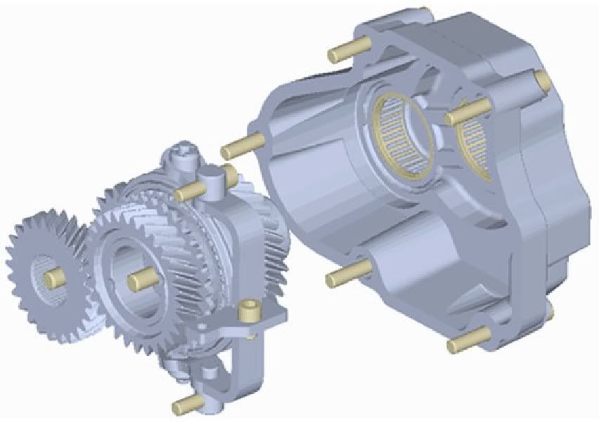

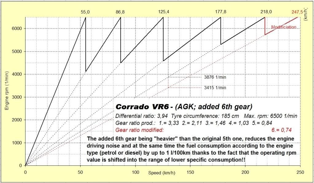

corrado9a 0 Posted December 18, 2011 You know this ? http://www.eurotuning.cz/images/file/conversion_kit.pdf I got in touch with them. It looks a fairly cheap mod, plus a 3.94 R&P, and a LSD would do a killer transmission. with a 3.95 final gear and a tdi 6th would be close to oem gearing in 6th while having short gears for moutain driving. I am toying with the idea of selling my VFE stage 3 for this tranny Quote Share this post Link to post Share on other sites
