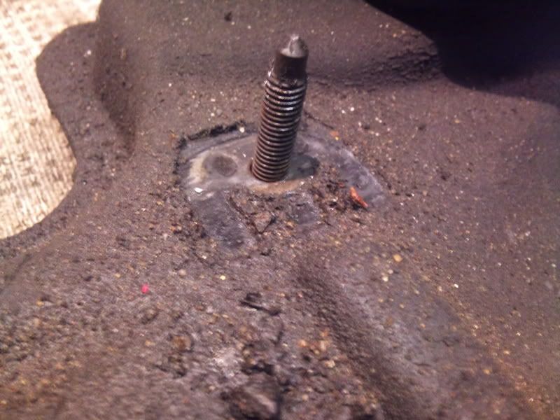

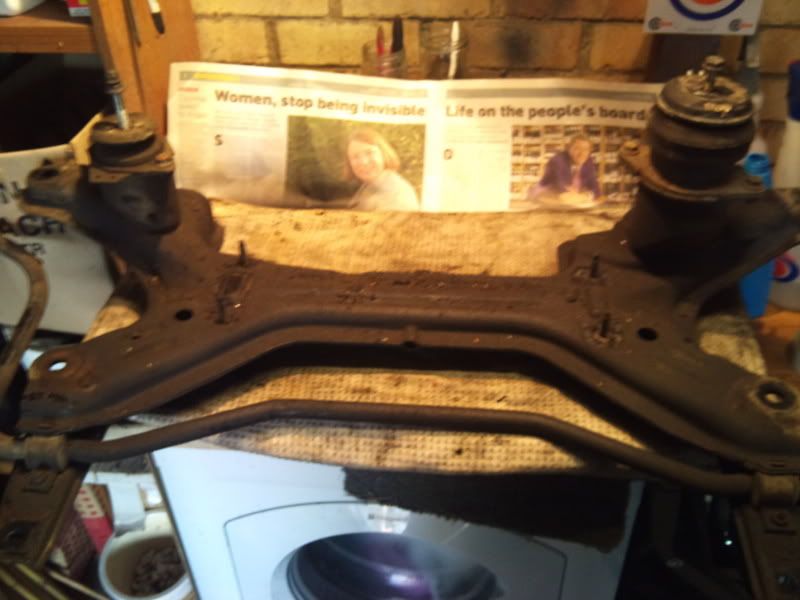

Jim Bowen 1 Posted April 9, 2012 Am having trouble getting them out of subframe, i didn't want to whack them with a hammer and damage them if they aren't meant to come out, but am sure they should ^^^a nice coating of oil on the subframe :! Quote Share this post Link to post Share on other sites
floppyman 0 Posted April 9, 2012 I dont think theyre meant to come out Quote Share this post Link to post Share on other sites
STU175 0 Posted April 9, 2012 mine didnt come either Quote Share this post Link to post Share on other sites
Jim Bowen 1 Posted April 9, 2012 will have to sand blast around them then, not much corrosion in those areas anyway Quote Share this post Link to post Share on other sites
tonedef 9 Posted April 9, 2012 I whacked mine with a hammer..........they did come out! Quote Share this post Link to post Share on other sites
daleyboy 0 Posted April 10, 2012 I think they are designed to stay in even if the nuts come loose, so that it keeps the rack in its rough position so you dont lose steering.......... :thumbleft: Quote Share this post Link to post Share on other sites

Gti_Jamo 10 Posted May 23, 2015 It's rust that stops them from coming out. Quote Share this post Link to post Share on other sites
