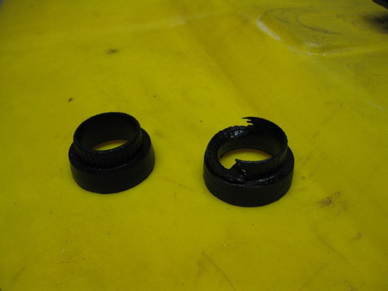

mattwelcer 0 Posted June 27, 2012 Well not been able to fit it, borrowed the special puller tool (its a Mk3 Golf) everything came apart but there is a "support ring" behind the steering lock unit which is completely crushed on one side and might explain why i have some play in the steering wheel. So new part ordered but won't be here until this afternoon... Quote Share this post Link to post Share on other sites
