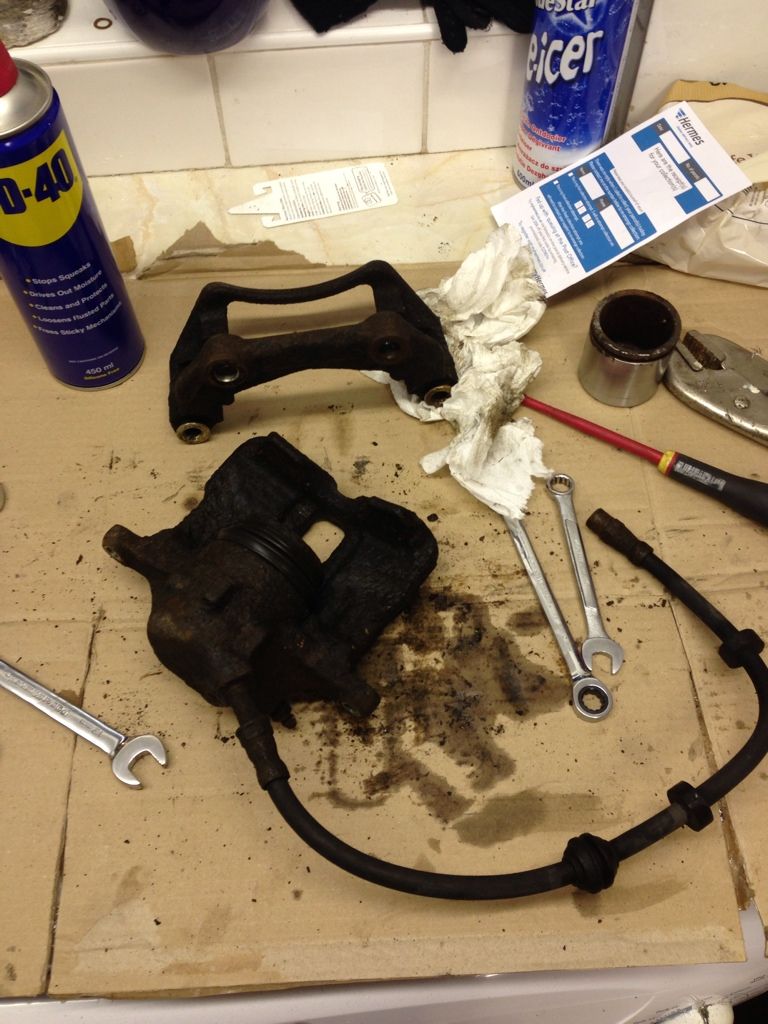

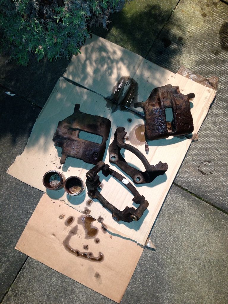

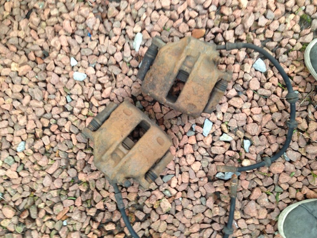

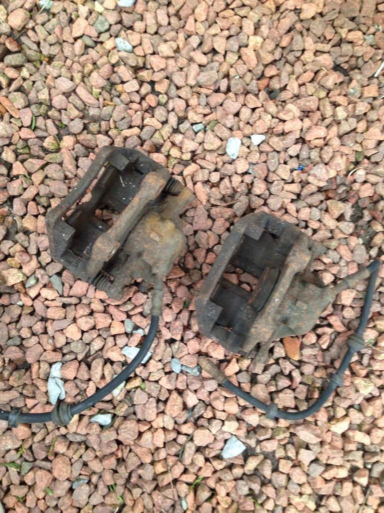

Got a set of front calippers for pennies so got to work stripping them down ready for a nice powder coat before I do a rebuild (I was looking for a cheap set of used rears but couldn't find any so removing them from the car next week so will update when I gt that done)
First of all it was time to get the wire brush out and give the calippers a rub down to remove years of grime before I started to strip them down..........
Next Onto the bench to be stripped, slider bolts came out no problem at all but the bleed nipple and pistonss were another story, eventually got the pistons out with a set of mole grips (I'm replacing them anyhow) and then the rounded bleed nipples were removed with the trusty moles.
All parts stripped and ready to go to the powder coater.
Just need to remove the rears now and get them stripped down so I can drop all the parts off together......

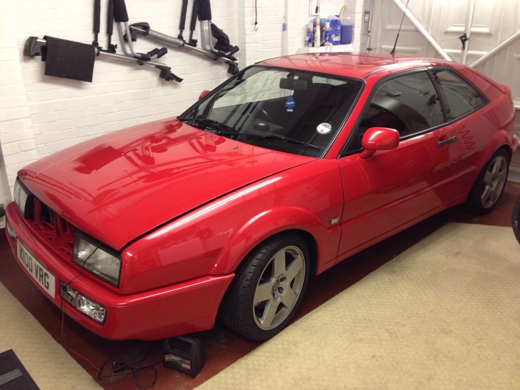

Of course no post would be complete with the obligatory shot of the car in the garage.
Again I forgot the camera so forgive the phone pics.
Rob
Sweet valley high, that car looks spotless! Nice...

Refurbished a set of calipers myself a little while ago. The ones I bought from off this forum were in a sad state and I was never going to put them on the car in the condition I got them in. So I fully refurbed them with new seals, pistons and bleed nipples. I hope you're going to at least use new seals? Not worth putting them on your pride and joy only to discover that your brakes don't work when you need them to......
http://the-corrado.net/showthread.php?65485-Finally-taken-some-pictures-of-my-VR6/page2
Driver vr6 all of the seals have been removed in the images so yup being rebuilt with new seals :-)

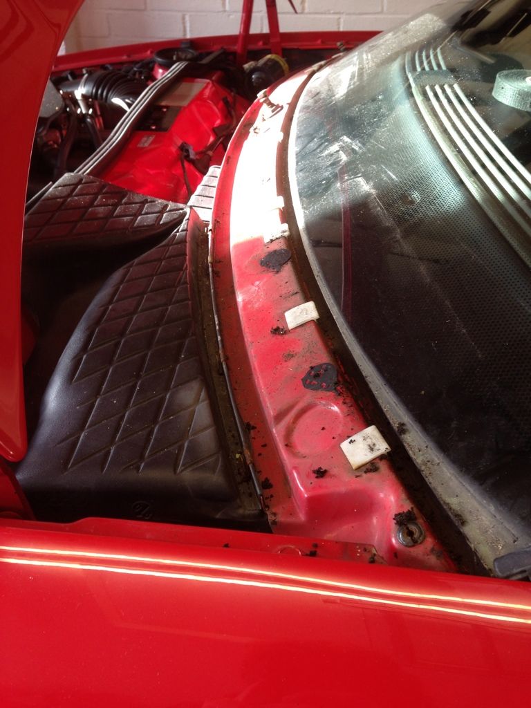

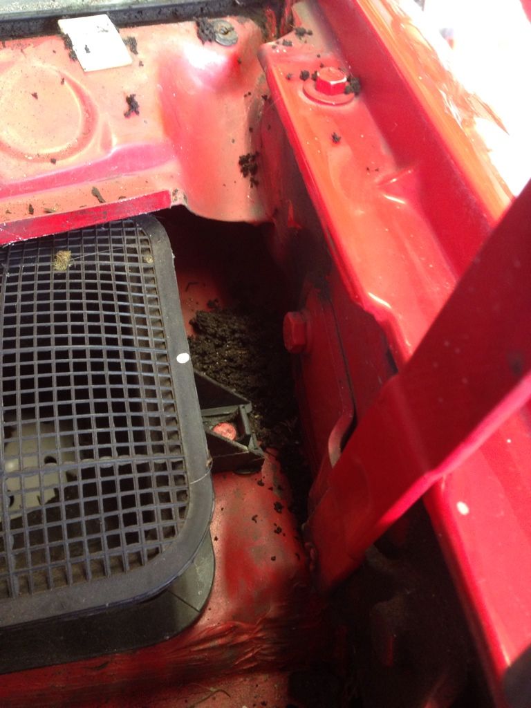

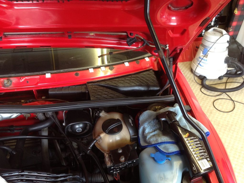

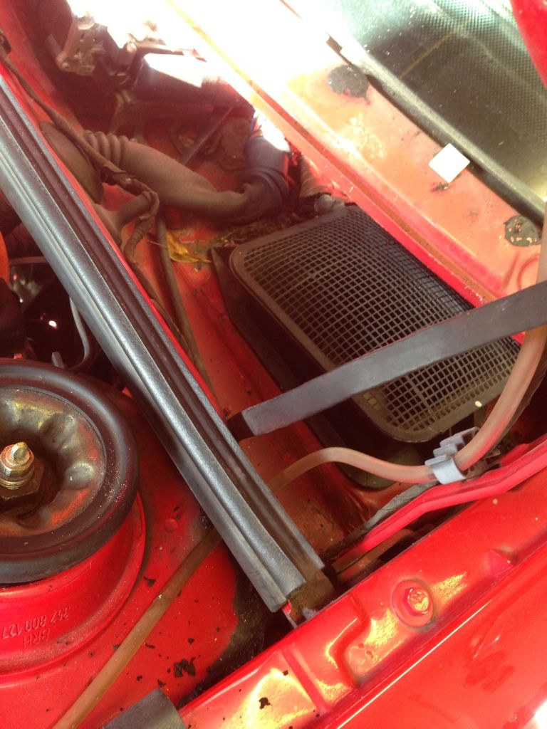

Removed the scuttle and found a filthy mess of soil and leaves that had to be cleaned out
Plenty soil sitting above the scuttle drain also.

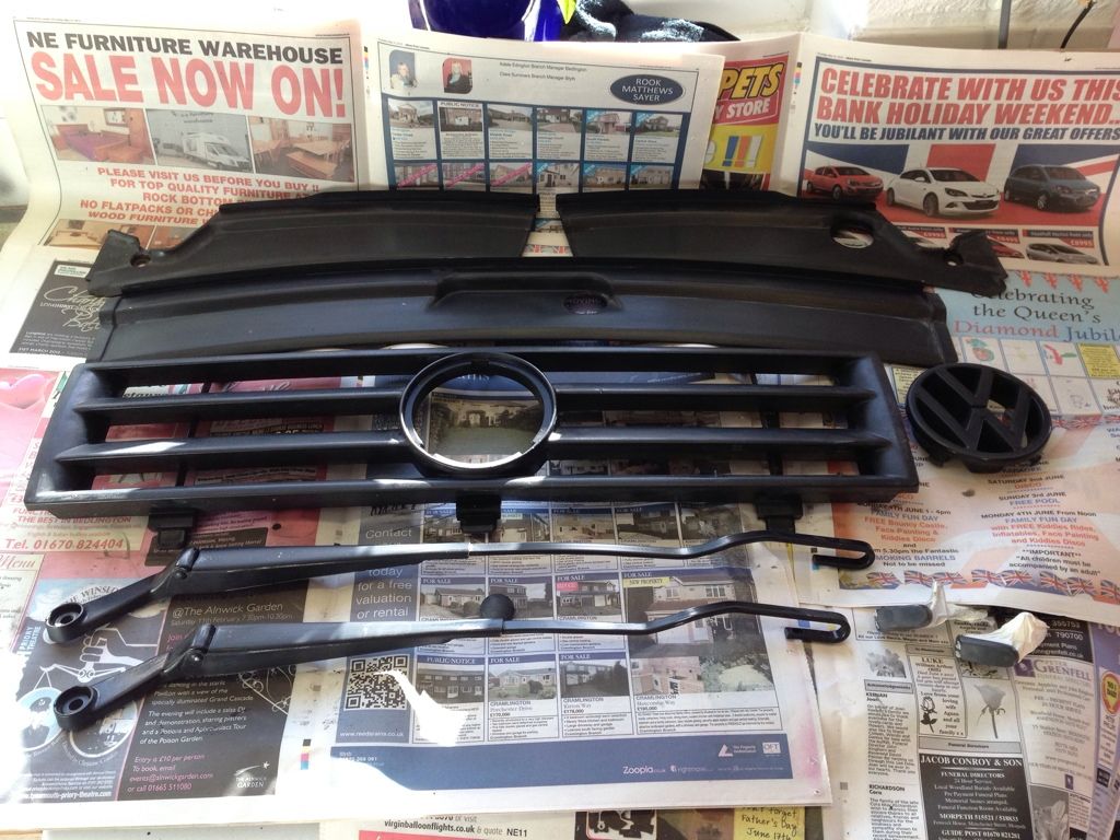

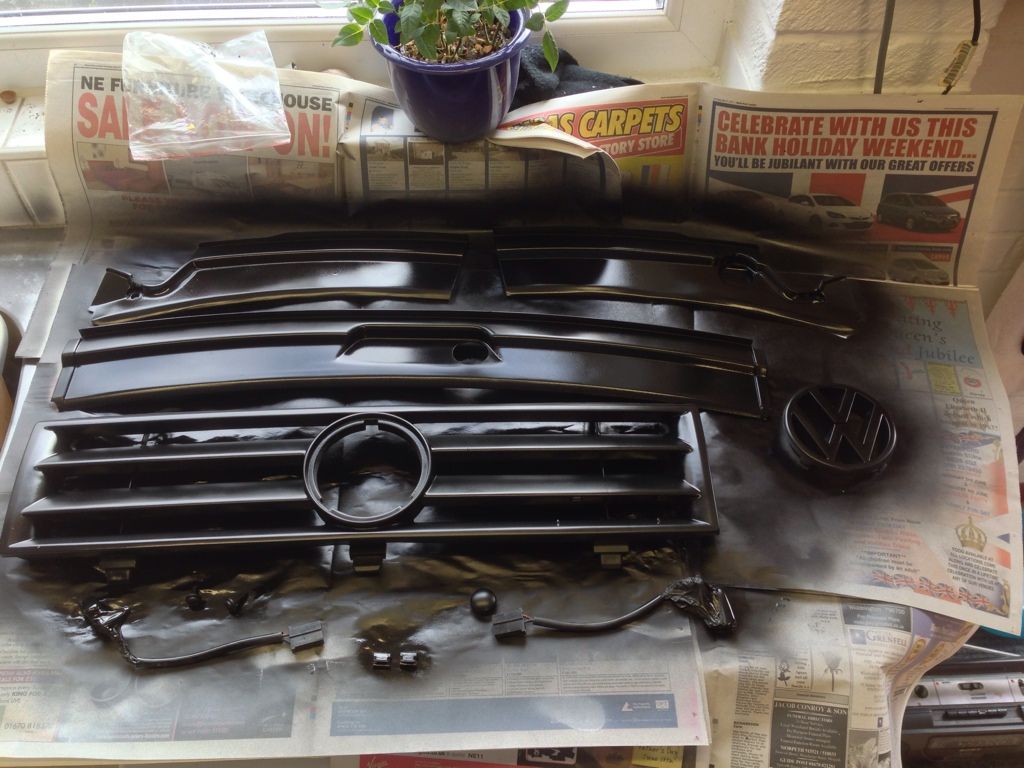

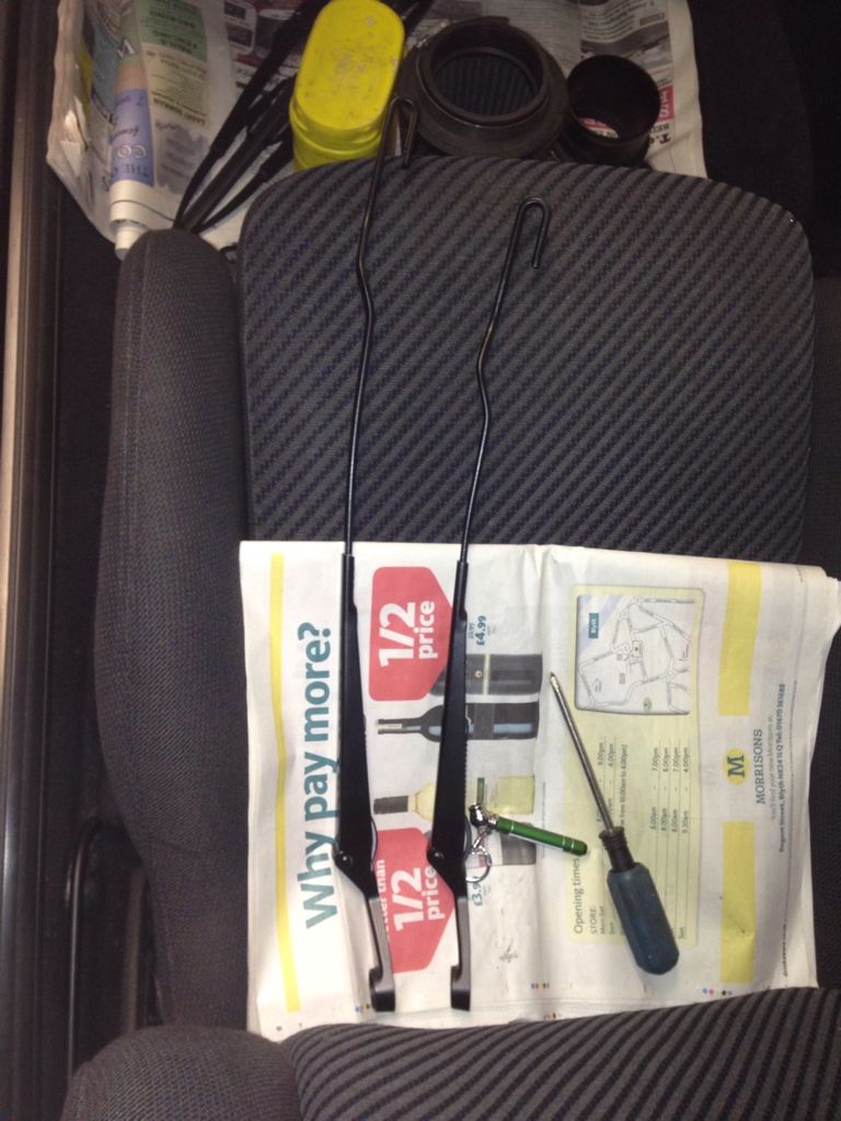

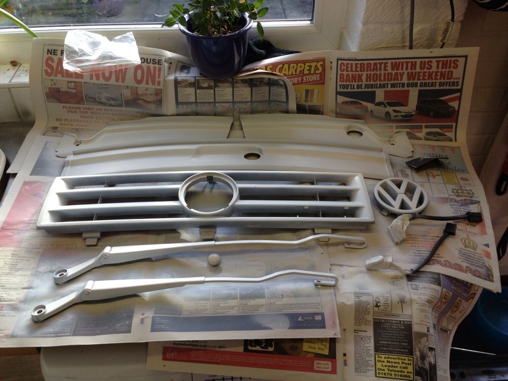

All the plastics and wipers that had been removed were then rubbed down with wet & dry.
A good coat of primer was then applied, note the amazing masking ;-)
Whilst the primer was going off the ecu cover was removed and cleaned along with the scuttle (pic still shows the mastic that was used to secure it but this has since been removed)
Quick snap of the wipers in satin black once dry.
All the other plastics done in satin black, just need to get them fitted.
Not much going on I know but keeps the thread going.

On a side note, a number of people have had issues with their cooling systems because of the black cap, treat yourself to a blue one. Something to do with pressure relief issues....
Thanks mate, starting to look forward to getting her back together and running well so I can get out in the summer and drive her :-)
Do you mean a blue expansion tank lid? Are they a dealer part?

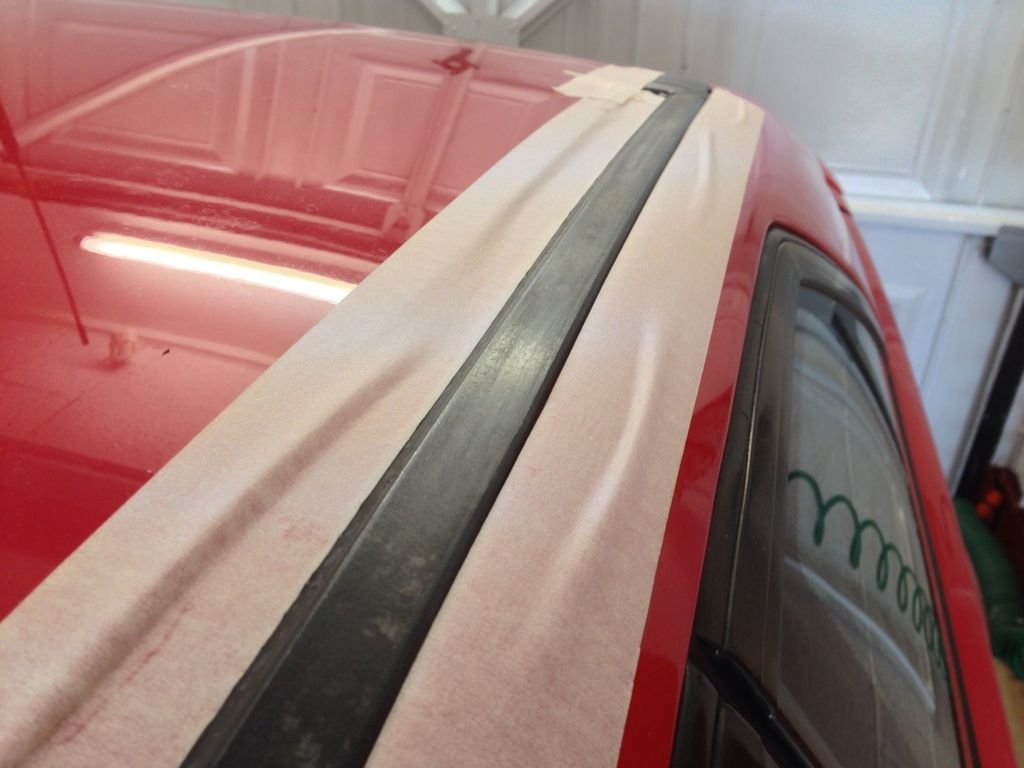

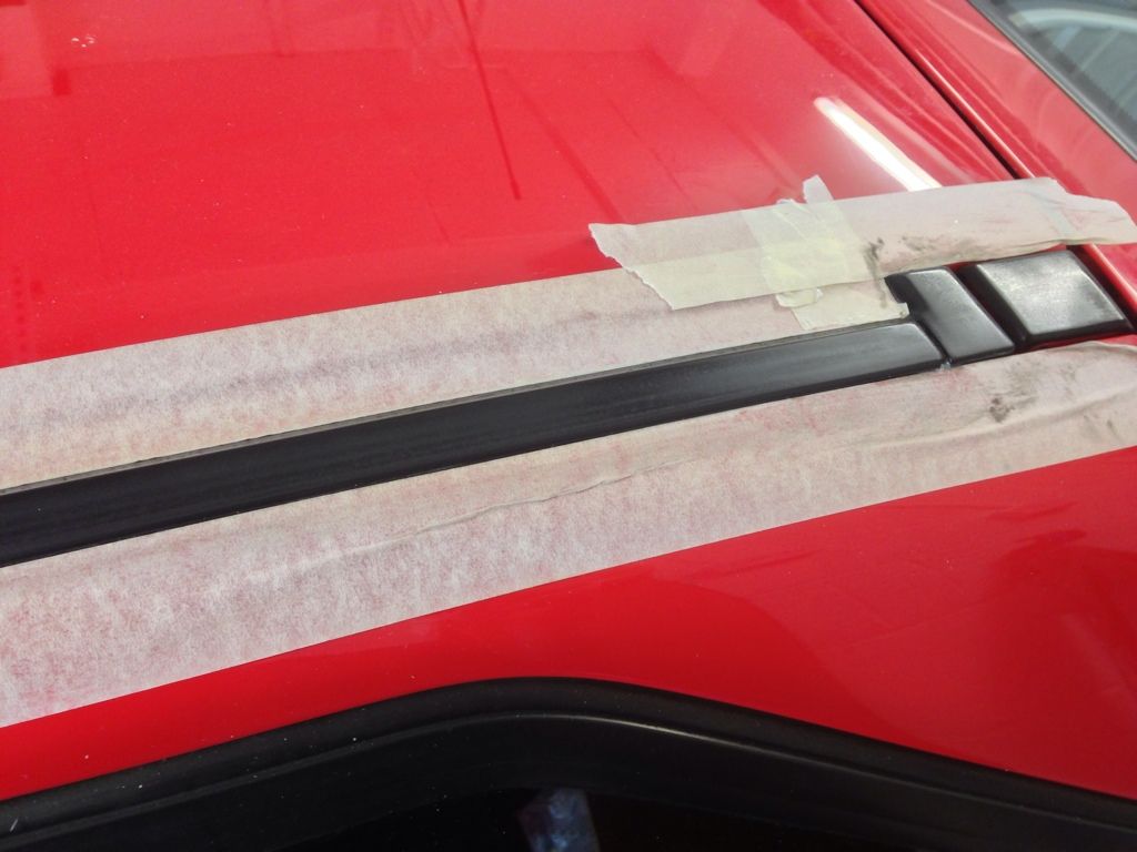

Got a little more work done today, I say little as its such a small change most wouldn't notice.......

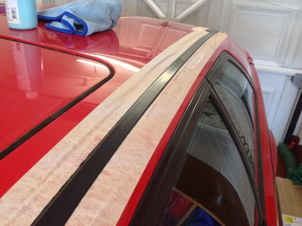

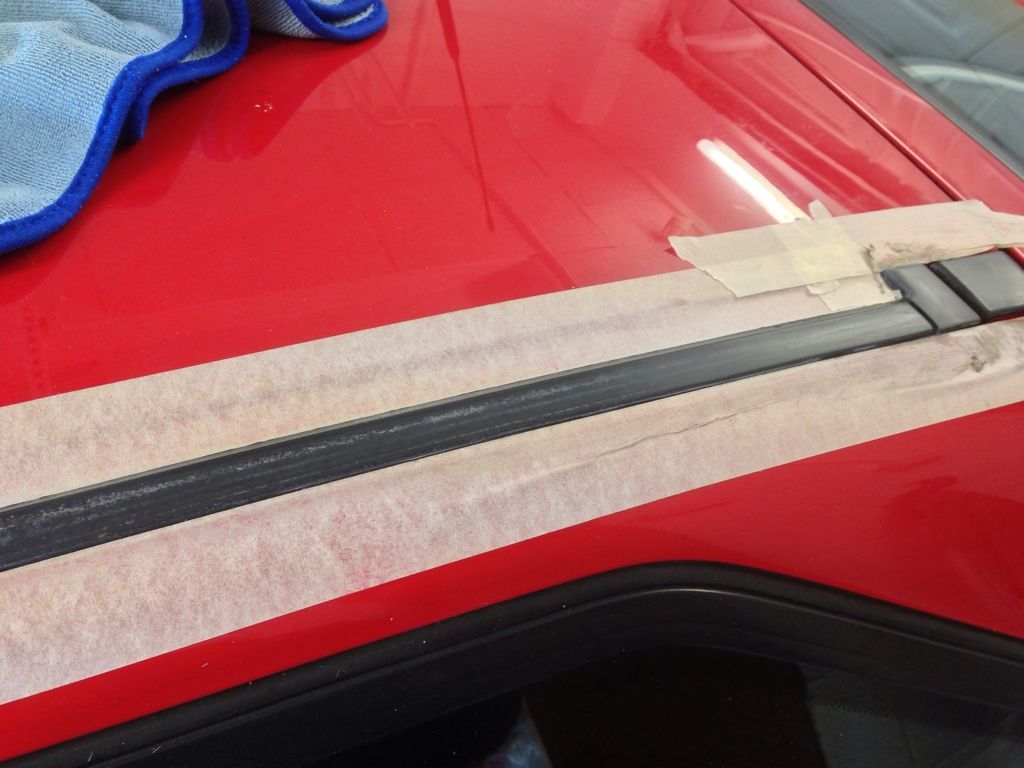

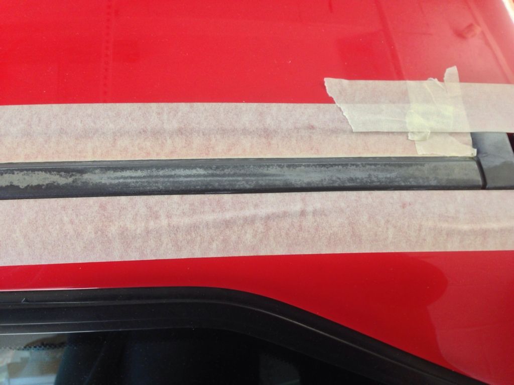

I decided to sort the black roof strips out as they were no longer black.
Before pic, looking pretty shabby and in need of some love, you can see how badly damaged the outer surface is in the first image.

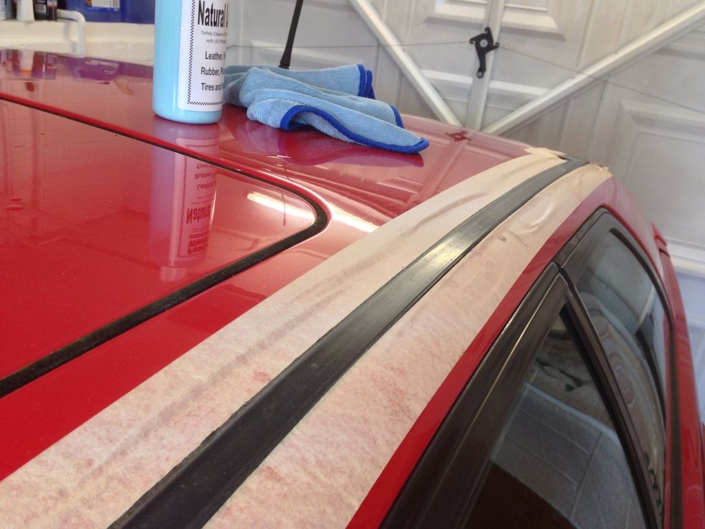

So gave the strips a good rub down with 800 then 1200 wet and dry lighty lubricated with water and this is how they looked. Still some minor pitting but much improved.

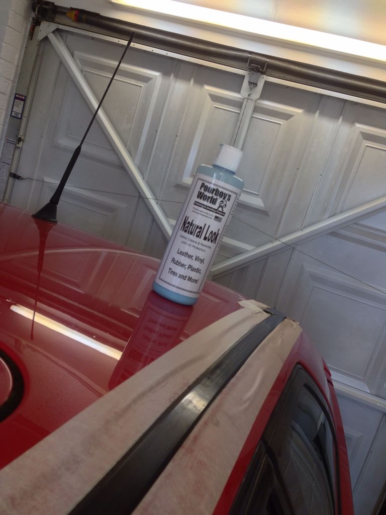

Next up it was time to treat and protect the strips, I used chemical guys natural look applied liberally and allowed it to soak in, this was done 3 times until the strips could not absorb any more and then they were buffed up with a clean cloth.
I'm pretty happy with the results although I might have another go with the 1200 to try lift a bit more of the damage out.
Obligatory pic of what I regard as the best plastic, tyre and interior product I've used.
