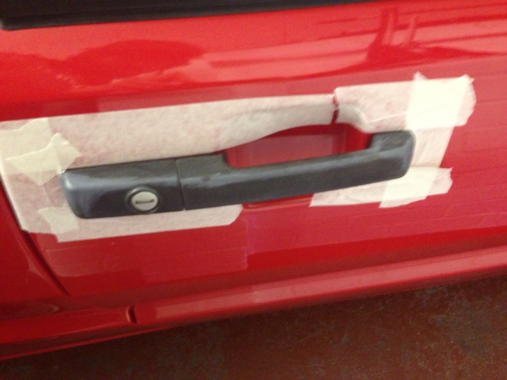

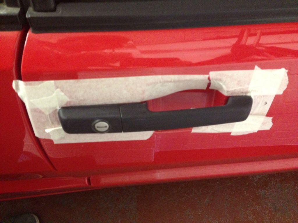

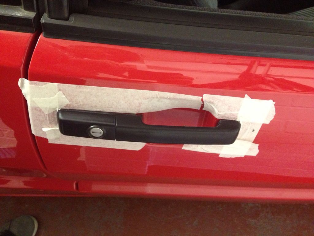

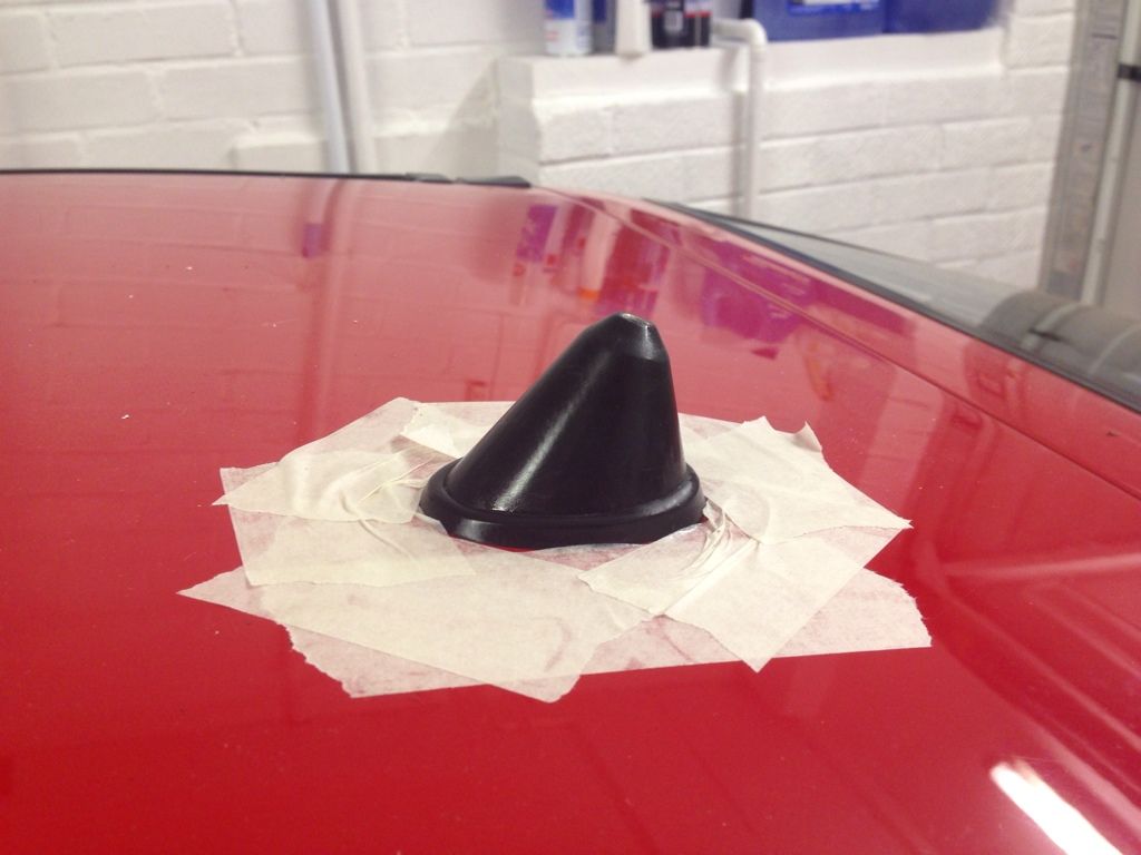

First up it was time to sort out the shoddy looking door handles.
First up a pic of the handle before I started.
Then a good rub down with 1200 wet and dry.
Now time for a few thick coats of poorboys natural look (I lay it on thick and allow it to be absorbed between coats and I love the results)

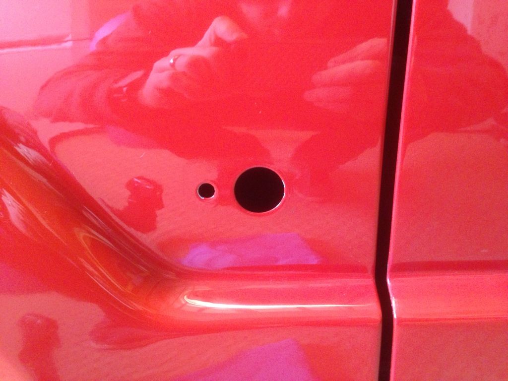

I did both sides with this method and the aerial base.

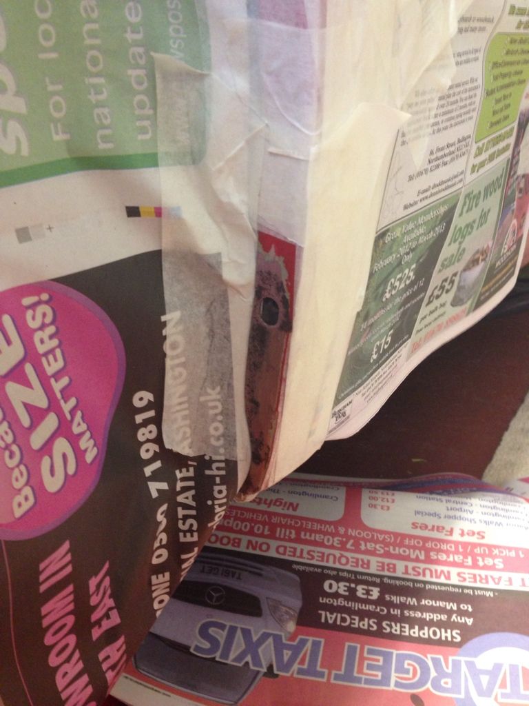

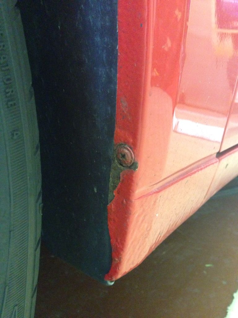

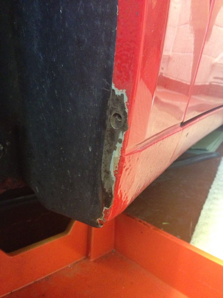

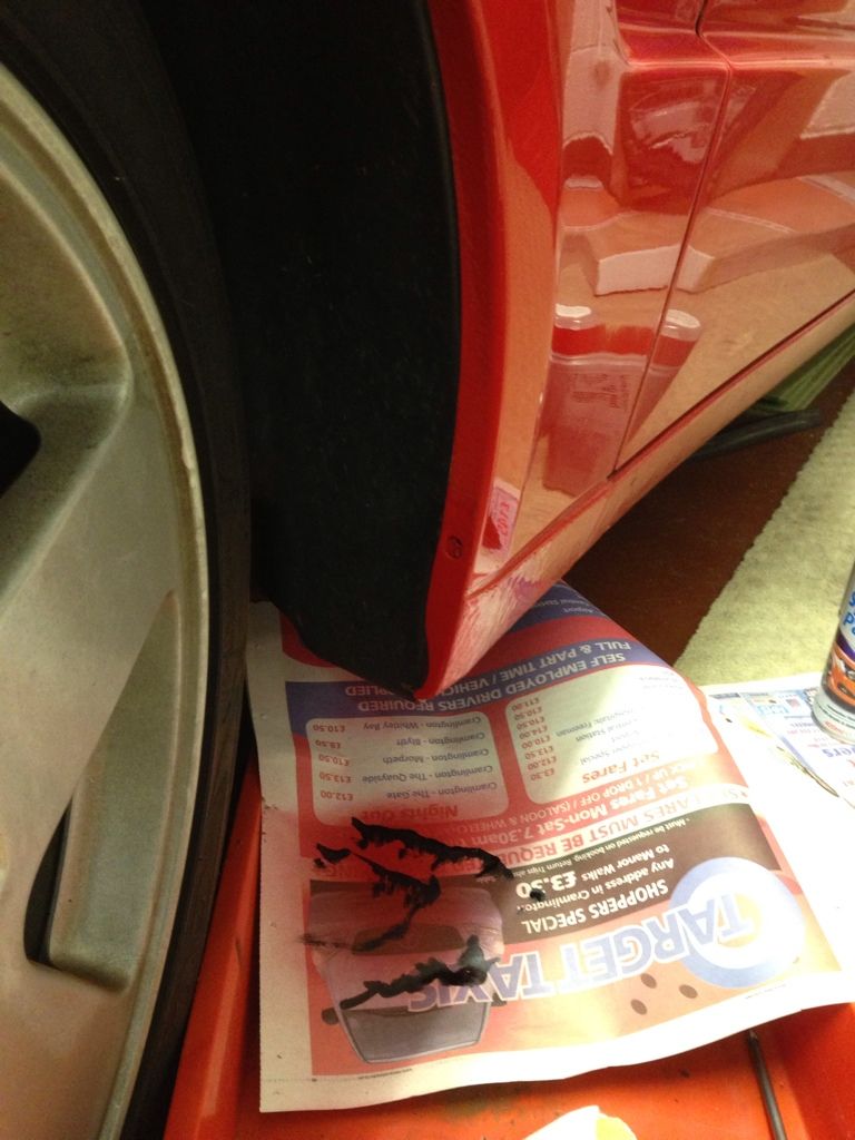

And now onto today's main event, the irritating rust bubble on the arch.

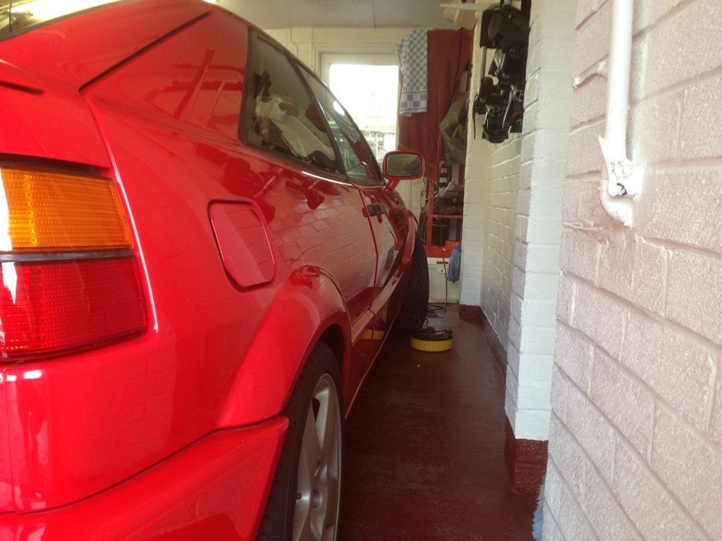

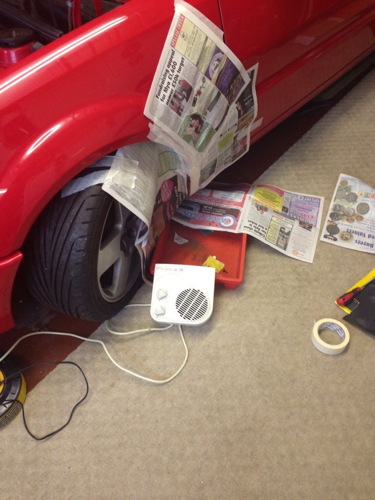

A quick pic of my amazing paint booth.
A pic of the arch before I started the work. The fan heater was used to keep the paint area warm duruing painting but was turned off when actually painting.
Then get rid of the rust with the dremmel and some wet and dry (pic was taken before I was finished rubbing down)

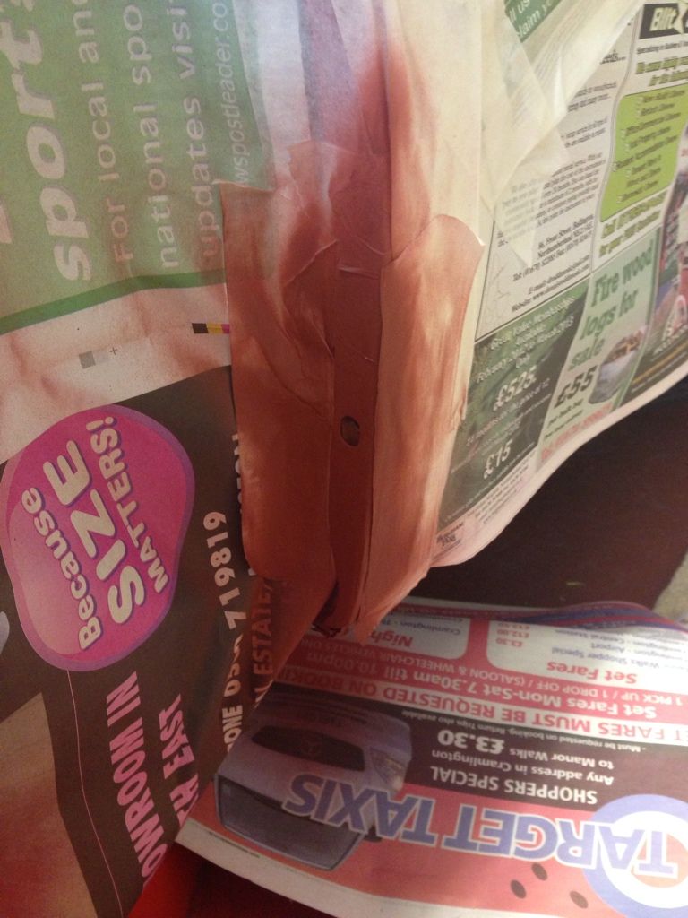

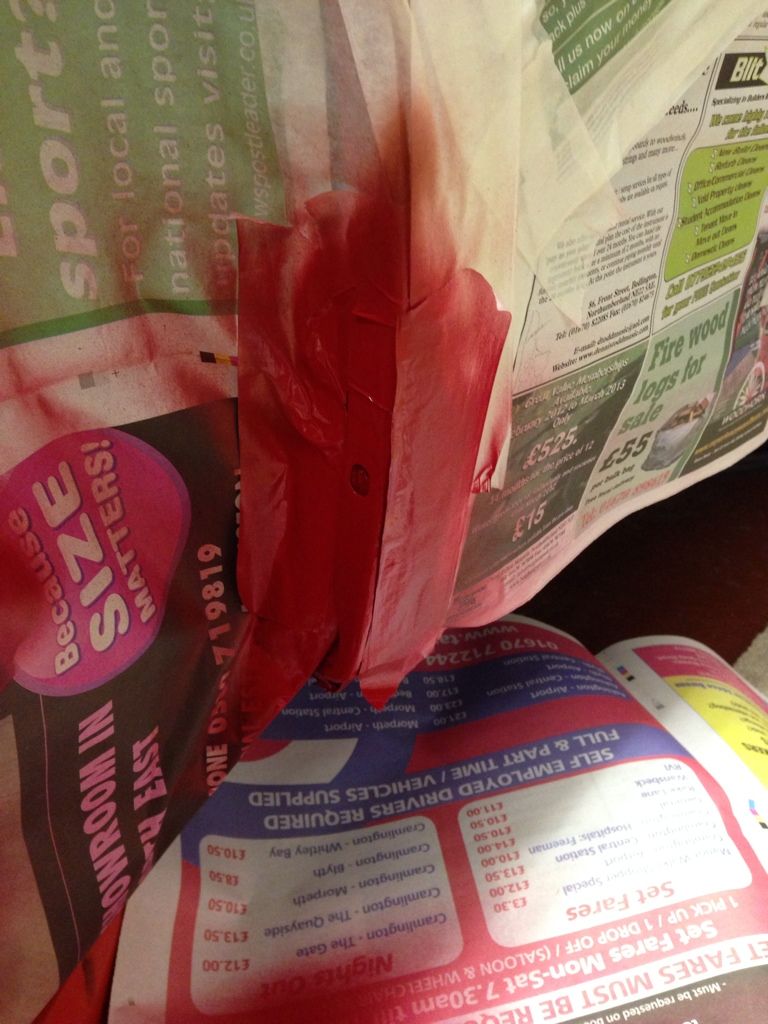

Get the area well masked up.
3 coats of primer were then applied and rubbed down with 800 wet and dry between coats.
I then applied several coats of paint to the area rubbing down with 1200 wet and dry between coats.
All of the masking was then removed after the paint had had plenty time to cure and the area was rubbed down and polished to blend in the old and new paint as well as possible, it's not perfect but it's good enough for a short term repair.

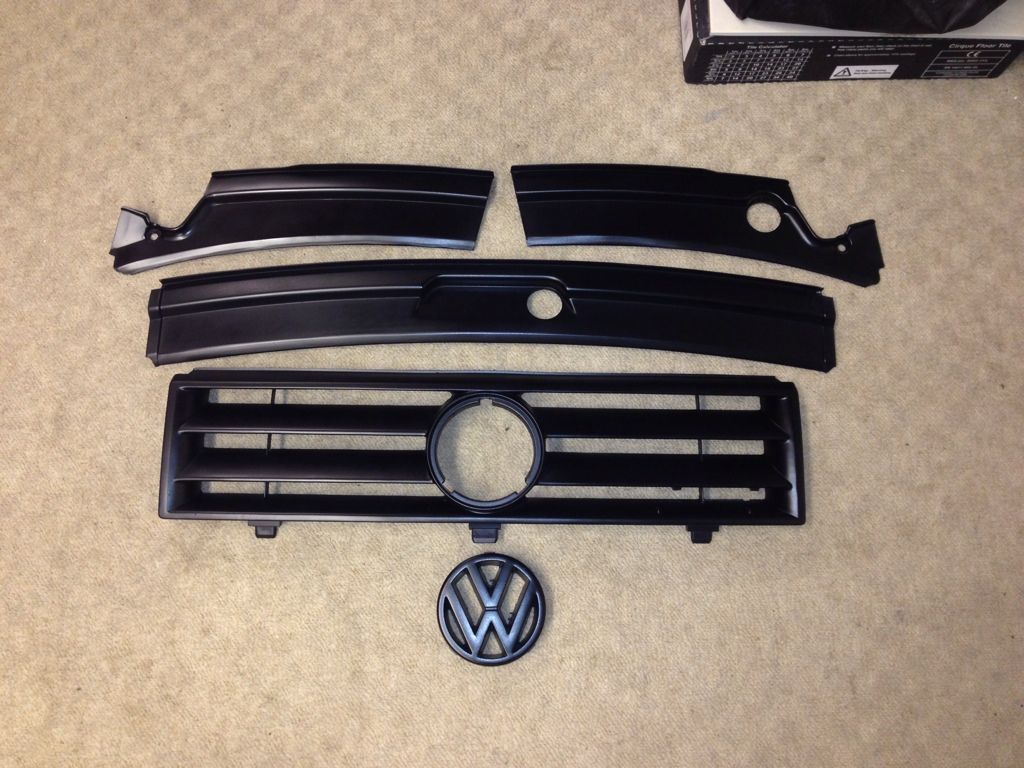

To finish off the day I got all of the satin black parts out and gave them a good polish now the paint had been given a few days to cure properly and this was the result.

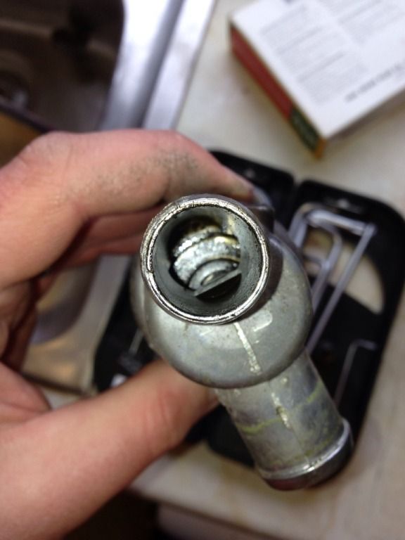

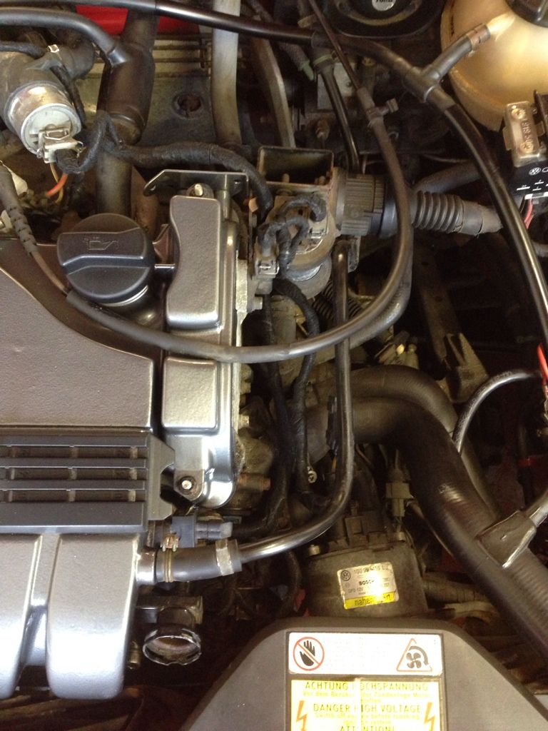

So I've tried to make a little more progress today with regards to the non running issue however my father passed away on Friday and this has caused me too loose it a bit, fill my van with unleaded and then fall down the flat stairs so all in all it's been a bad few days!
Today I managed to put weight on my ancle so I made the effort to get down to the garage and have a look at the fuel pressure regulator vac pipe as recommended by a few people. It's been a lcouple of days since I attempted to run the car so I didn't know what to expect, now there is no actuall wet fuel in the vac line however there is a strong smell of fuel when I sniff the line so I presume fuel has been present.....

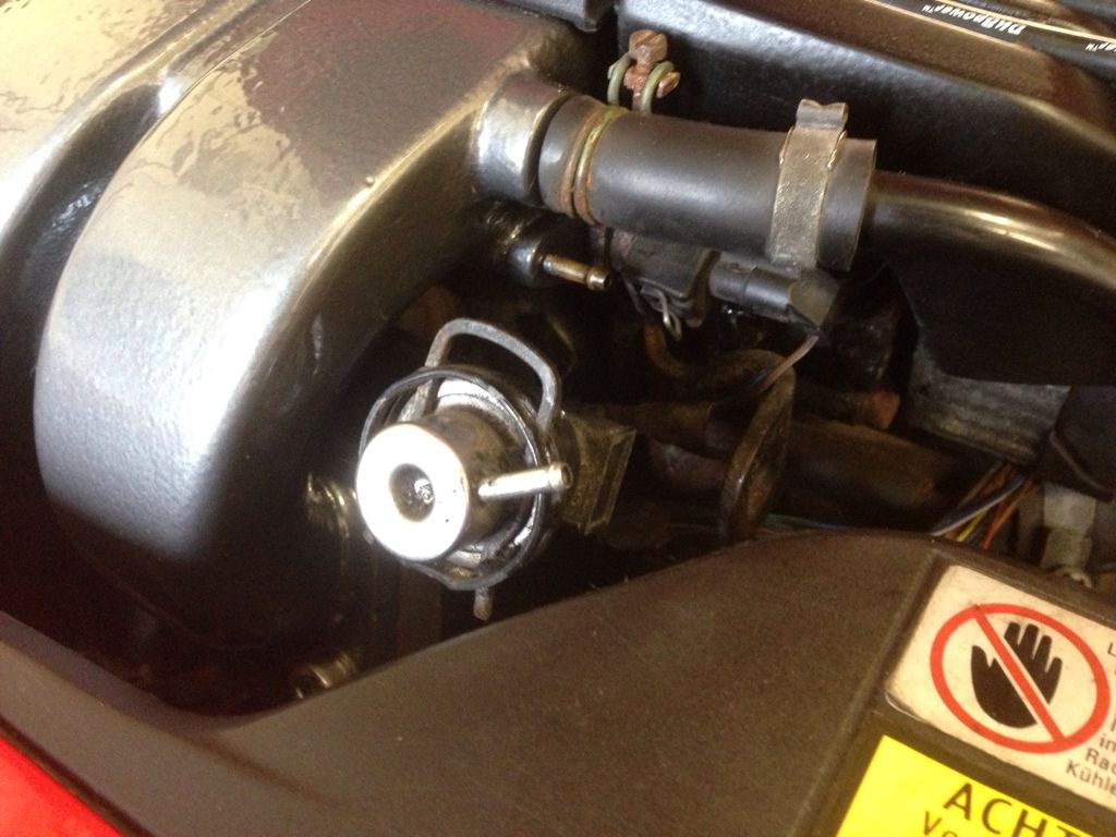

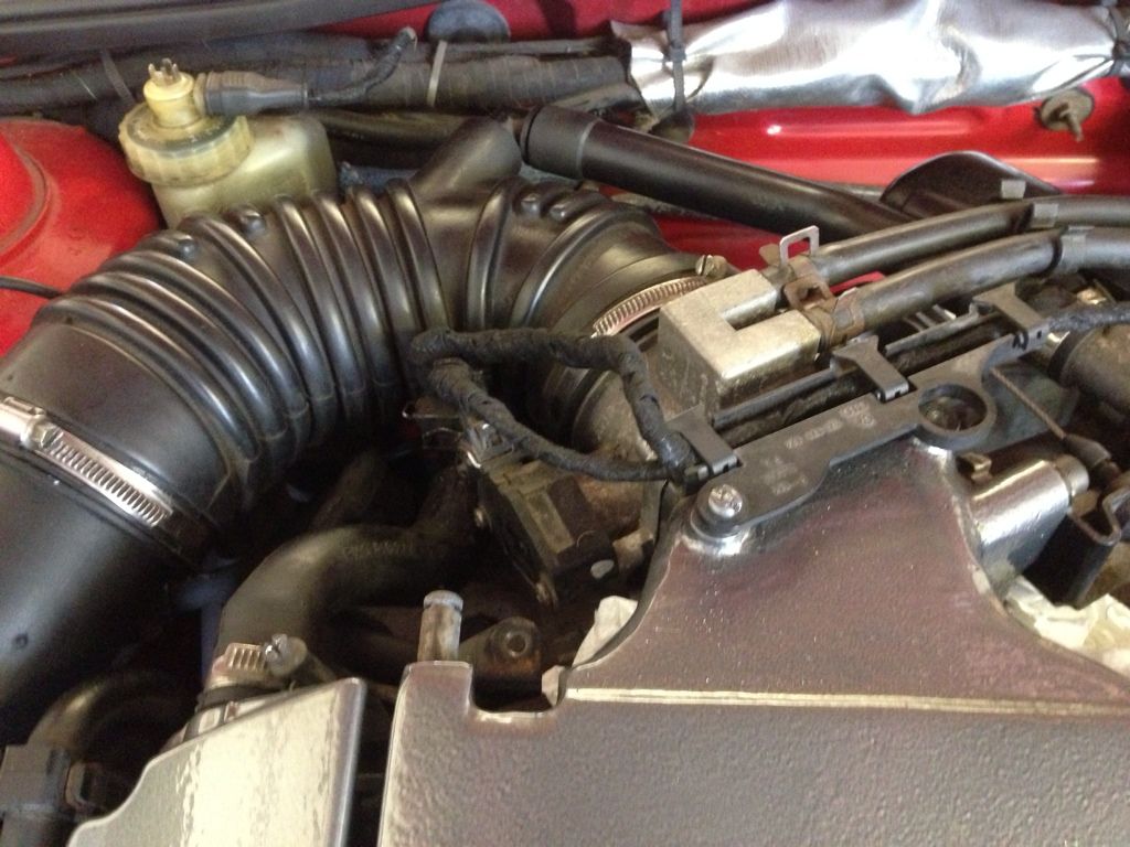

Also the vac line looks fairly badly perished so I presume this could also cause me an issue??
Below are a couple of pics, one of the regulator and one of the vac line to make sure I'm looking at the correct thing.....
Any more info on this issue anyone may have would be great.

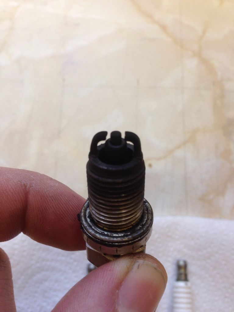

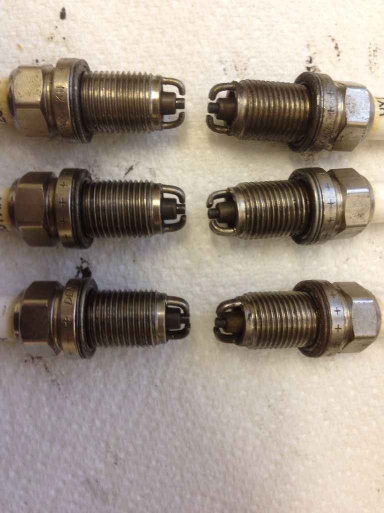

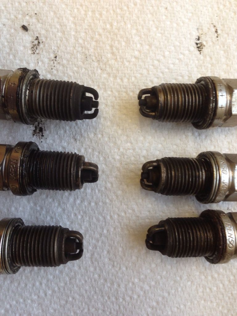

Managed to take 5 min today to pull the plugs out as I'm waiting for a new fuel pressure regulator coming and they looked fairly black so I'm presuming this means it's rich? Would they be blackened from trying to start as t he aa man cleaned them when they were out when the starting issue first happened but it hasn't run since, pics below show plugs, all we're dry and not wet as I expected to see.........
All 6 plugs.
This was the worst of the lot.
Gave them a good clean up and need to dig my feelers out to check the gap, I think the Bentley states 0.7mm.

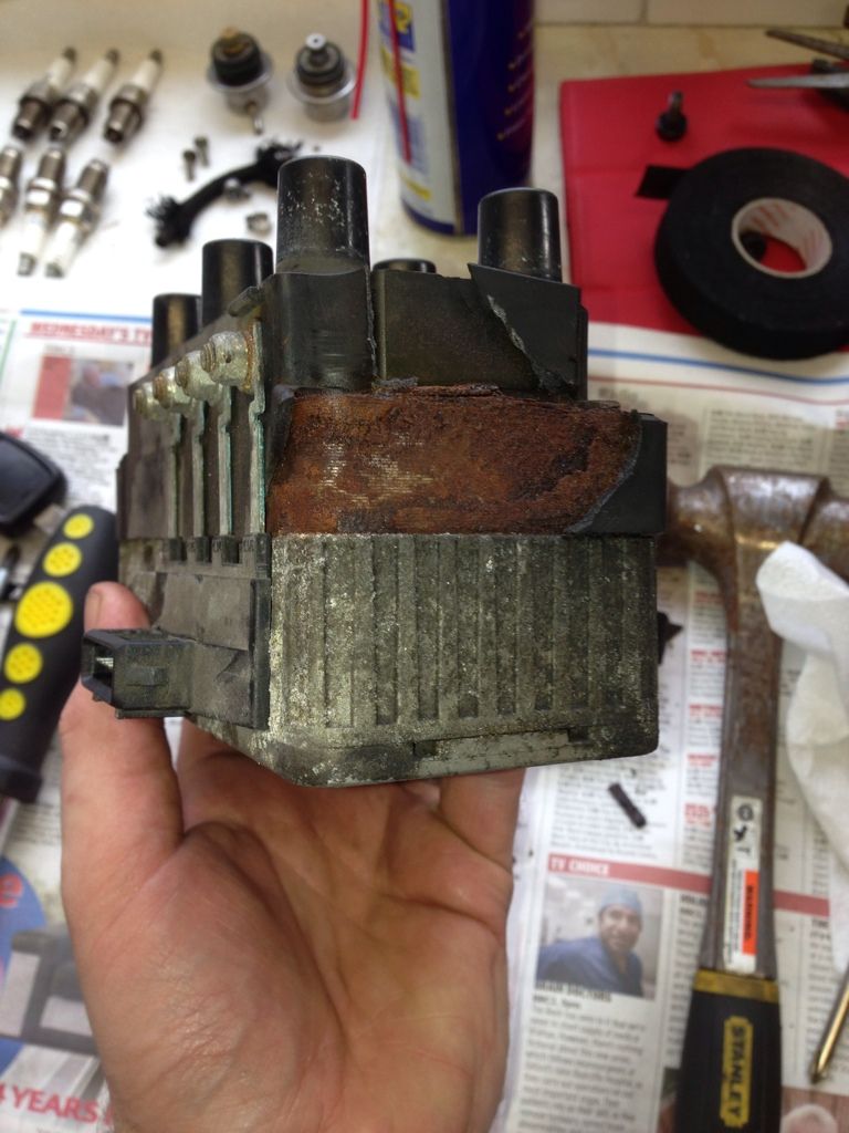

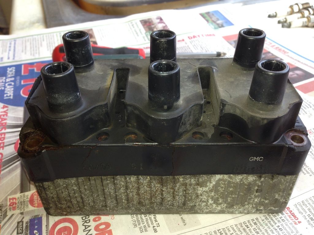

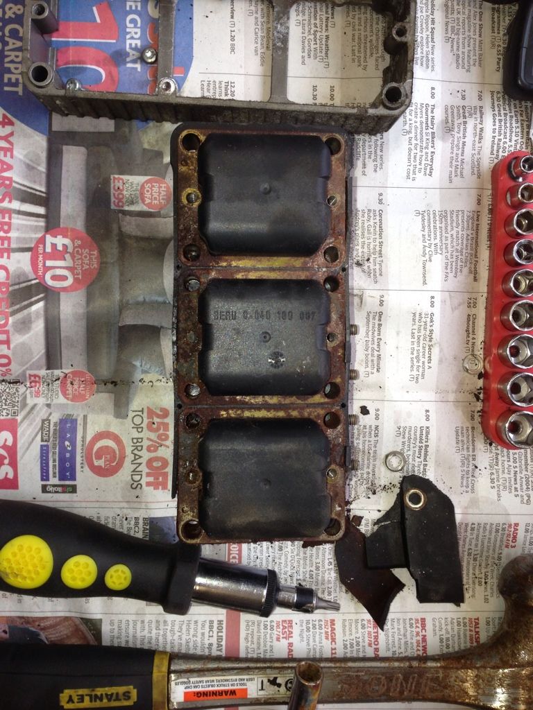

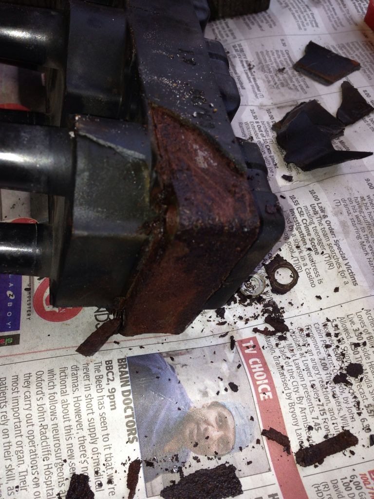

Today more progress was made with the non starting issue......I removed the fuel pressure regulator and found that ISPs looking almost brand new so no worries there.......the coil pack however was a different story!!
I removed it after noticing a fairly bad crack in the plastic insulation on the left as shown below. The first shot shows the bottom of the coil pack with a few cracks and the 2nd shows the state of the pack after the bolts were removed and the plastic as good as fell off, the metal is exceptionally badly corroded which would tell me this coil is destroyed......
I started to strip the coil down and more plastic was crumbling away and the extent of the mess was pretty clear, the layers of metal were separating and some on the corners had begun to snap off.......
So the solution here it would appear is going to be replacing the coil pack and not the fuel regulator as I first thought, not all bad ough as it now means I have a spare regulator :-)

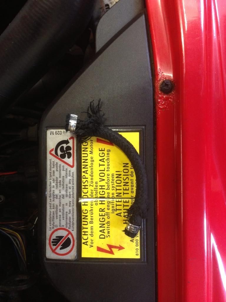

Whilst I was busy with the coil pack my mate got busy with the loom wrap and did a bit of tidying the engine up, this meant removing all my plastics again however after working on the car for a few weeks has meant these are looking marked so will most likely be getting painted again.....
So here are the sections of loom that we're done, I forgot to take before pics I'm afraid.

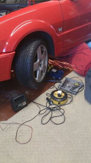

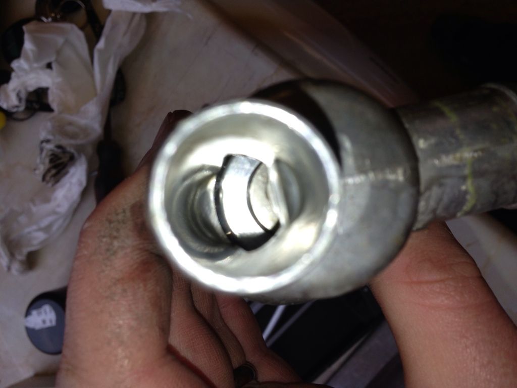

Today I got out of bed after 4hrs sleep (gotta love working nights) and decided it was time to remove the cat, of course this was not going to be an easy task.....20 years of corrosion on the bolts ment that it was a job for the grinder so I set to work.
After a hour or two with the grinder and of course the dremmel to get to those hard to reach bolts the cat was out, upon inspection it was clear to see it was totally choked and slightly melted so I'm beginning to think I'm getting cower to the issue at last!
Pic is poor but if you could see it in the flesh I'm sure you would agree its finished and time to buy a decat pipe.
Also I'm going to have to replace the sensor as I had to snip the wires due to the plug being rather stuck.......

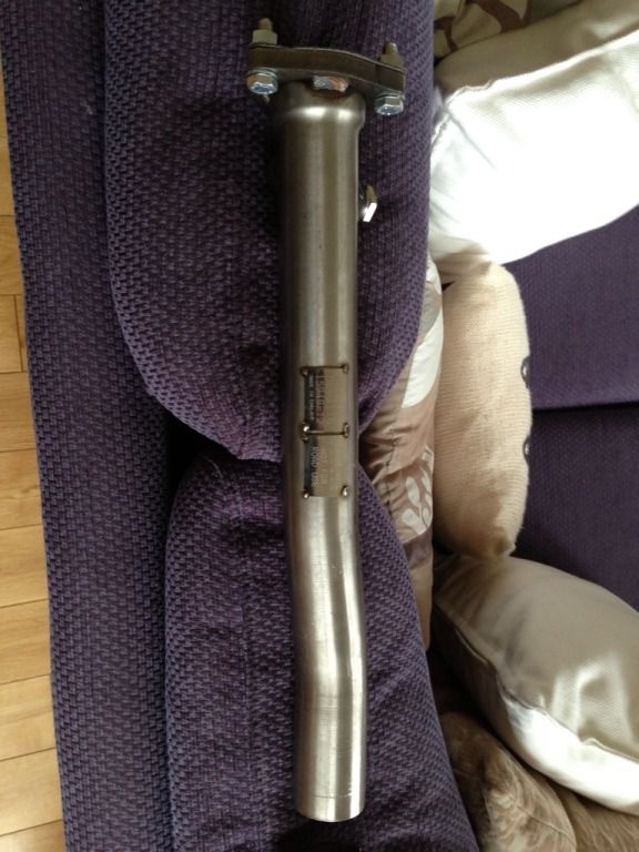

Got bored today so turned the key to see what would happen with the cat and lambda removed, guess what, it started first turn of the key!!
Just need to order a lambda and decat now and I'm go go go.

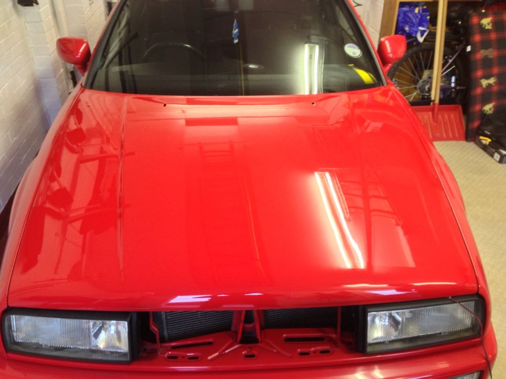

So with my mind at rest with regards to running issues and waiting for parts to arrive so I can get my exhaust fitted again I decided it was time to get on with some paint correction as the car was looking a little sorry for itself sat in the garage, it had a good layer of dust covering it, some panels had some bird lime marks and also under the rear badges etc there was some nasty dirt buildup.

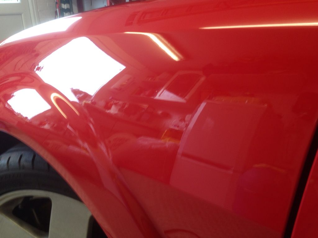

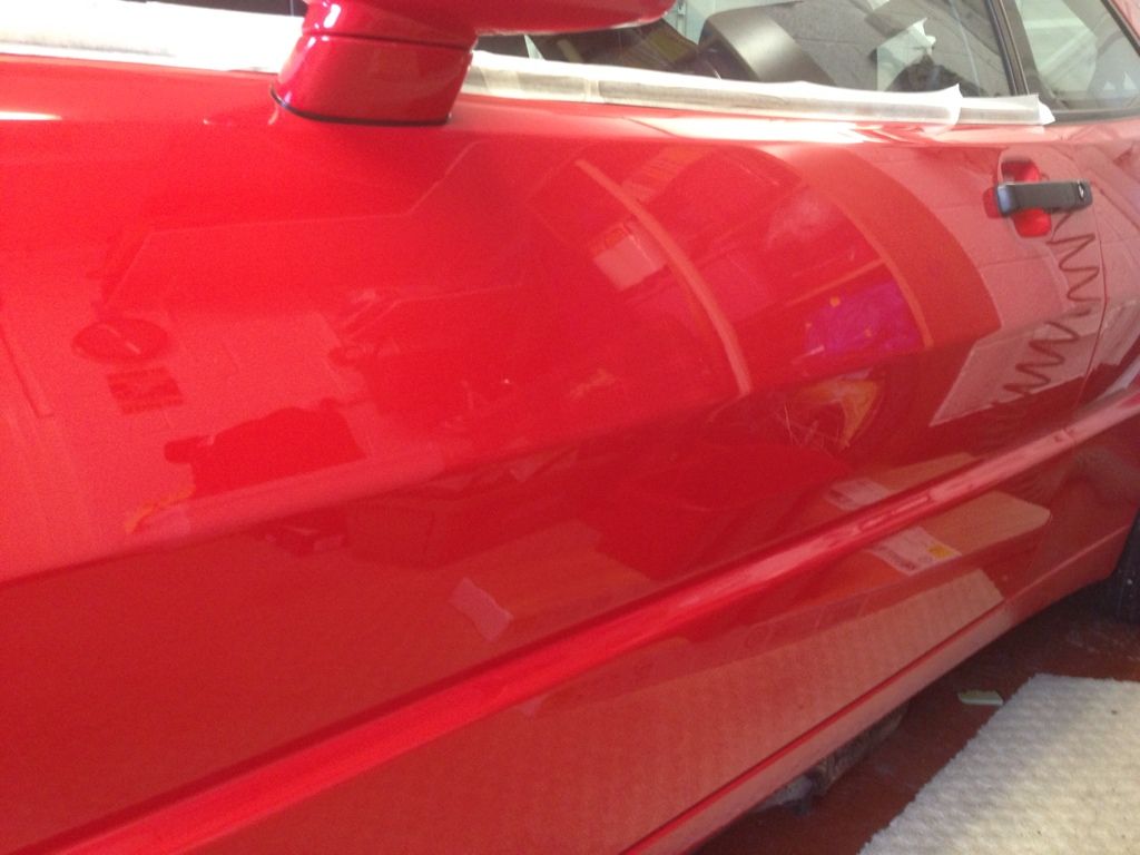

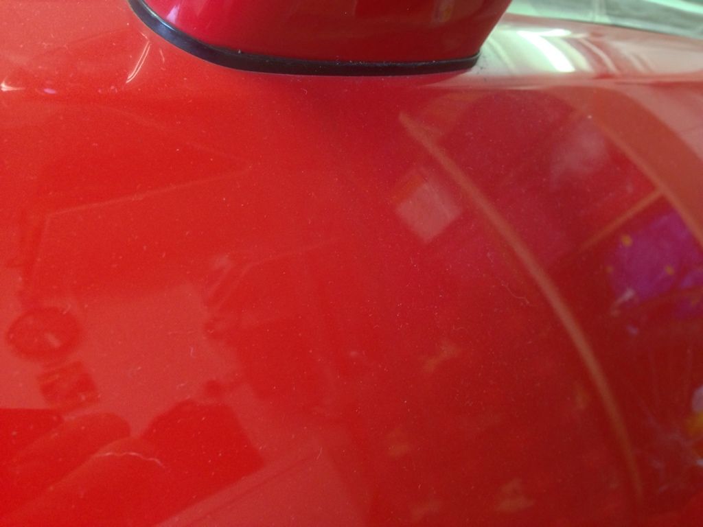

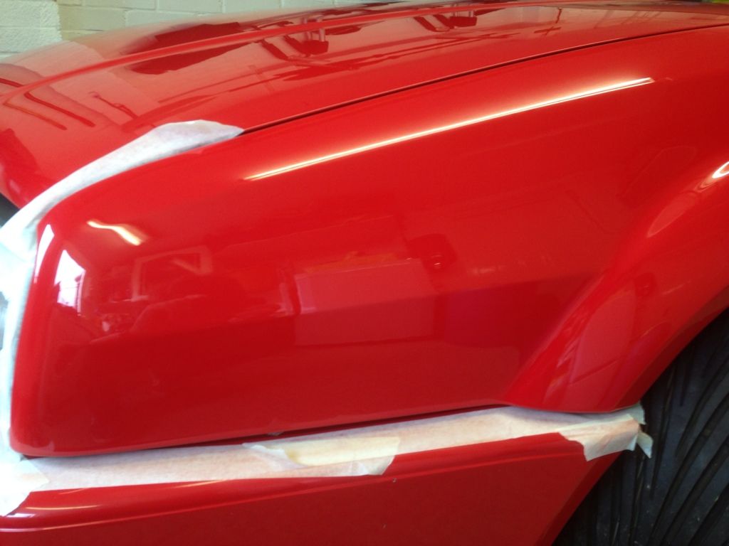

I started with the passenger wing that was slightly pink and had a bad build up of dirt under the indicator, I started with megs quick detailer to remove the dust and show the pinkness of the paint as below.
A quick pic to show the hardened dirt under the indicator.
The harsh dirt was removed using AG tar remover and then the panel polished with a medium pad and MEZ FF polish (can't remember the name properly) and it was looking like this.
Next stage was a coat of AG super resin polish to remove a little marring that was left from the machine polish then AG HD wax to seal the paint and protect it.
And also a quick pic of under the indicator.

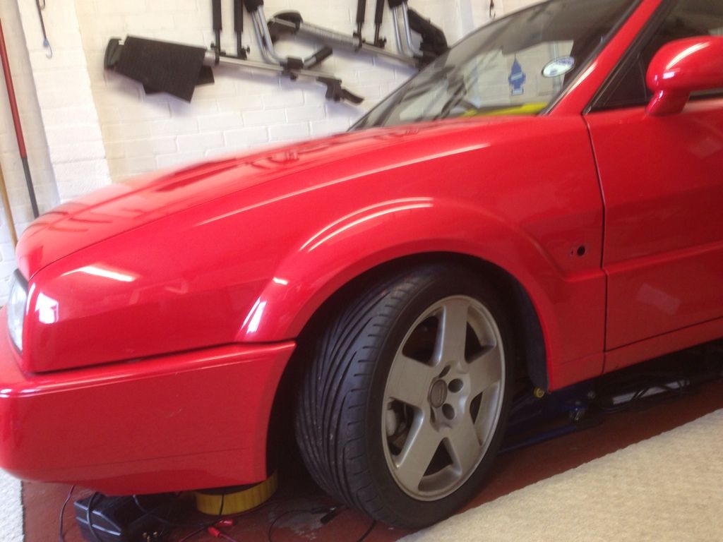

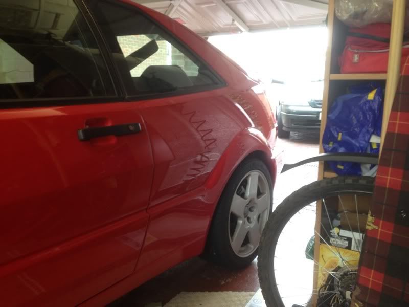

The same process as above was then completed over the whole car so here are some more pics.
Some nasty water marks under the wing mirror before and after.
And a few more after pics.

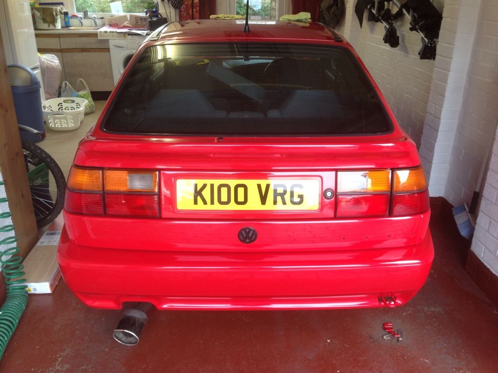

You have to excuse the exhaust here I need to fit it.

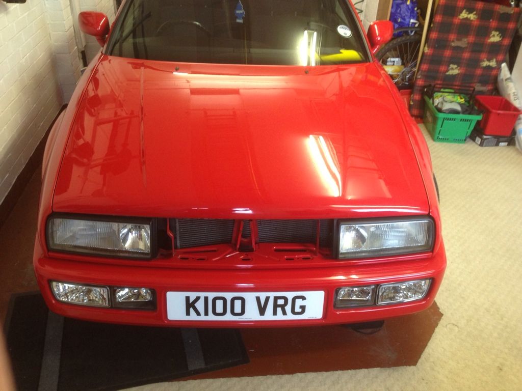

Front end is still waiting for the grill to be fitted as I have been painting it.

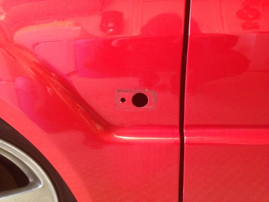

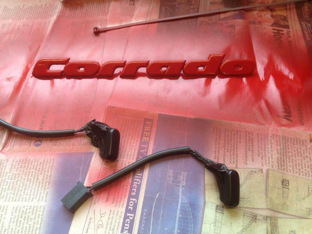

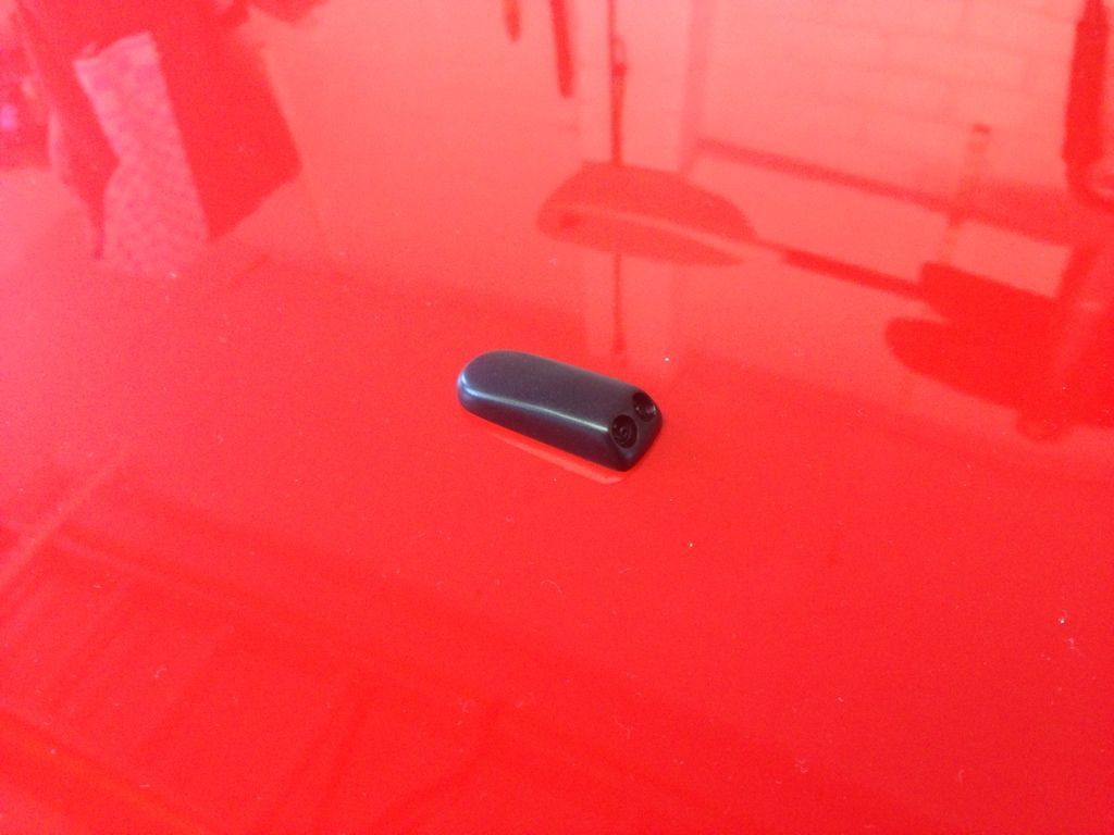

Finally got round to painting the rear badge and also finished off the washer jets.
Last thing in the day was to fit the jets.

Looks lovely, just not keen on the rear number plate surround.
By the way, is your car lowered on coilovers or shocks and sprigs?
Looks great! Can't wait to get started on detailing mine! Gonna take a while to sort the interior first though! :(
Cheers guys,
I'm still in two minds about the plate surround myself, have another one lying about that I'm tempted to do gloss black and see how that looks as I think there is too much red at the back of the car.
The car is on coil overs, FK Konigsports to be exact, I need to wind the front down about 1/2 inch as at the moment it has a wee bit too much reverse rake for me but I'm waiting to get the splitter fitted before I do that so I know what clearence I have.

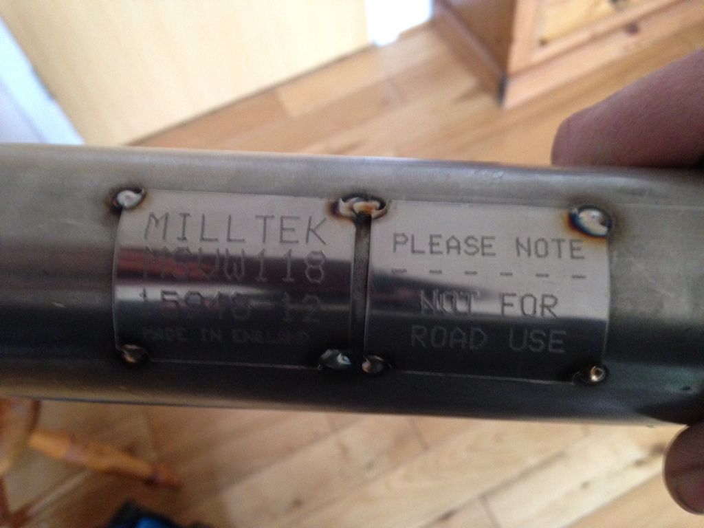

Another small update, this came today but of course the excitement was cut short by the fact it is in fact the wrong length by 150mm.....fear not though my local car parts shop has ordered me an extension to sort me out :-)
Hope to get this fitted Monday and I'm good to go (once I tax the car and get all the little details done)

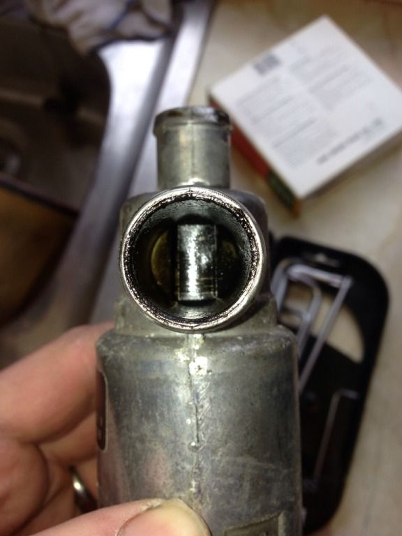

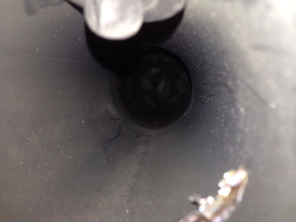

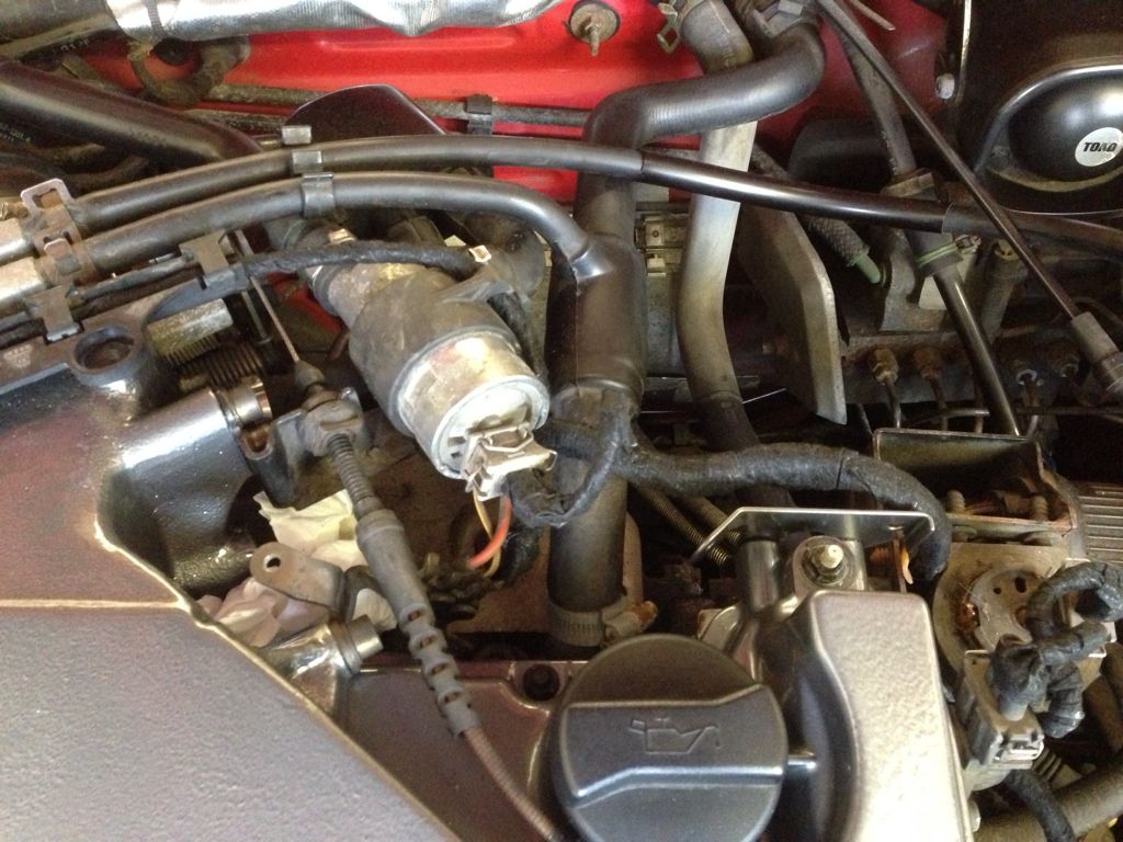

I fitted the new lambda today and fired the car up, it started up straight away and sat at an idle of 1000rpm,
I allowed the car to get warm (Until the fan pulled in) by which time the idol was sat at about 900rpm and still steady, I slowly brought the revs up to around 3000rpm and let them drop slowly using the throttle and they settle again at around 900rpm, I then did the same but let the revs drop off quickly by lifting straight off the throttle, they drop as expected but then the car struggles to hold idol and is lumpy for about 10-20 sec before it settles again.
I didn't little experiment with the ISV by trying this with it plugged in and with it unplugged, on both occasions the car behaved in exactly the same way so I'm wondering if this could be my issue? I removed it and cleaned it out, a had a fair bit of dirt come out of it, it was the refitted and tried again and there was no change however the pipe clamps were damaged some could have a vac leek also now.

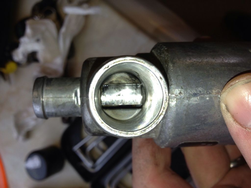

The other thing I noticed was that when I removed the ISV it was about 1/4 open, is this the normal position for the valve or should it be shut? I have put a couple of before and after pics of t he valve from cleaning below this post so you might be able to see what I mean.
The other think I noticed was a loud ticking noise when it was cold, this faded as the engine got hot so I'm wondering if I could have a sticky lifter? I'm going to check my oil levels tomorrow once the car has been sat so the oil settles as its possible I presume that if it is low on oil and the oil is cold the lifter may not be getting enough?
Thanks for all the help so fat, I feel like I'm getting somewhere now :-)
Got a few problems with isv too , anywho , the ticking you can here from cold will be the tappets , they are hydraulic , so they do tap until the oil reaches them .
