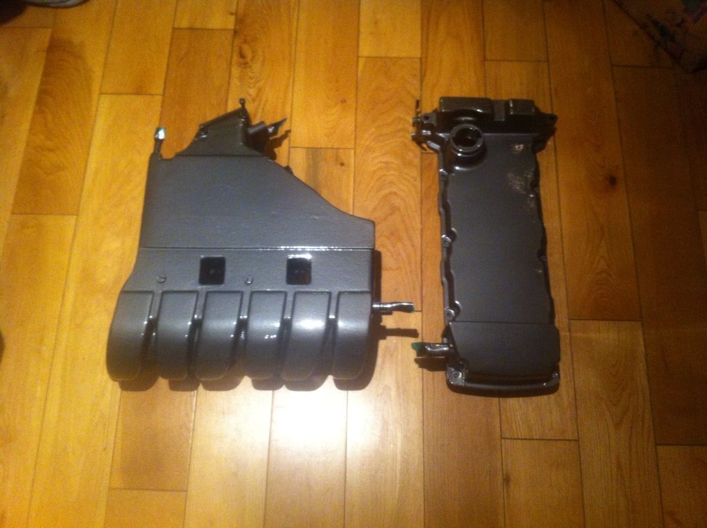

timthetinyhorse 0 Posted January 15, 2013 In my humble opinion I would go to see a powder coater and get it done properly and you will get a good durable finish, I had my rocker box and inlet mani done and it's spot on and will last forever........ Sorry about 2nd pic it was taken in the dark Quote Share this post Link to post Share on other sites

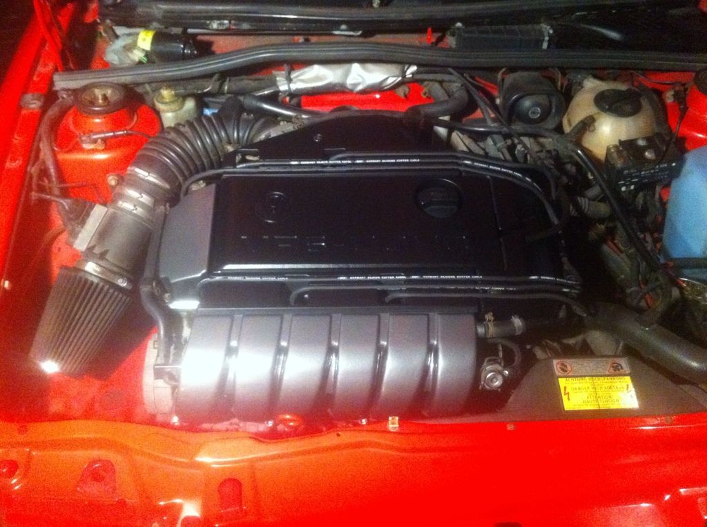

StueyB 0 Posted January 15, 2013 Another vote for powder coat here. I've rattle can painted a few inlets in my time and they look good after paint but have no durability. Just request a satin silver finish. Most coaters can accommodate this. I went for a satin black finish as I can't stand gloss black powder coating. This was a few years ago now but I can't honestly say it looks exactly the same today after a couple of removal & refittings as well. Quote Share this post Link to post Share on other sites
timthetinyhorse 0 Posted January 15, 2013 Looks stunning in satin mate, mine is gloss gun metal..... The coater near me can do just about anything, his range of colours in almost endless, I've used him for bike frames and all sorts and every time the finish is amazing and close to indestructible, well worth it if you want a finish that will last. Quote Share this post Link to post Share on other sites
StueyB 0 Posted January 16, 2013 Looks stunning in satin mate, mine is gloss gun metal..... Thanks mate. To say that I was happy with the final product would be an understatement. They really do know what they are doing @ Perfect Coatings, Meppershall, Beds. Echo your sentiments on durability. I rattle painted a bracket earlier on for my rebuild and pulled paint off just re-installing some fittings. Case in point. Quote Share this post Link to post Share on other sites
