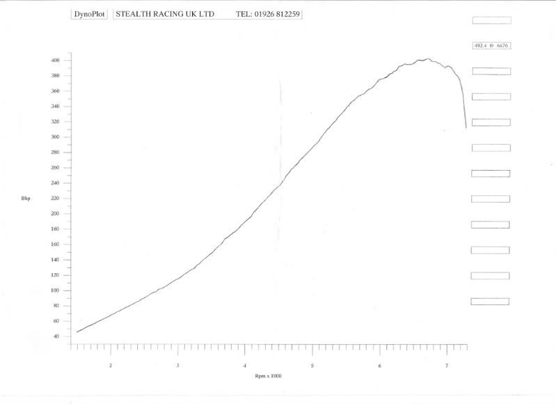

Cant be bad then making 400hp/340-345whp with a 2.25 Magnex then anyway forget that what I do need now is better brakes, no more 312

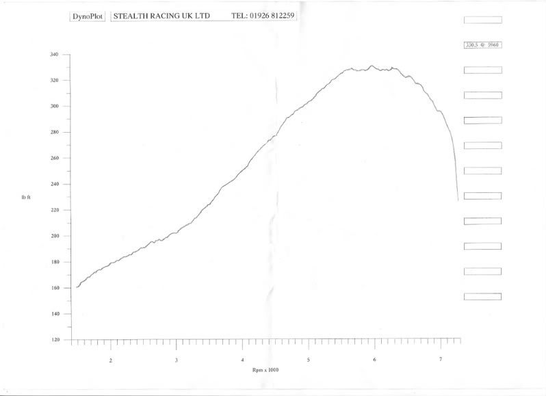

Looks like you're losing 40lb/ft from 6500-7000rpm, not a criticism, but bigger valves and a bigger exhaust should help hold that to 7K, but as you say, brakes first. No prizes for guessing what I recommend!

Yeah with the oe cams it seemed to hold better at the top end even though i made more gains throughout vince did say that was the only let down... it drops from 320@6600 to 270@7200 but i will look to sort this

btw, it's 330lbft not lb/ft (lb multiplied by ft, not divided)

Bobbi, yeah stock cams and head give up at about 6500ish rpm too. More flow in the head and exhaust is something you can do in the future, it will defo help. What you've done already is a damn good start! Congrats.
