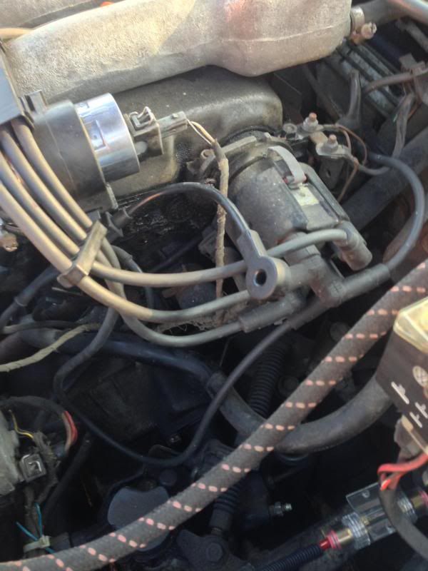

borarob 0 Posted July 17, 2013 (edited) My lovely new corrado (9a) is not starting. Nothing happenings at all, not even trying to turn over. Car is fitted with a cobra alarm system and immobiliser, which appears to be working ok. Immobilizer activated = nothing happens at all when turning key, no dash lights, no clicking or buzzing. De-activating immobiliser = turn key and dash lights come on as they should, turn to start and I can hear fuel pump prime and I can feel relay 18 clicking as you would expect, but no turn over at all. I thought perhaps the battery had died, though headlights, wipers windows all working as expected, have since given the battery a charge to make sure and still the same (jump start also doesn't help, haven't tried bump start yet). As all of the dash lights come on and relay 18 clicks, would you say this eliminates the ignition switch and the immobiliser from being the problem? I noticed the following not connected when I bough the car, at the time I thought it was the knock sensor, i've since googled the part number and the web tells me its a crank position sensor is that what it is? if so where should it be connected to and would it floating around like that mean that the car wouldn't start. It has been like that since I've had the car (3 weeks but only been using it in the last week). what else could it be? starter motor I guess? thanks peeps Edited August 12, 2013 by borarob Quote Share this post Link to post Share on other sites

borarob 0 Posted July 17, 2013 @phill - no noise coming from starter / engine, just clicking. i've had the battery charging again so i don't think its the battery, but i'll try and get a multimeter on it later to test voltage across it. I do have another ignition switch so i'll try that ---------- Post added at 10:05 AM ---------- Previous post was at 9:19 AM ---------- if it is ignition switch would relay 18 still be activating? ---------- Post added at 11:01 AM ---------- Previous post was at 10:05 AM ---------- [/color]Oh and yes, that circular thing should be round one I'd your ht leads. Which one I'm not sure? really - how would you route an HT lead through that hole? so it doesn't bolt to the block anywhere? Quote Share this post Link to post Share on other sites
Jim 2 Posted July 17, 2013 really - how would you route an HT lead through that hole? so it doesn't bolt to the block anywhere? Genuine VAG leads have unscrewable ends. It's supposed to go on the HT lead for cylinder #4 (if I remember correctly) and you should be able to unscrew the plug at the distributor cap end and simply slot the sensor over the lead. The problem is that virtually all pattern parts are not designed with the 2.0 16v in mind so you can't attach this sensor on. I went through this on my old 2.0 16v. Found a supplier on eBay who sold ignition leads, advertised as suitable for the 1.8 16v and 2.0 16v and of course it wouldn't go on as the plug end was not removable. They did a 'premium' set at twice the price where it was removable however. But even then the leads were crimped in such a way that the electrode in the plug was misshapen enough that I STILL couldn't slip the loop over the lead. Ended up having reshape the electrode / plug bit before it would go on. In short - it's a ballache. Buy a genuine set of leads from VW or at the very least by the single lead for that cylinder! Quote Share this post Link to post Share on other sites
