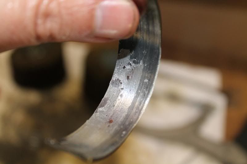

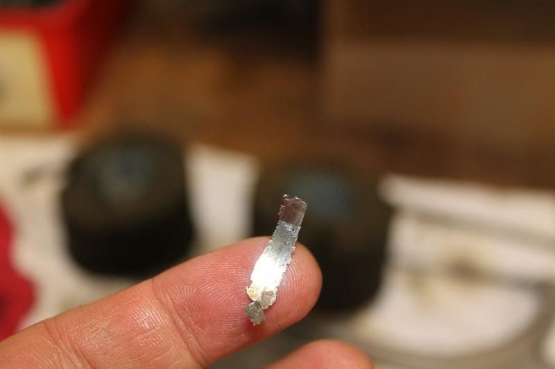

Sorry guys, I got that wrong, I thought the debris was ferrous as it was sticking to my screwdriver but it was just the coating of oil that was allowing it to stick, I rechecked it and in fact it's non ferrous, it's the same material as the big end shell lining..
At least I have finally found out what was wrong, new shells and we should be good to go.
Rog.
Hopefully the bearing didn't wear down to the steel but the shredded shards have come from metal on metal contact, i.e. no oil. Does the crank journal look blue? Hopefully you caught it just in time. A plastigauge will confirm if the bearing tolerances are still within spec.

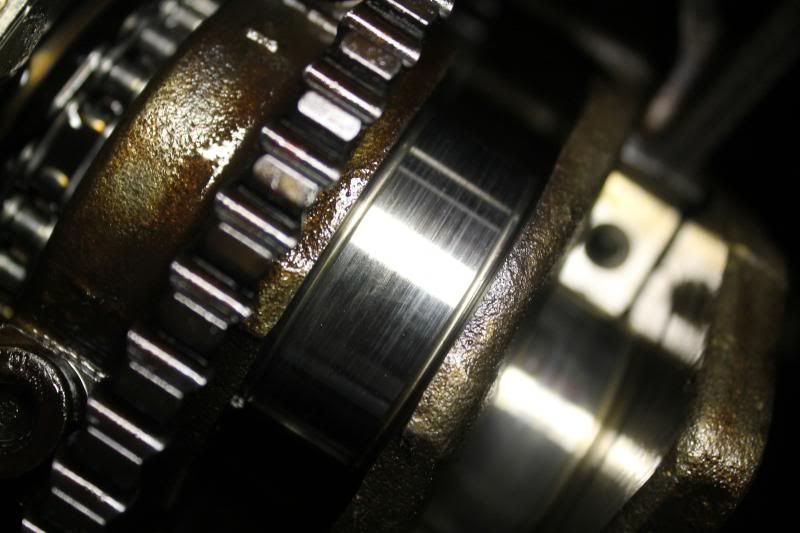

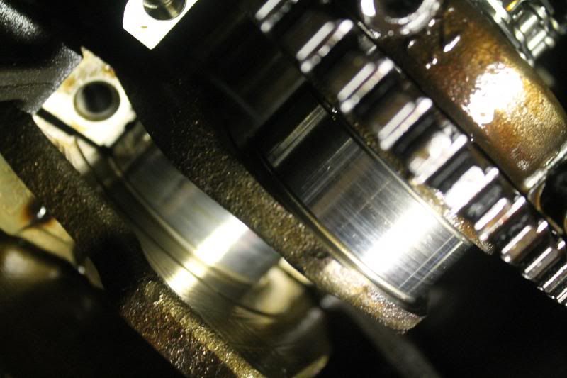

This is the no6 big end (crank), looks ok to me, there is some light scratching but not deep, I can't feel it with my finger nail.

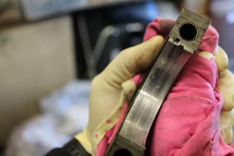

And this is the cap from no6 main bearing, a little bit of wear but not bad for a 139,000 mile engine, I'm happy with it, who do you guys think?
