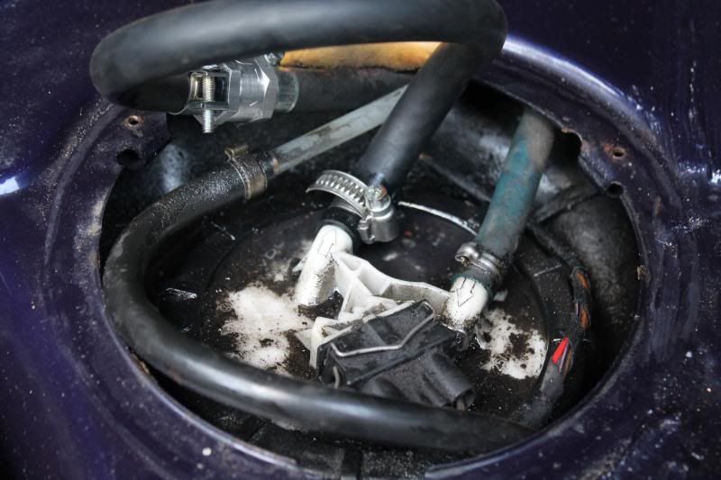

Had a bit of a shock today, car was on the drive warming up when I noticed a large puddle of fuel underneath, whipped the wheel off and it appears there is a leak from the top of the tank... bugger... I was thinking the worse and was wondering how to drop the tank when I found the inspection cover under the boot carpet.
Got the cover off and was greeted by a puddle of fuel, fired the engine up and there is fuel coming out of the supply hose joint.. one new jubilee clip later and Robert is your fathers brother..
I love little fixes like this... result.

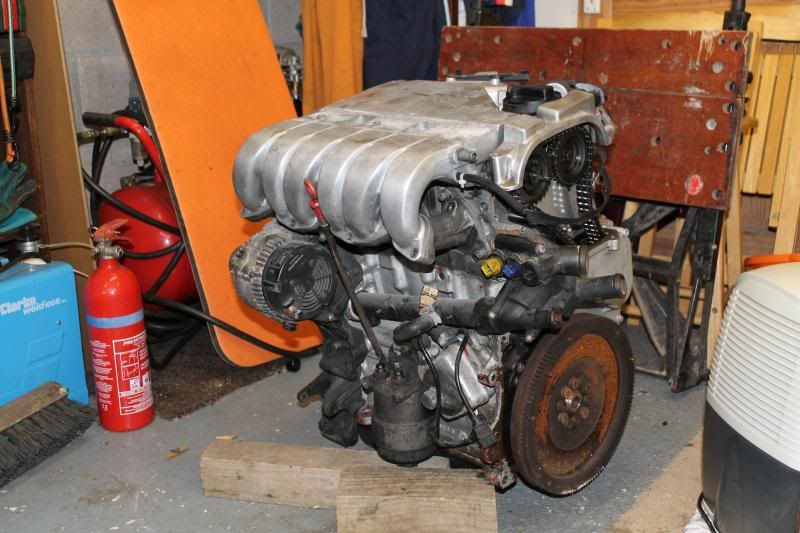

Now I have a problem with the engine, it has always 'ticked' when cold so I've bought a new set of lifters that are waiting to be fitted, then I noticed a bad rattle sound when hot and under load, its worse above 3k and quite loud so I took it up to Dan at Devon Dub Shack, he advised me to see an old customer of his who is a bit of a VR6 expert, he suggested that it could be big and/or small ends.... bugger... however he has a mate who has an engine for sale... so a deal was done and I ended up being the proud owner of a spare VR6 engine.
It came out of a Golf so I assumed it was a 2.8 AAA but I later found out that the Golf was a converted 1.6 and guess what, the engine is a ABV... result..

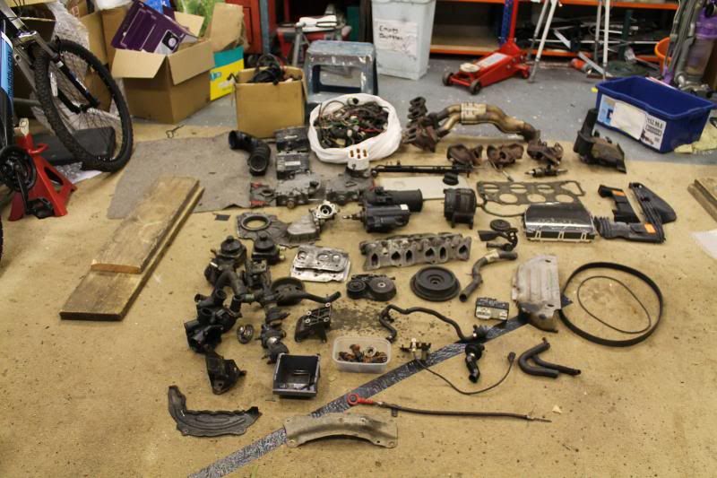

Oh, and it came with all these spares..

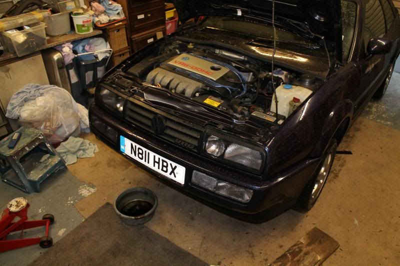

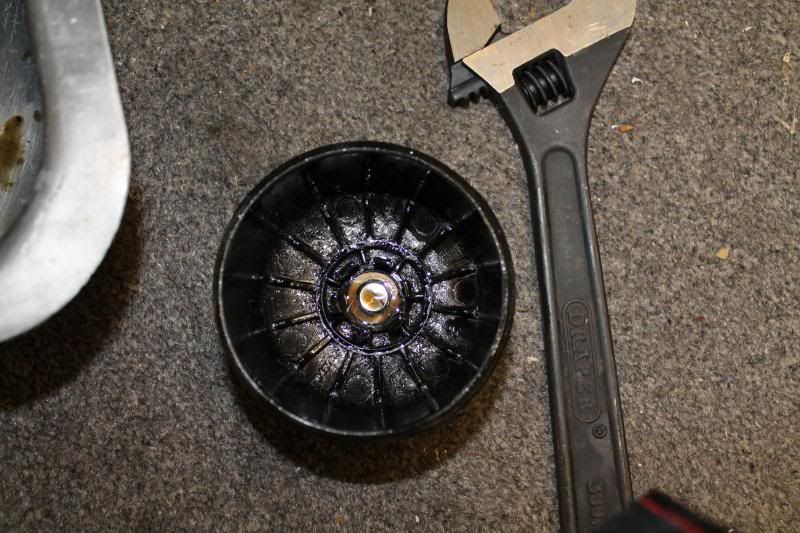

So today I dropped the oil and filter.

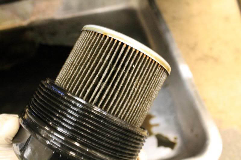

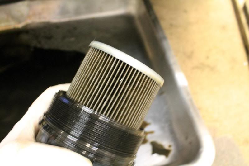

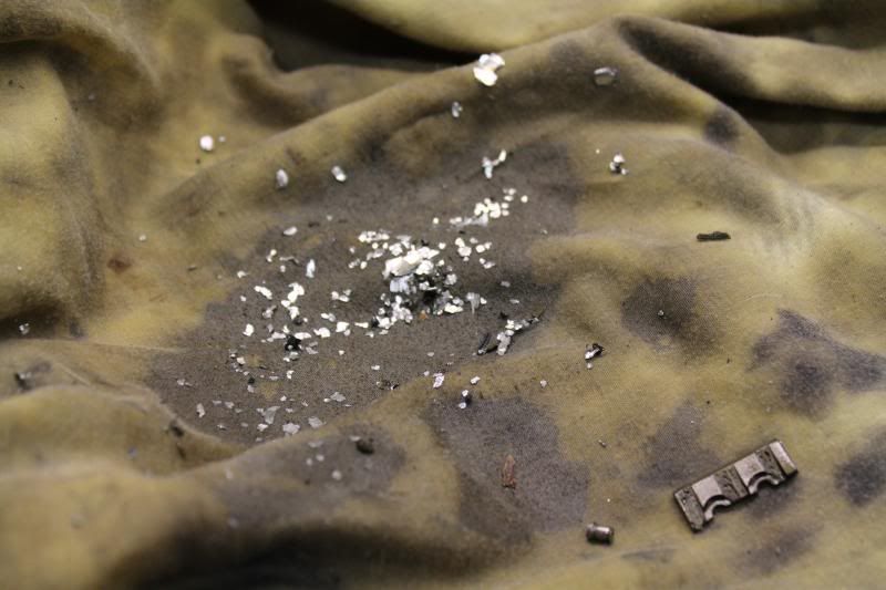

Checked out the filter and it's full of metal particals.... not good..
Filter housing full as well
Although there didn't seem to be any in the oil..

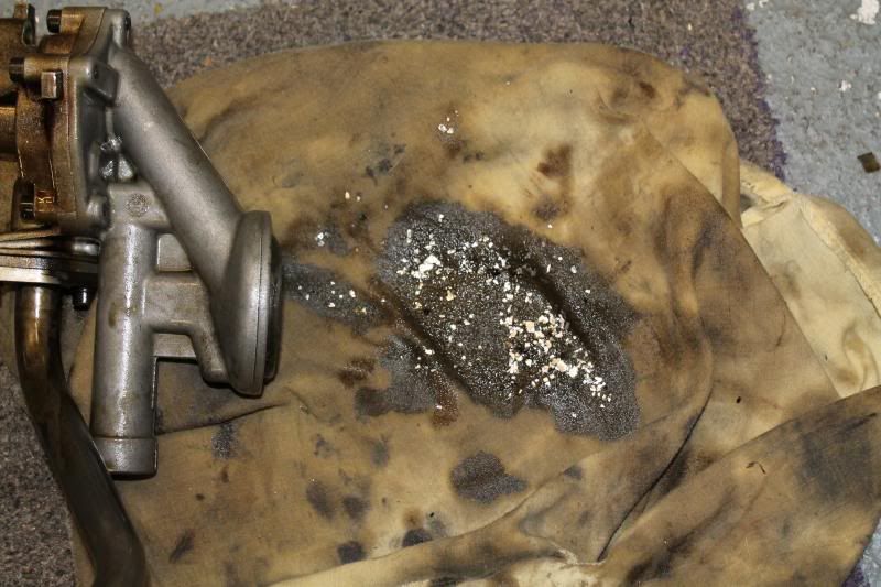

So I thought I better drop the sump, there was a few bits in the bottom of the sump but not much however the oil pump strainer was full so i removed the pump and got all the bits out.

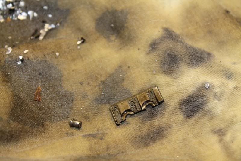

Then I got a surprise, I pulled this big bit out of the stainer..
Comparing it with my spare engine it appears to be part of the upper chain tensioner, there is also a bit of the securing rivet.
mmmmmm I'm actually quite pleased, it now looks like the tensioner has failed and broken up so hopefully the rest of the engine is fine, I ran out of time today so tomorrow the plan is remove the upper chain cover and check it out, hopefully the tensioner is damaged and a replacement will solve my problems... however the gearbox needs to come off to get to the bottom of the tensioner... bugger... better than an engine out though...lol

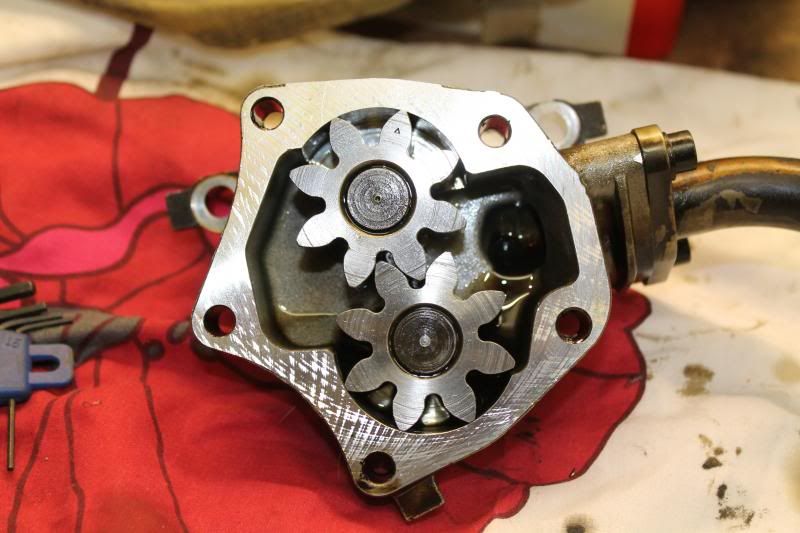

Oh, quick pic of the inside of an oil pump..

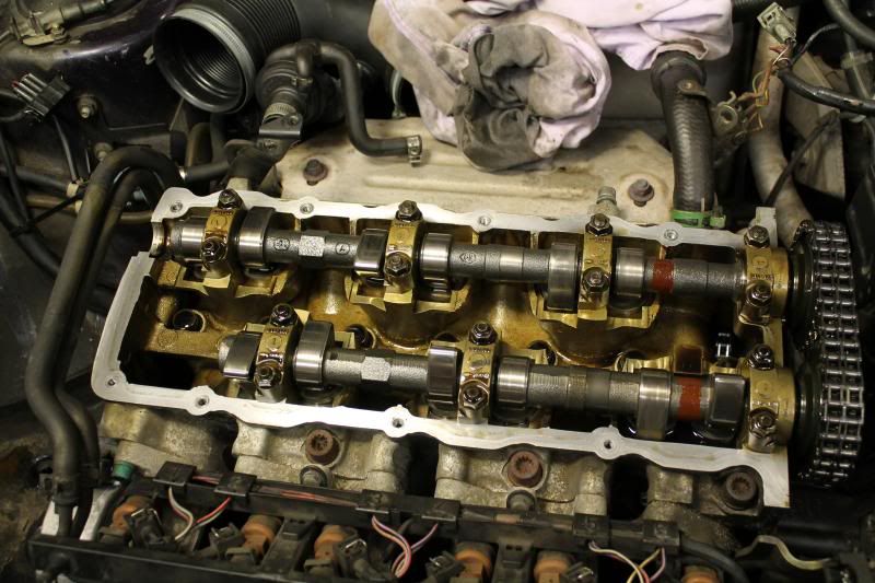

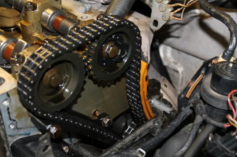

Ok, grabbed a quick hour down the garage and managed to get the top chain cover off..
Guess what, my tensioner has been replaced with the later type... so the question is... where did that piece of plastic come from??
Has the top tensioner failed at some point in the past and that's been stuck in the oil strainer all these years or has it come from somewhere else... is the bottom chain tensioner of similar design??
Oh, and a quick pick of the cams, look like new, no wear and all looks nice and clean... looks like its been looked after.
