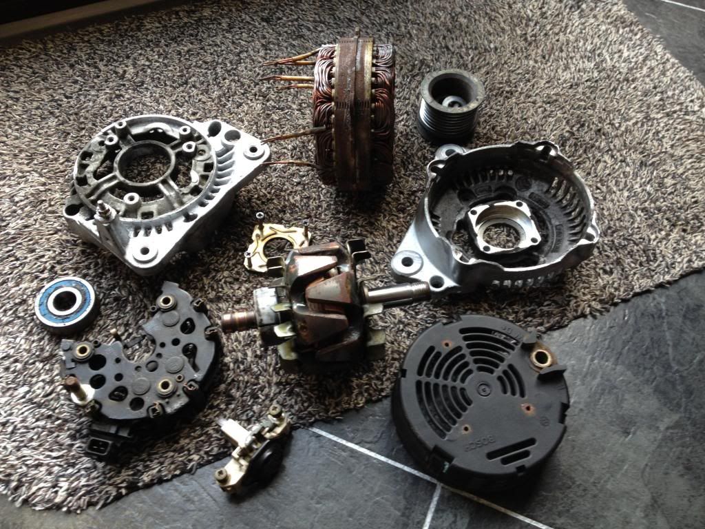

Thay can be refurbished, this is how mine stands at the moment:
Going to get the case vapor blasted then decide whether to paint it or leave it. The copper on the stator cleans up well with tomato sauce!
Was it easy to split? Are you going to change the bearing and if so where do you get them from?
I may source a spare to refurb and just keep mine as a backup..
I got it split at a place local to me but they tried to do me over when I picked it up so will build it back up myself.
There is a company we use at work who supply bearings so might see if they do one.
