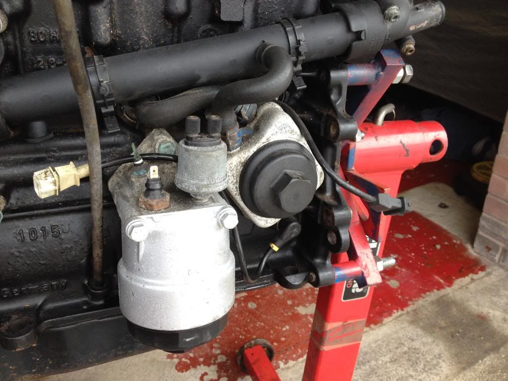

Can anyone tell me what these oil pressure / temperature senders are please?
I want to replace the 2 on the left, the one with the large body I think will be cleaned up.
I do have the gauges in the centre consul.
The one at the back is the mfa dash cluster oil temp sensor the one on the front left is the high pressure oil sensor.
The large one on the right is a dual pole sender for the low pressure oil sensor and the bar sensor for the centre console dials
Edited by Jon_vr6
Do you have any idea in the pressure rating for the high pressure switch please? Is there a range for the temp one?
Never seen a big one before. Mine are both little ones.
Oooh er misses!!!
It's because it's a variable signal pressure sensor for the oil pressure gauge, rather than just a low pressure switch for the dash light and buzzer
