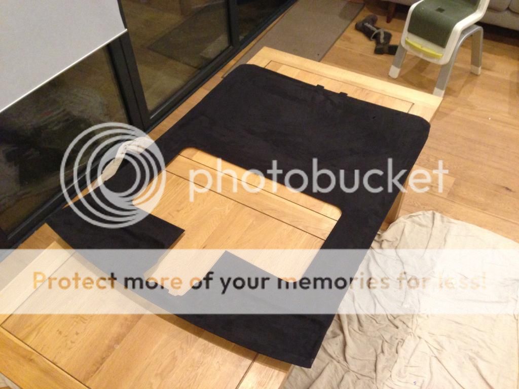

Supercharged Will 10 Posted February 26, 2015 Why not just do this. Simple job. Quote Share this post Link to post Share on other sites
VAG-hag 0 Posted February 26, 2015 What do you use will? I'd like a black liner but the visors etc being gray puts me off Quote Share this post Link to post Share on other sites

Supercharged Will 10 Posted February 26, 2015 Retrim is the best option if you fancy a change m colour. Cost me £50 in material, glue etc. job was easy, do your research and take you time. Having never done anything like this before I'd say the rssults are 99% perfect. The alternative was £400 for someone to do it. Quote Share this post Link to post Share on other sites

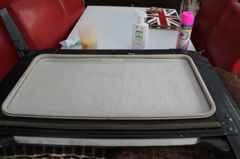

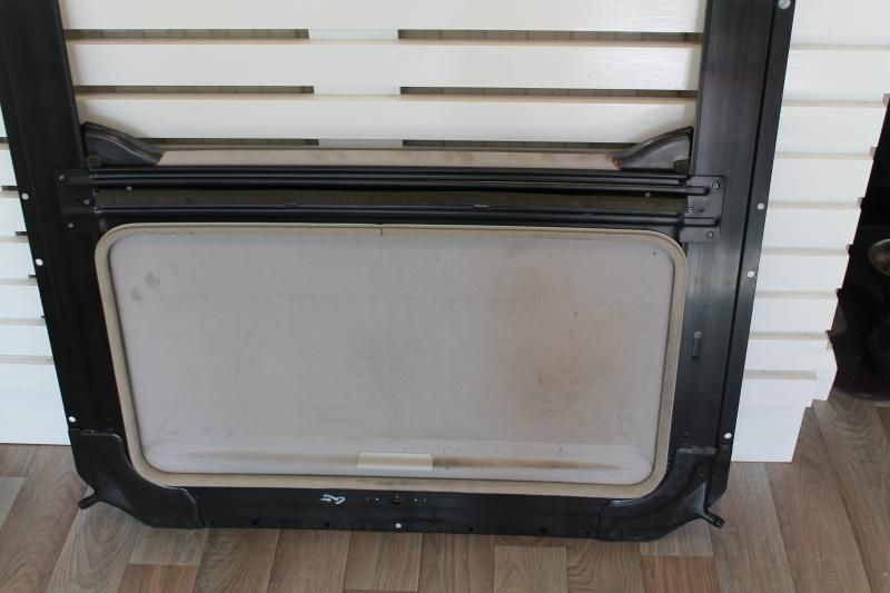

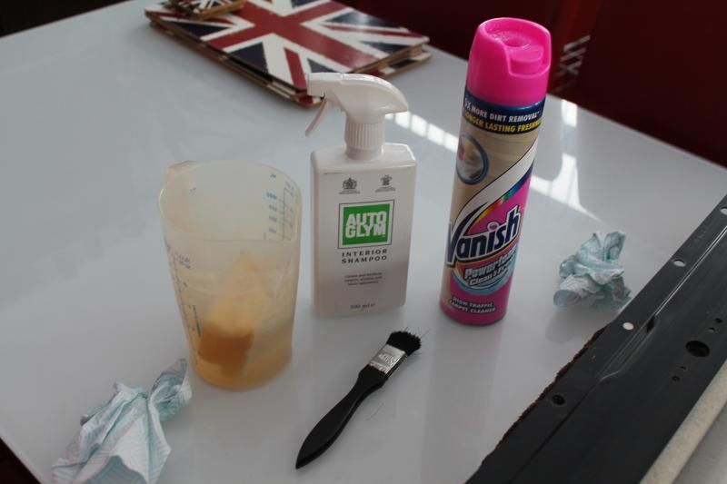

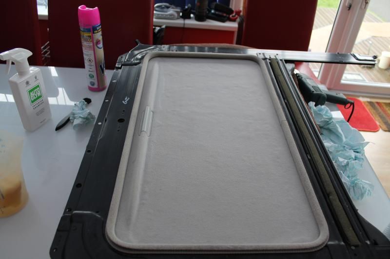

Roger Chatfield 0 Posted February 28, 2015 So, thanks for all the tips friends, I had a go at this yesterday. Before. And after. Tools of the trade...lol I used the wifes Vanish carpet cleaner for the first clean then Auto Glym interior shampoo for the second clean, I used loads of paper towel to dry up and a cut down paint brush to agitate the spray.. All in all I'm very pleased with the results. Rog. Quote Share this post Link to post Share on other sites
GlosterOx 0 Posted February 28, 2015 Has come up well Rog, next job is fitting it then? Ian. Quote Share this post Link to post Share on other sites
