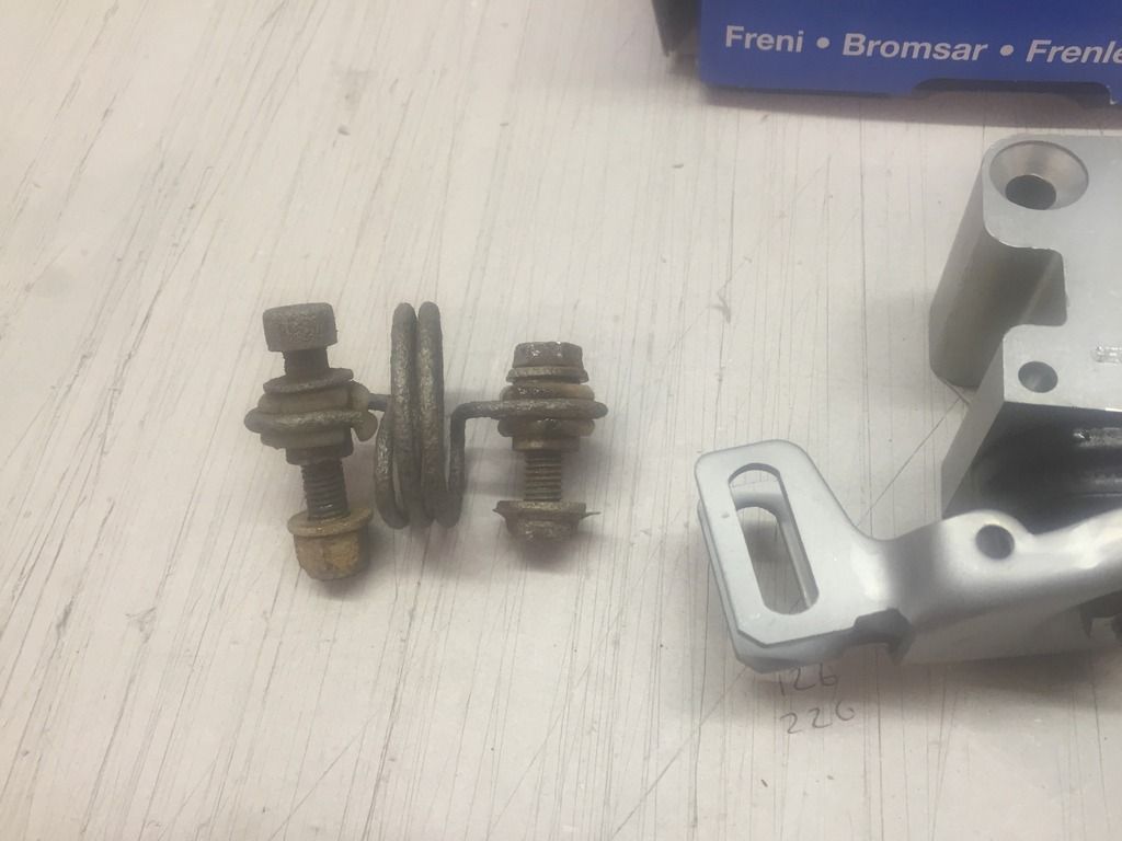

[ATTACH]83217[/ATTACH]I found my receipt. I believe these are some of the parts for its fixings as well

Jim, I'll see if I can still get this from TPS (just need to try and blag trade prices), if they can no longer get it I'll give you a shout to see if you can find yours :)
Cressa, many thanks for the part numbers etc, should be able to sort it out from that......actually got a TPS 5 mins away from work but the last time I tried to use them they turned me away :lol:
