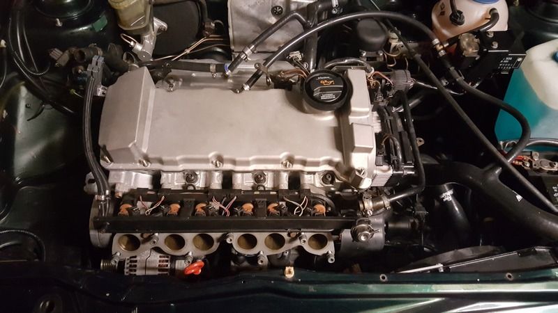

Jim Bowen 1 Posted July 20, 2016 I think i got it from ebay a bit confused as i've bought a few, didn't like the look of the first one i bought and i also bought one for the fuel hose near tank. Am quite sure it was the alloy mini type from here, (shows up in my email receipts), its not an inside the hose one, i cut the hose and added it in. http://www.ebay.co.uk/itm/Non-Return-Diesel-Fuel-Check-Valve-Aluminium-or-Nylon-For-1-4-5-16-3-8-I-D-Hose-/251270362764?var=550423714162 Can just about see it here Quote Share this post Link to post Share on other sites
