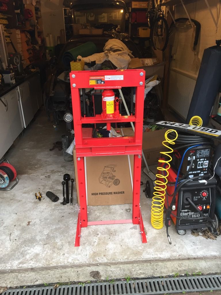

Dox 31 Posted June 5, 2017 Snap I think mines a bit taller than that? I've modified it to hold a quick release clip on shelf at the bottom that my mig sits on and a similar set up above using a Metro rim to wind my compressor hose around as it gets so little use as a press. Quote Share this post Link to post Share on other sites
easypops 8 Posted June 5, 2017 I think mines a bit taller than that? I've modified it to hold a quick release clip on shelf at the bottom that my mig sits on and a similar set up above using a Metro rim to wind my compressor hose around as it gets so little use as a press. Wouldn't mind seeing those mods mate. I think mine will either end up on castors or chopped down to fit on the bench. Quote Share this post Link to post Share on other sites
Dox 31 Posted June 5, 2017 Wouldn't mind seeing those mods mate. I think mine will either end up on castors or chopped down to fit on the bench. I'll get a pic tomorrow, nothing fancy, just used offcuts of box section, an old dexion shelf and an abandoned Metro wheel. Quote Share this post Link to post Share on other sites
Dox 31 Posted June 5, 2017 Found some on my phone Sent from my iPhone using Tapatalk Quote Share this post Link to post Share on other sites

easypops 8 Posted June 6, 2017 Can you link an example? I've got this one, it's very basic compared to what else is out there, but so far I've not been defeated as yet. https://www.ebay.co.uk/itm/132158957869 Loving your mods btw, all way better than I could make:) Quote Share this post Link to post Share on other sites
Dox 31 Posted June 6, 2017 I've got this one, it's very basic compared to what else is out there, but so far I've not been defeated as yet. https://www.ebay.co.uk/itm/132158957869 Loving your mods btw, all way better than I could make:) I'm no welder, without a grinder it looks pretty awful TBH. It serves 2 purposes, to store the MIG and hose and it also stops you kicking the angle iron feet - extremely painful if you happen to just catch your little toe! The press is situated by the main entry door. Quote Share this post Link to post Share on other sites
