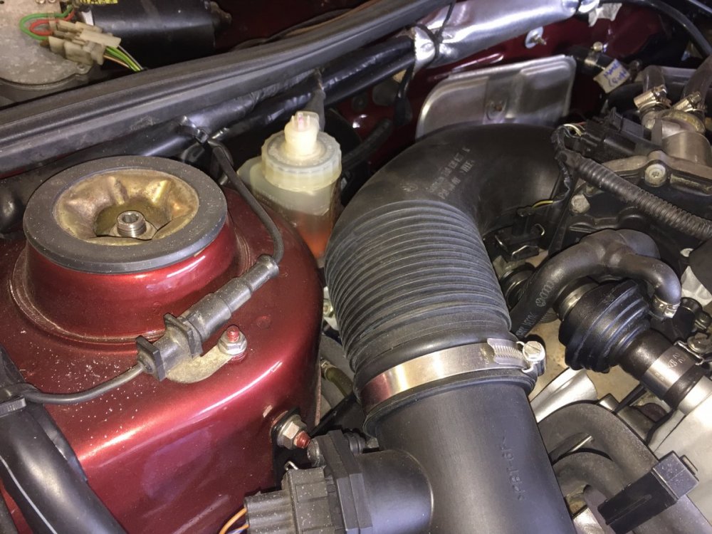

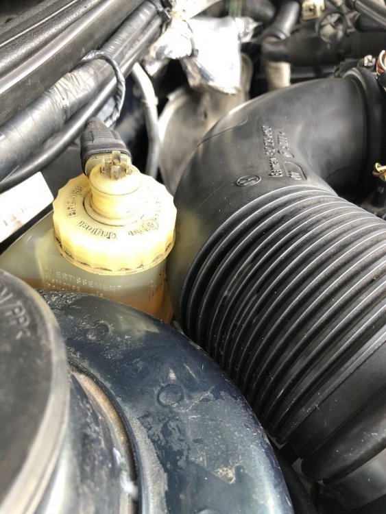

Has anybody else done OBD2 and Teves 20 upgrades that left them with the brake reservoir rubbing on the inlet hose, and if so, is there a solution? The biggest part of the problem seems to be that the Golf reservoir is angled forwards slightly but I don't know if the OBD2 inlet contributes too as I don't remember how it was before.
I'm concerned that eventually one will rub through the other with the obvious consequences!

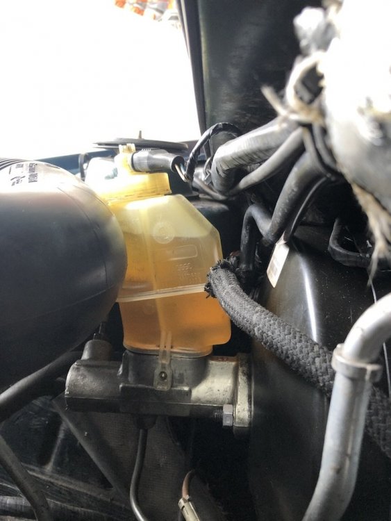

I'm afraid I can't help with the intake side of things as I'm R32 but I'm running teves20 but I used a ford focus master cylinder (same as ibiza cupra stubby) and I think the original corrado reservoir
Thanks for the replies, it does look like the Ibiza/Focus master cylinder might be the fix although a reservoir that is upright rather than angled forwards would be simpler. It'll be a job for the winter whatever, I promised my assistant (wife) that we wouldn't be bleeding brakes again this year so will have to save this until everything's been away to Bigg Red planned for later in the year!
There was a guy on ebay selling the modified Ford master cylinder. You can use your original reservoir with it.

[From memory] I put a non-abs Corrado reservoir on the MK3 master cylinder and servo.
The reservoir had the feed for the clutch (but not the two ABS feed pipes).
I can't find my photos (or the paperwork for this item??) at the mo' - I'll get the part number at weekend...

That’d be great if you could, I’m liking the easy fix!
Part 358-611-301
Brake Master Cylinder Reservoir, Corrado.
Used my original cap to match the plug.
Thanks for that, looks just what I’m looking for, just got to find one now, part number is 94-98 Passat apparently!
