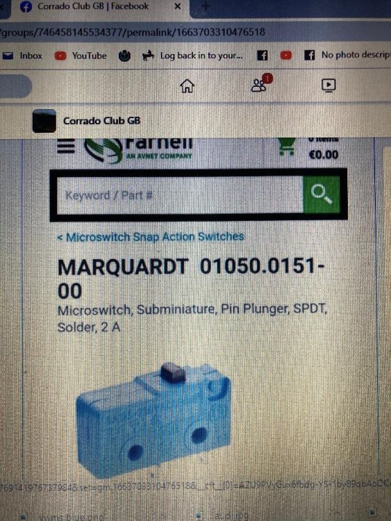

Luckily there’s someone on farcebook that is rebuilding and selling the spoiler mechanism’s, I asked where he gets the switches from and he posted this
You just have to take the levers off.
I’ve had them delivered and soon as I get time I’ll do it.
I’ll then do a how-to and tag it onto the spoiler build how-to
That's a great find - let us know how you get on. Looks like they come in minimum lots of 10.
