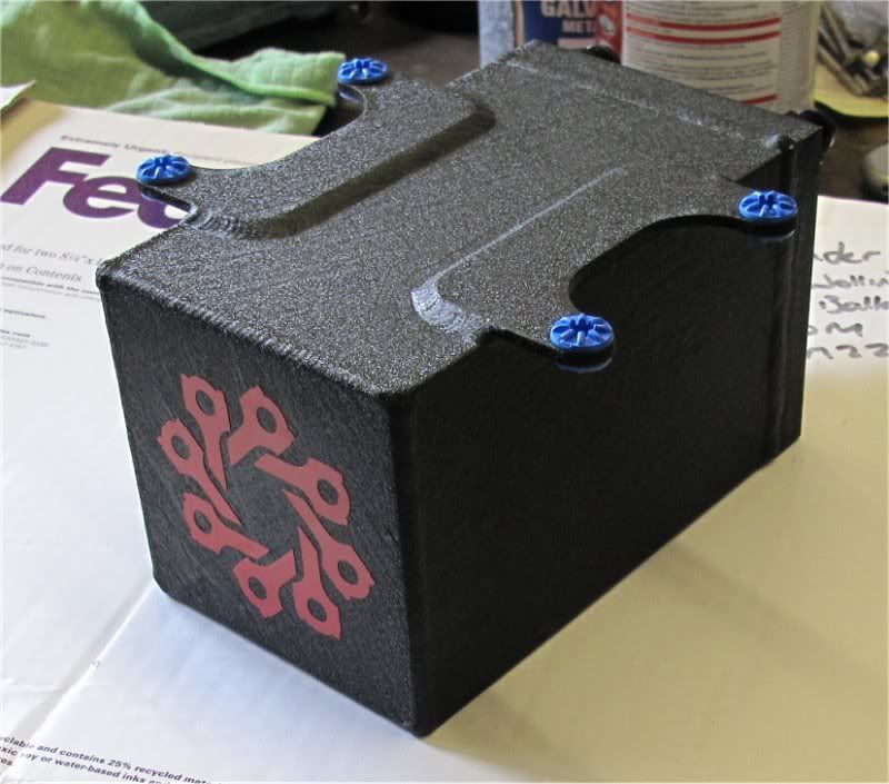

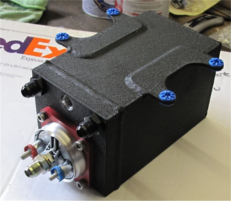

Kevin Bacon 5 Posted July 3, 2010 Hey chaps, For those of you pondering about mounting a Bosch 044 fuel pump and the issues with fuel surge, well here's a neat solution. It's a pump mount and surge tank in one handy box, which holds 1.5 litres of fuel. And because the pump is submerged in fuel, it quietens it down considerably :D With a Walbro GSS340 in-tank pump feeding this setup, you're good for 600hp :salute: It bolts to the floor where the fuel filter is. I ordered it from http://www.intengineering.com/ who are brilliant to deal with. Quote Share this post Link to post Share on other sites

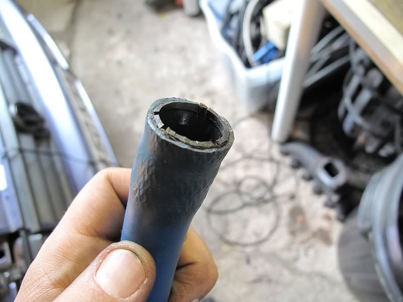

coullstar 0 Posted July 3, 2010 Nice. What are folk using for thier oil return lines? Got everything back on today and went for a run but once at temp the oil return line is leaking at the top end beside the turbo. Currently its a -10 AN braided line that had a heat sleeve on it. Quote Share this post Link to post Share on other sites
coullstar 0 Posted July 3, 2010 Mmm, tested the line with water and its just perculating through the top section. Obviously the heat has gotten to it. Could use the stuff in link below that over the first 4-5in then have a braided flexi to fit to the sump... seems feasible. http://www.speedflowshop.co.uk/versatub ... -171-c.asp Quote Share this post Link to post Share on other sites

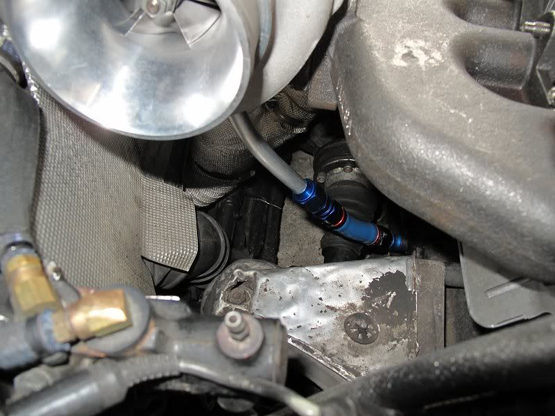

Kevin Bacon 5 Posted July 4, 2010 Yeah the rubber gets too hot, hardens, then splits. This stuff is ATP's high temp drain hose supposed to handle it, but it took about 6 months to go like this and start leaking! I had heat shielding over it aswell. As you rightly pointed out, hardline is the way to go :salute: This isn't a very good pic, but it's basically 10" of -10 hard line with sleeve nuts, then it's rubber the rest of the way. That's been perfect 8) Quote Share this post Link to post Share on other sites
coullstar 0 Posted July 4, 2010 Speedflow again was it for the hard line? Quote Share this post Link to post Share on other sites
vvxifeng16 0 Posted July 5, 2010 very good is this post Quote Share this post Link to post Share on other sites
Kevin Bacon 5 Posted July 5, 2010 coullstar said: Speedflow again was it for the hard line? Yep. Speak to Fay. She flared the pipe and fitted the sleeve nuts for me. Otherwise you have to buy an expensive flaring tool unless you've already got one! Quote Share this post Link to post Share on other sites
Kevin Bacon 5 Posted July 11, 2010 Surge tank and Bosch 044 installed. It went on easily and I'm chuffed with the build quality and low noise levels of the pump :D Normally they're noisy as hell, but submerged in fuel it's a lot quieter, just sounds like a MK1 / MK2 K jet pump that's tired. You can just hear it buzzing at idle and that's it. People with 3" exhausts might not hear it all :D 600hp capable fuelling ready to go :norty: Quote Share this post Link to post Share on other sites
