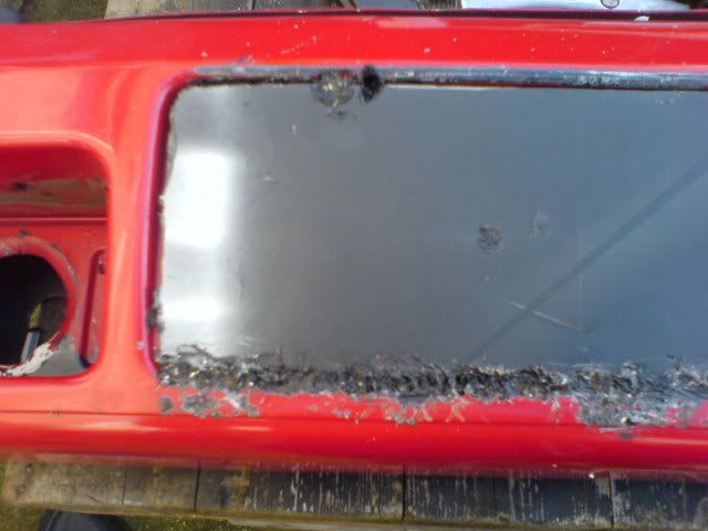

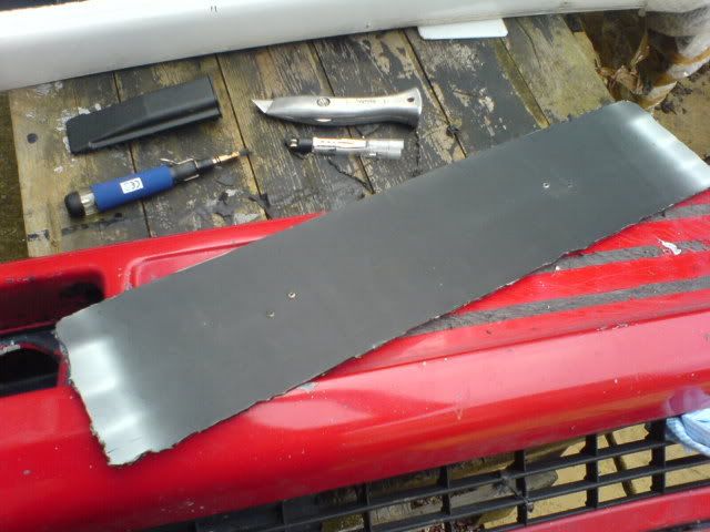

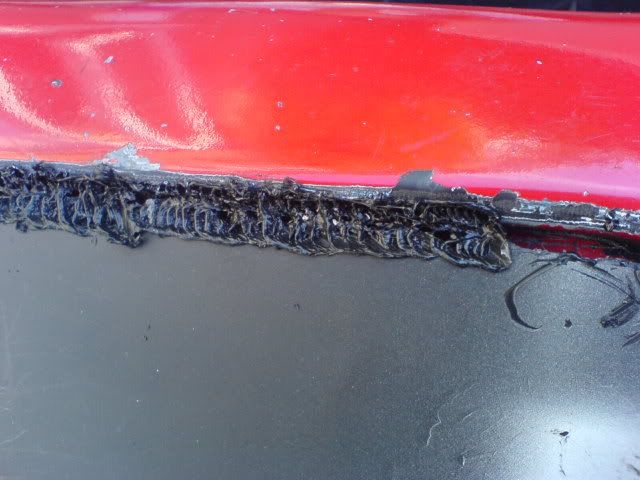

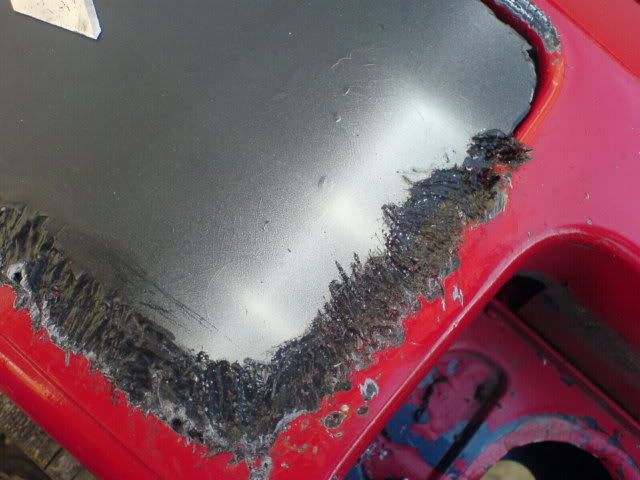

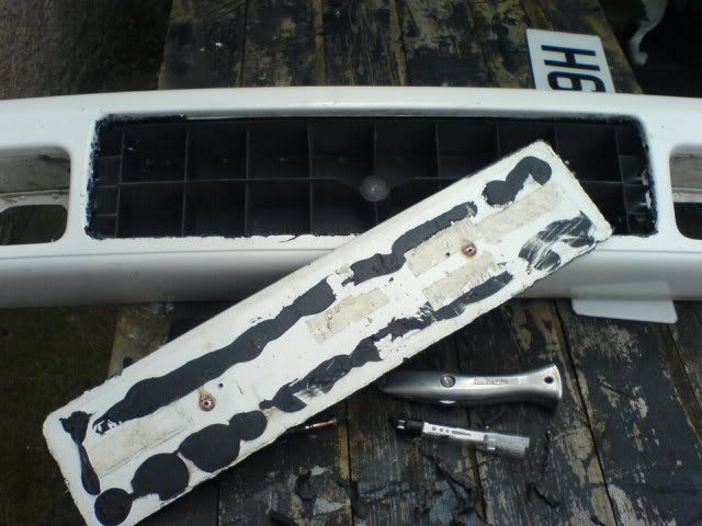

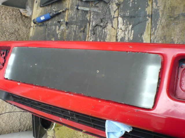

g60greeny 0 Posted July 15, 2007 no update on the job front,interview went well although brown nose number 2 has had a 2nd interview anyway car update for those who care :? well after havin a bad experience with a bodyshop,instead of plastic weldin me front bumper it was just filled :? anyway thats cracked,so after havin no joy tryin to find another bodyshop that would weld up the plate recess,i decided to have a blast myself :D so armed we my trusty knife,gas solderin iron i got stuck in (well its kinda plastic weldin ) :lol: pics so far donor bumper tryin for size let the weldin begin after the 1st stage of weldin i made some plastic weldin rods to secure the join :D only about halfway through it,but it feels really strong already,should be sound when i get to usin the special platic bumper filler i bought to finish it off 8) Quote Share this post Link to post Share on other sites

neil20vtc 0 Posted July 21, 2007 good work mucker hats off to ya for havin a go yourself, must take some time just usin a gas soldering iron though! Quote Share this post Link to post Share on other sites

mrbeige 0 Posted July 21, 2007 forgot job update never got it,brown nose number 2 got one an another drinkin buddy of the management team got the other,as suspected all along :( That's w@nk, sorry to hear that dude. It seems that it's not what you know, but whose cock you suck, these days, which is totally crap. On the other hand, your bumper work is looking gooooood :thumbleft: Want to do this myself.....another thing to add to the list :wink: What di you use as the welding stick? Some more plastic from the donor bumper? Quote Share this post Link to post Share on other sites
g60greeny 0 Posted July 21, 2007 yeah just some strips i cut off the donor bumper :D Quote Share this post Link to post Share on other sites
