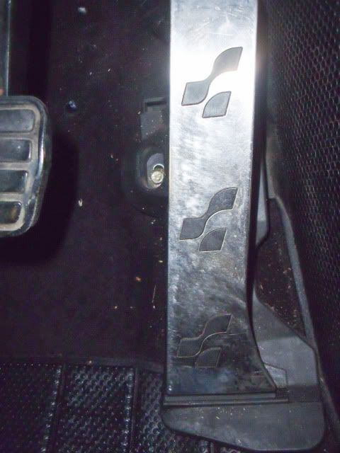

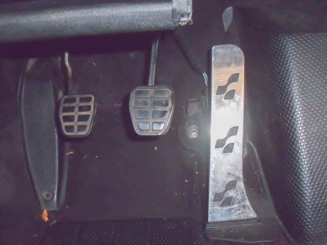

quicky1980 0 Posted July 22, 2012 yey great news! Air lock is possible, but are you sure the fuel lines are connected up correctly to the fpr? the vacuum line is only needed when driving as it allows more fuel to be supplied when you blip the throttle. What do you mean about the FPR not having a securing clip?? Here are the pictures of my pedal arrangement... Here is a video of mine first running without any silencers fitted. The ratteling it a loose coupling on the exhaust and the engine had a idle issue but you get the idea of how great the engine sounds even http://s144.photobucket.com/albums/r180/quicky1980/Corrado/?action=view¤t=DSCF4064-1.mp4 Quote Share this post Link to post Share on other sites
Swompy 0 Posted July 22, 2012 Need a password to view the video mate. I will get pics of my pedal later as mine is different to yours! Quote Share this post Link to post Share on other sites
Fanjita 1 Posted July 22, 2012 Seems to work fine for me mate? Thanks Sam love seeing the end result! Yeah pics would be ace please, good to see how everyone has achieved it. I know I will end up cutting the carpet but I'd rather sit it right before I get the knife out. Is yours a top hinged pedal? I also noticed that my mother has the same pedal in her skoda! It actually sits slanted in there, but looks like the rh trim in the corrado will get in the way... I guess we have to live with it being not quite oem? Quote Share this post Link to post Share on other sites

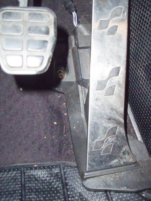

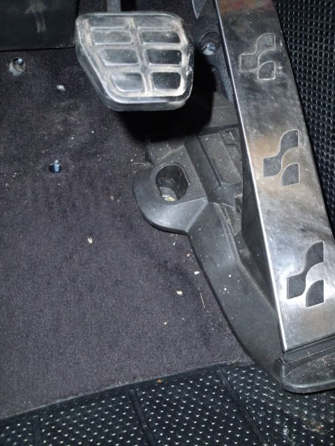

Swompy 0 Posted July 22, 2012 Nope cant view it says enter private album password! Here is how my pedal is installed [ATTACH=CONFIG]68413[/ATTACH] [ATTACH=CONFIG]68414[/ATTACH] [ATTACH=CONFIG]68415[/ATTACH] [ATTACH=CONFIG]68416[/ATTACH] Quote Share this post Link to post Share on other sites
VW_OwneR_85 2 Posted July 22, 2012 yep same here i cant view it, its set to private, think you have the same pedal as me swompy, the install is on my things to do list ;) Quote Share this post Link to post Share on other sites

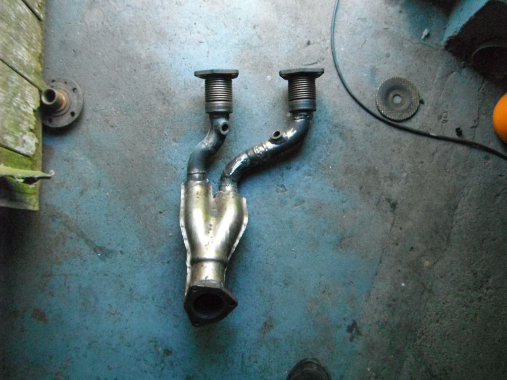

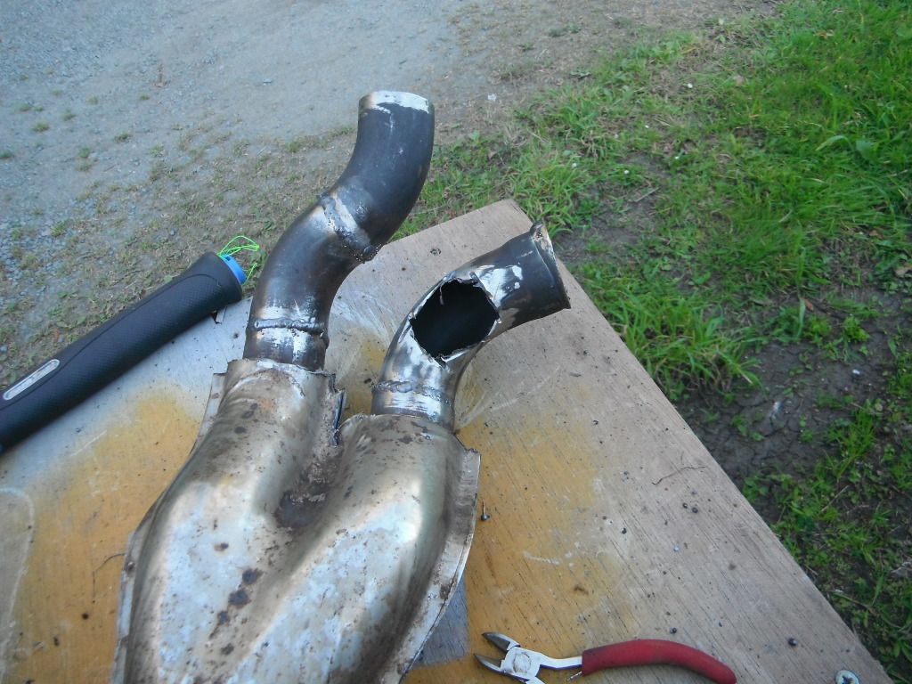

1990 0 Posted July 25, 2012 (edited) Heres a couple of pics of my Mk5 downpipes which I've cut before they join back together:, they flare out where the pieces join so they are easy to take apart and hopefully easy to put back together Edited July 30, 2012 by 1990 Quote Share this post Link to post Share on other sites
