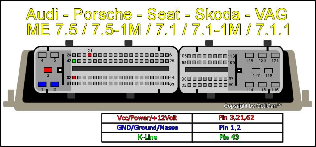

Sean_Jaymo 0 Posted April 30, 2013 I've got as far as getting the engine in and it cranks but refuses to fire. Scanned with vagcom and got this; 11 Faults Found: 18057 - Powertrain Data Bus P1649 - 35-00 - Missing Message from ABS Controller 17645 - Fuel Injector for Cylinder 1 (N30) P1237 - 35-00 - Open Circuit 17649 - Fuel Injector for Cylinder 5 (N83) P1241 - 35-00 - Open Circuit 17647 - Fuel Injector for Cylinder 3 (N32) P1239 - 35-00 - Open Circuit 17650 - Fuel Injector for Cylinder 6 (N84) P1242 - 35-00 - Open Circuit 17938 - Camshaft Timing Adjustment P1530 - 35-00 - Short to Ground 17648 - Fuel Injector for Cylinder 4 (N33) P1240 - 35-00 - Open Circuit 17923 - Intake Manifold Valve (N156) P1515 - 35-00 - Short to Ground 17646 - Fuel Injector for Cylinder 2 (N31) P1238 - 35-00 - Open Circuit 17530 - Oxygen (Lambda) Sensor Heating; B2 S2 P1122 - 35-00 - Open Circuit 17526 - Oxygen (Lambda) Sensor Heating; B1 S2 P1118 - 35-00 - Open Circuit The lambda's weren't plugged in so not concerned too much about that. Is there a common earth in amongst that lot that i've simply missed? It's been wired up IAW the clubgti wiring guide. Is it the fuel pump relay giving me grief? I can physically feel it clunk over and latch on? I've not hacked into the engine loom itself so I would be surprised if it simply a plug i've missed? Quote Share this post Link to post Share on other sites
Sean_Jaymo 0 Posted April 30, 2013 Further to this, I'm not getting the smell of fuel at all, plugs are dry, but I disconnected the fuel feed and it flows out when the engine is cranking. Quote Share this post Link to post Share on other sites
Fanjita 1 Posted April 30, 2013 What engine? There won't be any fuel going through if the ecu cant control the injectors! What wiring guide is this? There are a few common earths, one on the engine and 3 by the battery iirc. Quote Share this post Link to post Share on other sites
VW_OwneR_85 2 Posted April 30, 2013 this pic saved my butt when doing my 2.8 BDE , pin 62 had no power , Quote Share this post Link to post Share on other sites
Sean_Jaymo 0 Posted April 30, 2013 Aye I knew that the injectors weren't working, I was just confirming that the injectors were stuck shut opposed to being stuck open. http://www.clubgti.com/showthread.php?205887-OEM-management-wiring-1-8T-gt-Mk2-harness-install-FAQ - It's for 1.8t lumps but they share the same ecu so you can take advise from that post when you are looking through wiring diagrams. Thanks for that picture but I have power through pin 62, I haven't seen anything about pin 21 before though! At least I do not remember seeing anything about it! ---------- Post added at 10:38 PM ---------- Previous post was at 10:35 PM ---------- Oh and it's AUE, my bad! ---------- Post added at 10:45 PM ---------- Previous post was at 10:38 PM ---------- Having a very quick look through my AUE wiring diagrams shows no mention of T121/21 Quote Share this post Link to post Share on other sites
VW_OwneR_85 2 Posted April 30, 2013 interesting maybe power pin 21 up and see if it makes a difference? Quote Share this post Link to post Share on other sites
Sean_Jaymo 0 Posted April 30, 2013 I'll look and see tomorrow if there is physically a wire to pin 21, there is either a wire and I have actually done something with it or its not there at all as I don't have any spare wires. It's odd! Quote Share this post Link to post Share on other sites
VW_OwneR_85 2 Posted April 30, 2013 (edited) tbh dude it could of been pin 21 that skrewed me cant quite remember 100% if it was 62 or 21 , i know before that i couldnt get fuel and i couldnt scan the ecu either! but you can scan the ecu right?, when i powerd it up the throttle body started buzzing and it started up straight away!! oh where is the engine number located? cant seem to find the blady thing, edit: just looked through my old emails regarding the wireing and it was pin 21 that gave me the problems, {black wire } apparently none of the BDE wireing diagrams shown anything for this which is why the guy didnt do anything with it, so lucky i found that pic or i would of been in a wireing nightmare all by myself. Edited April 30, 2013 by VW_OwneR_85 Quote Share this post Link to post Share on other sites
