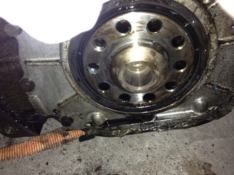

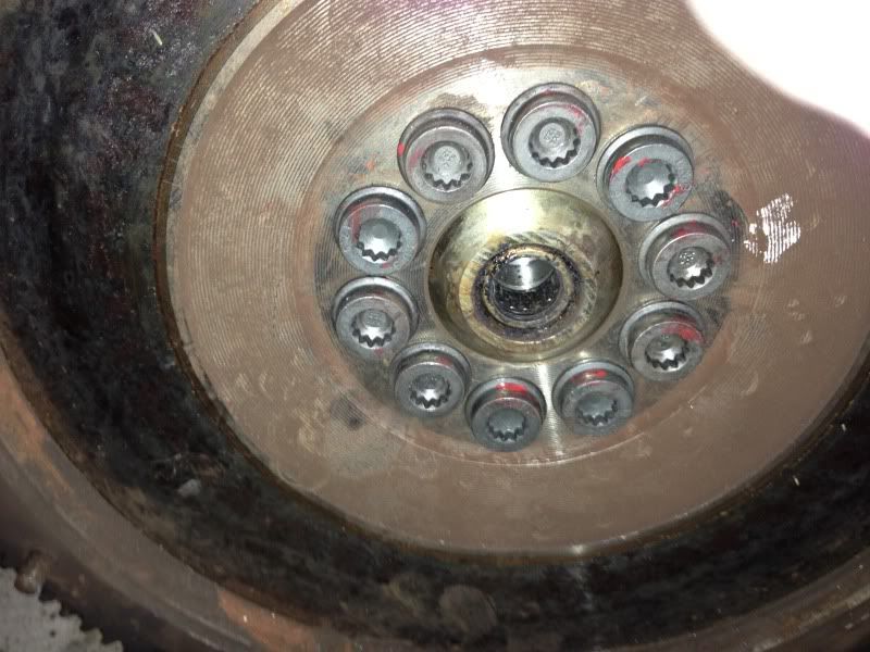

borachris 0 Posted August 24, 2013 Ok so a bit more progress today, couple of things I'm unsure on Pic below shows the VR flywheel on the 3.2, there appears to be a bearing in the centre, which I assume the shaft on the 6 speed box fits into? With the VR box the shaft won't fit into this bearing as the shaft is bigger, VR crank pic below for comparison, no bearing fitted like the 3.2 crank Everything seems to have gone together ok so I assume I'm worrying about nothing? Also should there be a plate between the box and block, I have a hole into the bell housing? Quote Share this post Link to post Share on other sites
