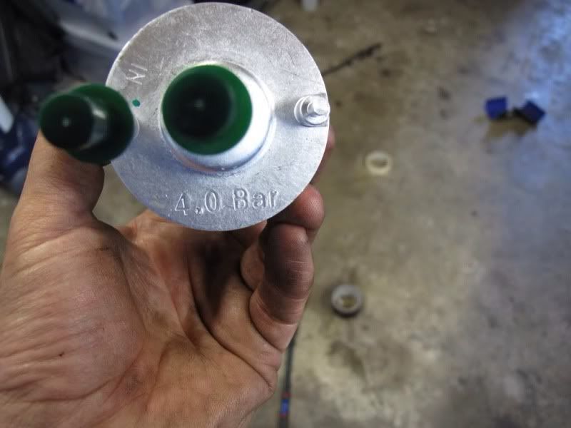

Well it's been pointed out to me that I'm using the wrong one for the feed and return
As can be seen here in another one of kev's pics the one I was using as a return is clearly stamped 'in'
:epicfail:
:epicfail:

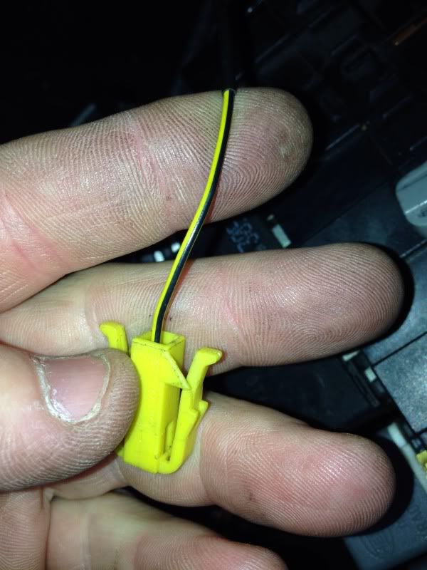

Is it bad forum etiquette to ask another question without waiting for an answer to a previous question?
If it is then forget the previous questions and somebody please tell me where the hell this little fella goes?
It's in the loom coming from the engine bay along with G1 G2 etc
I think that yellow plug is attached to main beam, it can be plugged into the alarm etc to make the lights flash.
