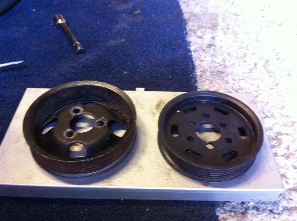

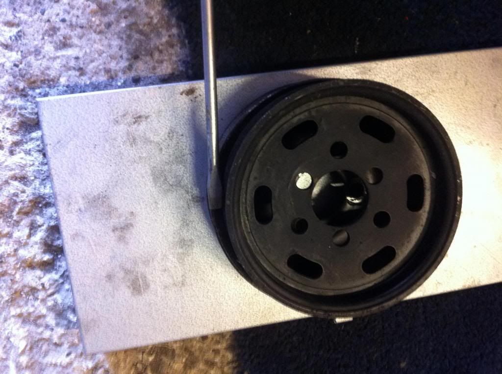

swiftkid 1 Posted May 23, 2014 Having a bit of a problem with the belt size, I ordered a 6pk1624 as specified in this thread which I believe it a 4motion non air con belt and it's quite a fair bit too long, I've swapped the power steering pump over to the 4motion one and seems like the original corrado belt size is the right length. Anyone experienced this? Quote Share this post Link to post Share on other sites
perksy 11 Posted May 23, 2014 Swift kid did you change the power steering pulley wheels over so the vr power steering pump has the 24v wheel on? Quote Share this post Link to post Share on other sites
swiftkid 1 Posted May 23, 2014 I swapped the whole vr power steering pump with the 4motion pump. I had it so. Thought I might as well swap it, the pulley was slightly smaller though, have I been sent the wrong one? Quote Share this post Link to post Share on other sites
Kevin Bacon 5 Posted May 23, 2014 VR6 PAS pump + 4 motion 6 rib pulley + 4 motion belt = no problems for me :) I wish he had decided that before he agreed to do mine, would have saved me months of hassle and a few hundred quid, **** poor customer service! Only doing looms onsite now smacks of customer distrust, but, ME7 looms can be a royal pain in the rump, so I can understand it to a degree. However, given he asks what car the loom is going into, it should be supplied fit for purpose. Stealth did my loom and sent it to me in the post and it all went in perfectly with no problems. I have to say, Vince is an amazing guy with not only this stuff but also after sales support. Once you get to know him, he really does go above and beyond compared to other tuners. Quote Share this post Link to post Share on other sites
perksy 11 Posted May 23, 2014 I swapped the whole vr power steering pump with the 4motion pump. I had it so. Thought I might as well swap it, the pulley was slightly smaller though, have I been sent the wrong one? mine is same as kevs and i didnt have any problems what does the top tensioner look like and pics of the wheels below left vr right 24v size difference , its hard to see but the vr 1 is under it sorry for poor pic Quote Share this post Link to post Share on other sites

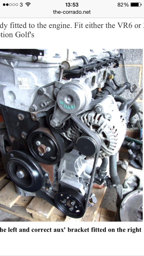

swiftkid 1 Posted May 27, 2014 Cheers perksy, that all looks right. I'll have to double check I'm routing the belt right, its not just a little bit long... its quite a bit longer. Not sure if the Audi engines have done something weird. But just to clarify I've got a 4motion power steering pump and pulley, 4motion belt tensioner & alternator mounting bracket and the rest is Audi 3.2 stuff. I've got a quick question to those doing wiring themselves, I had originally thought that T121/17 & T121/50 was the blue temp sensor (warm up map sensor) but found that its actually radiator outlet coolant temp sensor G83, what has everyone done with these wires? Quote Share this post Link to post Share on other sites
Kevin Bacon 5 Posted May 27, 2014 What have people done about the PCV Valve, I've got an AUE code engine with the PCV outlet on the left side (looking from the front), I havent got the original PCV valve, At the moment it is feeding into the intake after the MAF but before the throttle body, From what I've read, the following may or may not be true The VR6 24v has a (sophisticated) built in baffle system already in the rocker cover and doesn't need the crap OEM PCV valve, You don't want oil vapour in your engine, can cause air/fuel mixture to be more volatile, Oil residue in intake is normal on engines, it's called "blow by" Vr6 PCV Valve is to stop the pressurising of the crankcase when intake pressure rises at high RPM, PCV valve stops an intake backfire igniting crankcase gasses Catch can is the best solution, So what solutions do people employ cheers Steve You mean you haven't got the round disc shaped thing on the intake pipe? It's the MK5 that has the sophisticated breather and is called "Cyclone" IIRC. The MK4 3.2 / 2.8 just has a normal wire-in-a-box separator. I would just go by how oily your throttle blade gets. Mine takes months to get even vaguely dirty, so it does a good job of keeping oil out. Quote Share this post Link to post Share on other sites
borachris 0 Posted May 27, 2014 Cheers perksy, that all looks right. I'll have to double check I'm routing the belt right, its not just a little bit long... its quite a bit longer. Not sure if the Audi engines have done something weird. But just to clarify I've got a 4motion power steering pump and pulley, 4motion belt tensioner & alternator mounting bracket and the rest is Audi 3.2 stuff. This is the picture I used to check mine was correct, from Sams guide. I'm using the same parts as you. Quote Share this post Link to post Share on other sites
