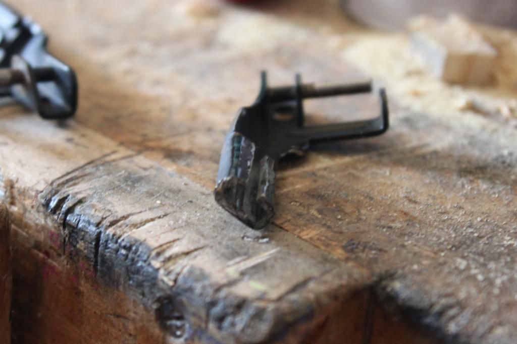

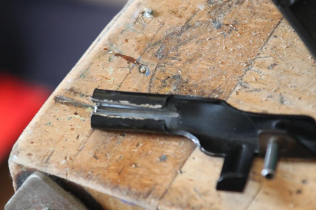

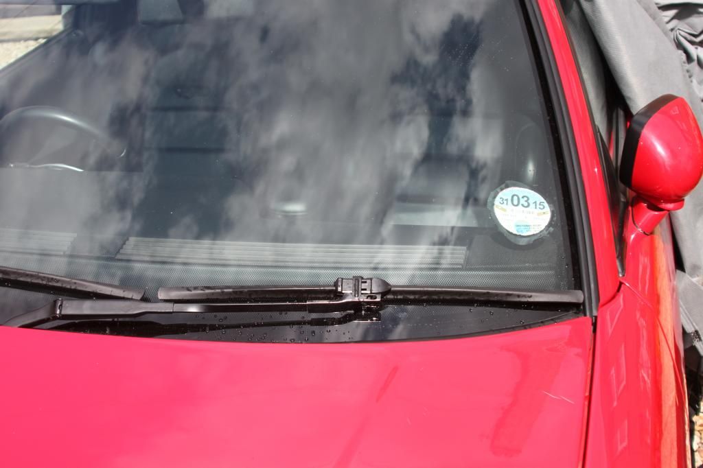

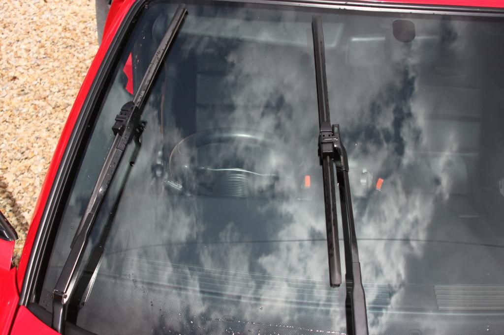

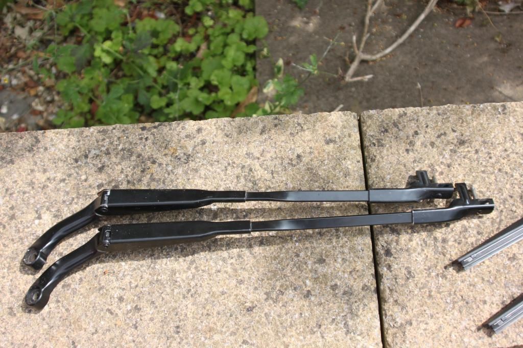

VR6 Gar 10 Posted June 18, 2014 Spotted a full set of TT aero arms and blades on ebay a few days ago for £48 delivered so snapped them up. I already knew that the passenger side arm would be too long but had plans on how to get round this. I also didn't want to have to cut the blades to make them fit, due to them hitting in the middle, like you do when using 2 Drivers side arms, so here is what I did when they arrived today. First off was separating the head of the arm from the main shaft. This was not an easy task and i would not recommend it unless you have a work bench with vice. To do this I used angle grinder with a thin disc and cut a slit straight through the arm shaft where it goes into the head. I then, after lots of failed attempts to wiggle and bang it apart, cut through the arm at the point where it would need to be cut anyway when putting back together. The remaining bit of arm was then cut length ways into 2 halves. Each part could then be held in the vice on its own whilst a large screw driver and lump hammer were used to smash the head to remove the thin bit of remaining arm. Repeat for the second remaining piece. Hope that makes sense. The head was a bit scarred after all that hammering and cutting, but nothing a little filling didn't sort. Could do with giving it a lick of paint but it really doesn't look too bad. After getting the inside all tidied up with a needle file the head was ready to slot back on to the arm. This was easier than expected and only took a few taps to get it into position. I then wrapped it in a cloth for protection and clamped it back up using my metal vice after checking its length was correct and fitted the car properly. As you can see the passenger arm is slightly longer than the drivers arm, making it the perfect length and not a compromise. If buying new it would be far easier and less hassle to just buy 2 drivers side arms. However if a complete set comes up like they did for me then it is possible to make them fit even better than the 2 D/S method. The blades after a quick rub of vinegar are in great condition and do an amazing job of cleaning the screen. There is so much pressure on them that on a dry screen they wont get back to the reset position. Quote Share this post Link to post Share on other sites

Simeon 0 Posted February 15, 2017 Spotted a full set of TT aero arms and blades on ebay a few days ago for £48 delivered so snapped them up. I already knew that the passenger side arm would be too long but had plans on how to get round this. I also didn't want to have to cut the blades to make them fit, due to them hitting in the middle, like you do when using 2 Drivers side arms, so here is what I did when they arrived today.... Thanks for the write up :) I've just bought a set of TT wipers for £25 delivered off ebay and was thinking of chopping a piece out of the arm and welding back together, but your solution is even neater. Quote Share this post Link to post Share on other sites
