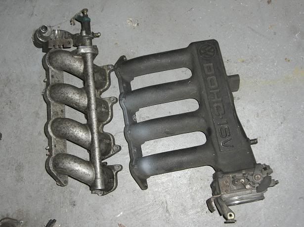

Traverse 0 Posted June 6, 2008 I'm looking to do a 16v G60 and I'm looking at an intake manifold, but the throttle body doesn't look like it's in the right place... Pic for reference: Is that going to be a problem, or is it fine? Quote Share this post Link to post Share on other sites
dirtytorque 0 Posted June 10, 2008 Traverse said: I'm looking to do a 16v G60 and I'm looking at an intake manifold, but the throttle body doesn't look like it's in the right place... Pic for reference: Is that going to be a problem, or is it fine? i've seen people run without the throttle body elbow on vortex so it can be done. Not sure what mods or limitations it places on you though tbh.. Quote Share this post Link to post Share on other sites
Yandards 0 Posted June 11, 2008 dirtytorque said: Traverse said: I'm looking to do a 16v G60 and I'm looking at an intake manifold, but the throttle body doesn't look like it's in the right place... Pic for reference: Is that going to be a problem, or is it fine? i've seen people run without the throttle body elbow on vortex so it can be done. Not sure what mods or limitations it places on you though tbh.. You can get the elbow as a one piece part from BBM for not a lot of dollars. Quote Share this post Link to post Share on other sites
boost monkey 0 Posted June 11, 2008 That's the Scirocco 16v manifold, my american friend :salute: Quote Share this post Link to post Share on other sites
dirtytorque 0 Posted June 11, 2008 boost monkey said: That's the Scirocco 16v manifold, my american friend :salute: yeah they are ideal for the 16vg60 installs in terms of boost piping. I have one too. I also have an elbow from the original limite g6016v0 which came with it. I got lucky. Quote Share this post Link to post Share on other sites
boost monkey 0 Posted June 11, 2008 Not so ideal with the long runners though :pale: short intakes on f/i ftw. Quote Share this post Link to post Share on other sites
dirtytorque 0 Posted June 11, 2008 yeah but i choose form other function in this instance. :) Quote Share this post Link to post Share on other sites
